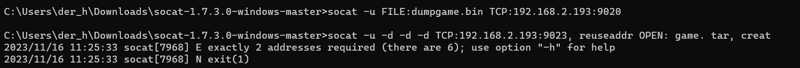

what am I doing wrong? :/
the first command works, the payload went through. But something is wrong with the second command
EDIT: Ignore my post. I had a wrong format
This is the right format without empty spaces
socat -u -d -d -d TCP:<PS5IP>:9023,reuseaddr OPEN:ra.tar,creat

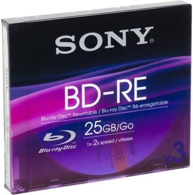

Yes, as for me, BD-JB is/was 100% stable. I tried it many times, never had a single crash.
Just follow this guide:
Of course you need Blu-Ray burner and one BD-RE disc. I'm using this one:
https://github.com/hammer-83/ps5-jar-loader
This project uses vulnerabilities discovered in BD-J layer of PS5 firmware version 7.61 and earlier to deploy a loader that is able to listen to JAR files and execute their main class. This makes it easy to burn the BD-R disc with the loader just once and then keep on running new versions of the experimental code. This repository provides all the necessary setup needed to create both the loader BD-R disc filesystem and the JAR to send to the PS5.
You can use any Blu-Ray disc with a movie (that has a menu) - you don't need to burn your disc.
So why burn your Blu-Ray disc?
It's mainly to affect the operation of the disc player in the console - how "hard" it will work. When you burn such a disc yourself, there will only be a bootable image on it and nothing else. The drive in the console will simply work shorter. It will read the contents, display the text (I don't remember anymore, I think "Hello world") and that's it.
When you put a movie disc in the drive, the disc player in the console will work harder because it simply has a lot more information to process/read.
