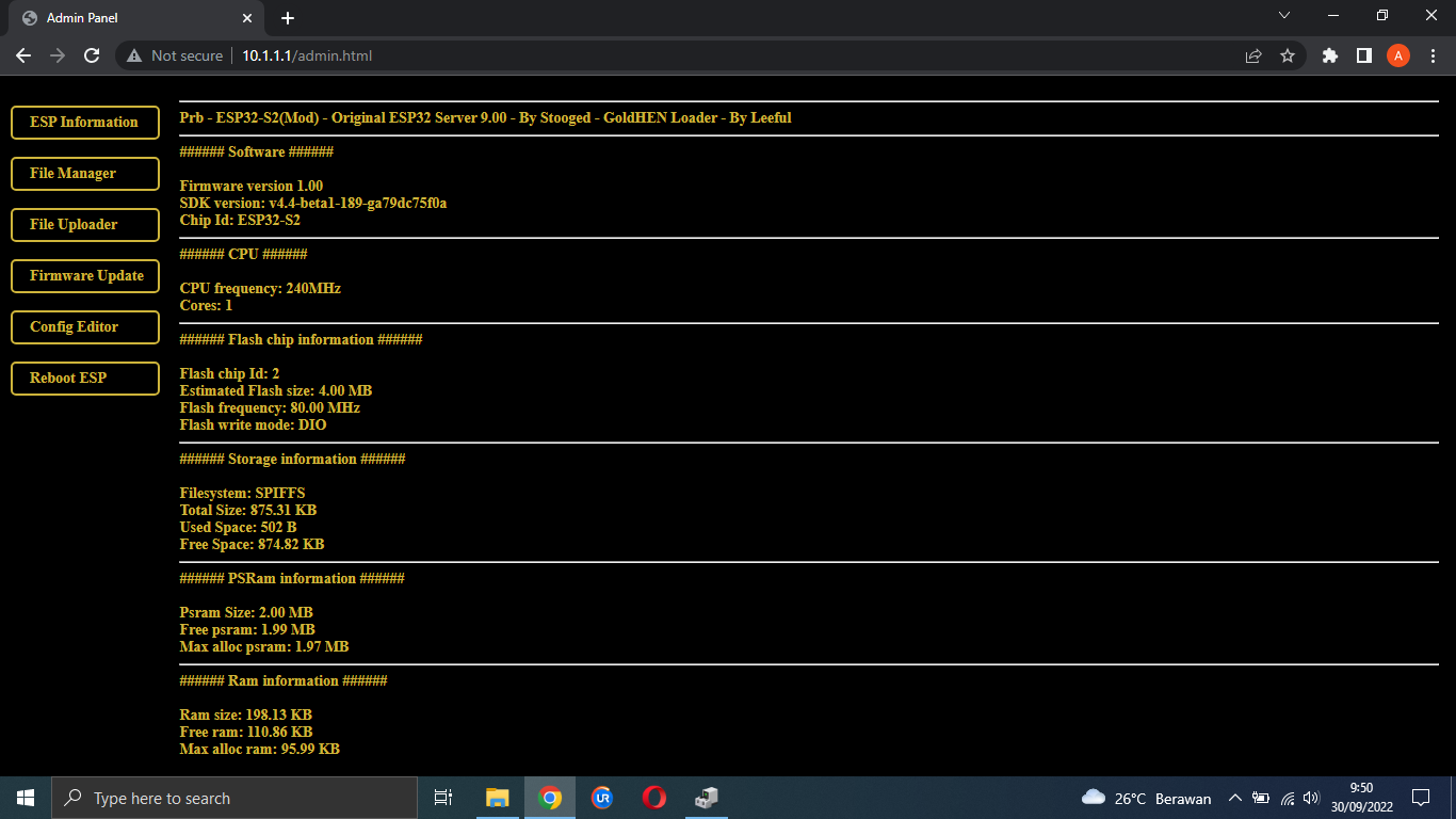

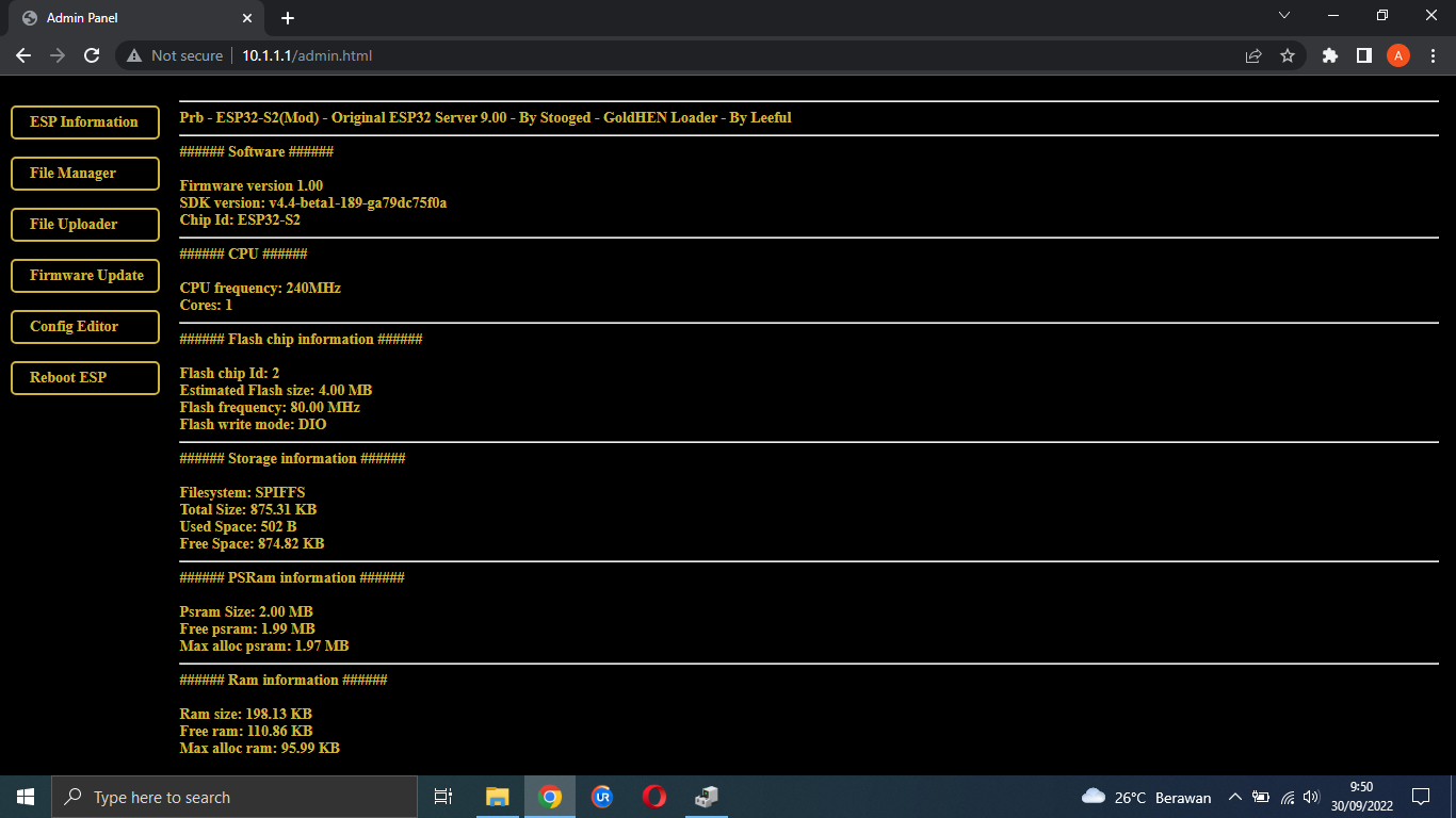

Recommended Host Menu:
Thread: HERE
Thread: HERE
(Remember: 9.00 will always require a USB dongle, this cannot be bypassed!)

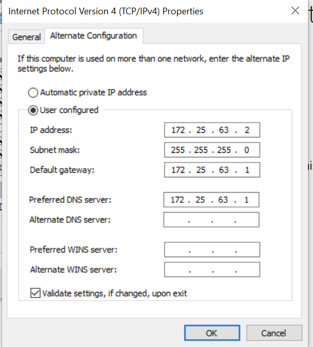

Set IP as AUTOMATIC.
Set DHCP as DO NOT SPECIFY.
Do not use Proxy Server.
HFS Host With Instructions
PS4 Serve3 LATEST (Stooged)
PS4 Tool 1.20 - Reazer
  • Connect PS4 to hot spot.

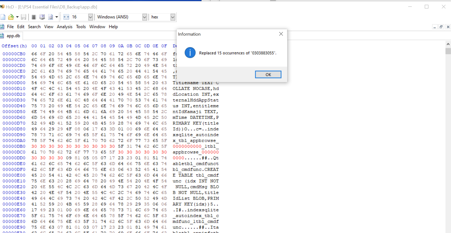

RESTORE FPKGs IN DB RESTORE:
Files needed:

I just flashing my esp32s2 mini with your newest exploit chain bin file , I see something strange here
My storage usage only 500B , is this correct or did I doing something wrong here ???
Flashing it twice with nodeMCU with difference baud rate , still same result
Should I upload goldhen payload here ???
No the storage space is correct I use a bigger app size unfortunately you will not be able to upload any payloads with the file manager
Reactions: nubie and godreborn
I see in your twitter post before that your storage usage are much higher , so that why I thought there something difference here

I'm busy atm testing something very interesting can't say what it is 🤫
so can't do anymore esp bin for now
But it's probably just the usb wait time you can try changing the wait time iv'e got 2 9.00 ps4's one pro and one fat the pro will fail if the wait time is set below 7 seconds but the fat works down to 2.5 seconds
This is why I say the standard insert usb method works better as an all round method 🙂
