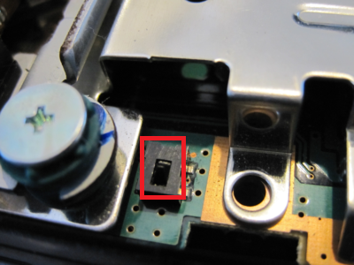

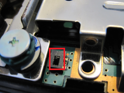

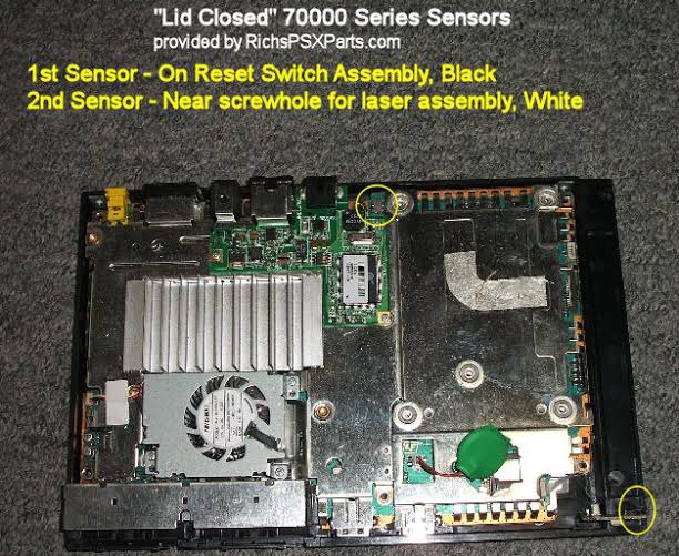

There are two sensors you need to press down in order for the disc to spin if your system is disassembled, the upper one is located on the top left to laser assembly, you need to use a flathead screwdriver to press on it, using your finger might result in an electric shock.
The 2nd one is on the power button, just use your hand to power the system and to hold that sensor button. (Blurry) Images below.
This is the one on top.
