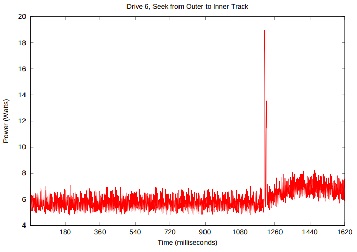

And this thread (including Graphical illustration of power consumption)
https://superuser.com/questions/117...of-2-5-laptop-external-hard-drive-connected-t
They measure the average power consuption with a multimeter. We want to know the peaks through. Also they say spinup is the highest peak but real live examples show otherwise. Just search GBATemp for how often drives spin up just fine but then produce random errors untill a better power source gets added.
These are the peaks I'm talking about:
(Source: Anthony Hylick, Ripduman Sohan, Andrew Rice, and Brian Jones University of Cambridge, Computer Laboratory)
