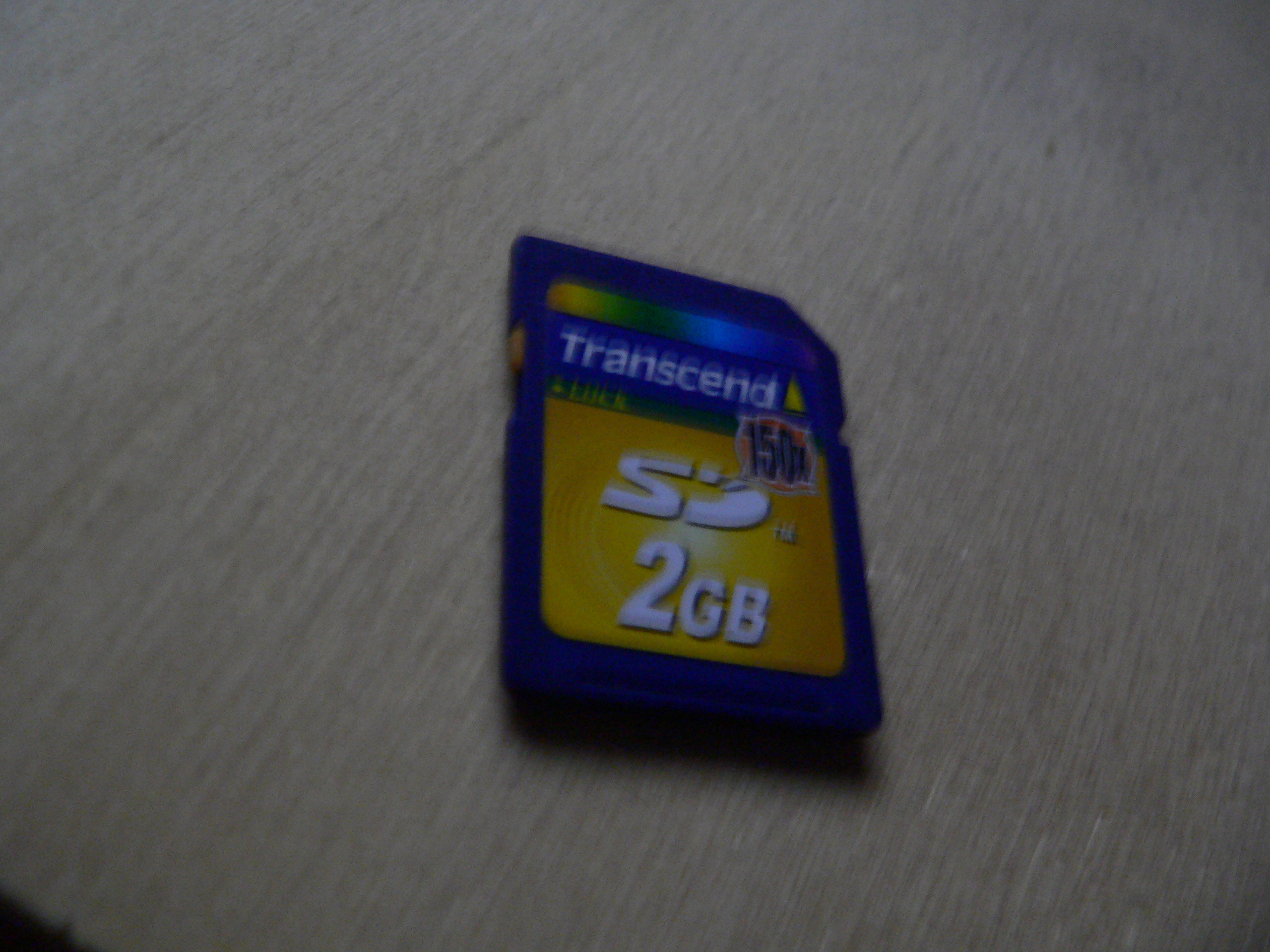

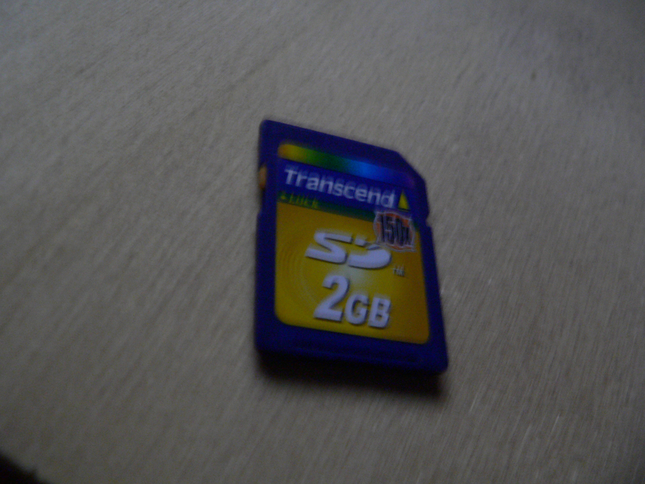

Can you maybe try another,smaller and regular SD Card (non Adapter and around 4 - 16 GB in Size/FAT32 formatted) please ?
Thank you.:)
