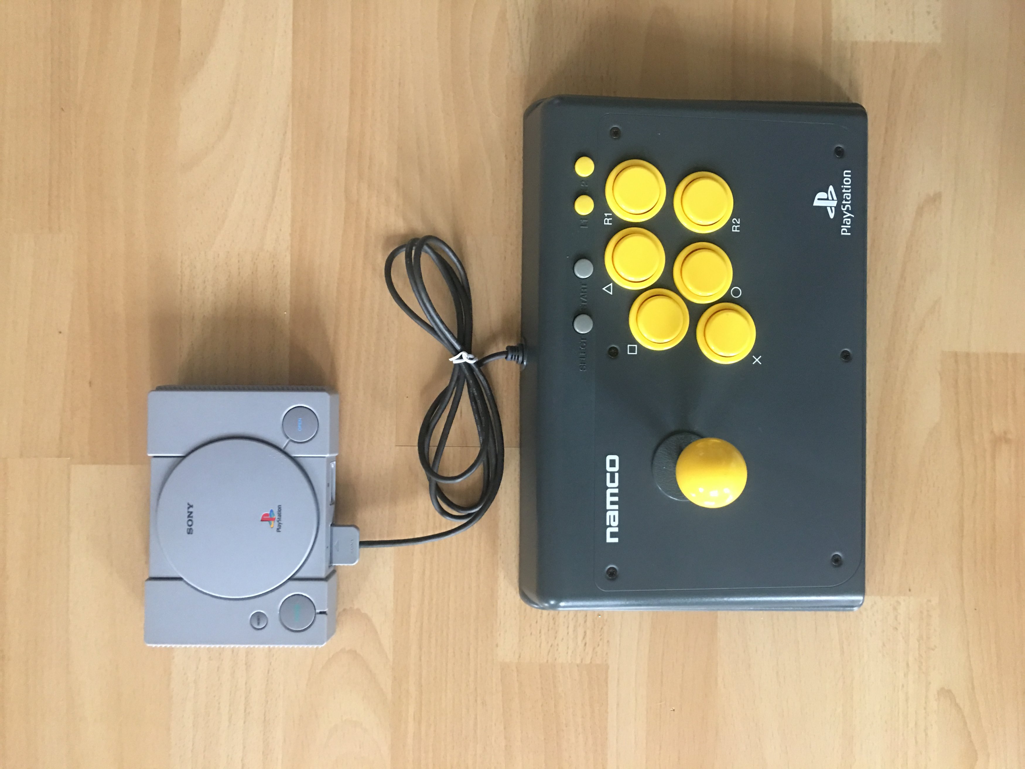

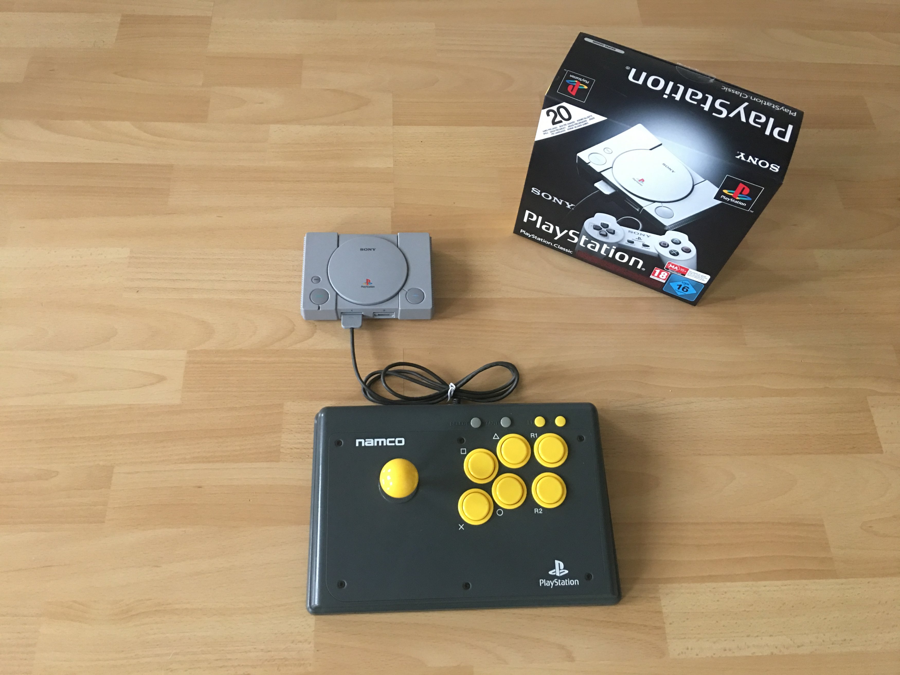

Hey There, i wanted to Show off my newest Hardware Mod. its a Namco Arcade Stick for the Playstation Classic! And yes it works on the main UI (Stock) and on RetroArch ;-). Maybe someone else have a cool Mod that he likes to Show?
