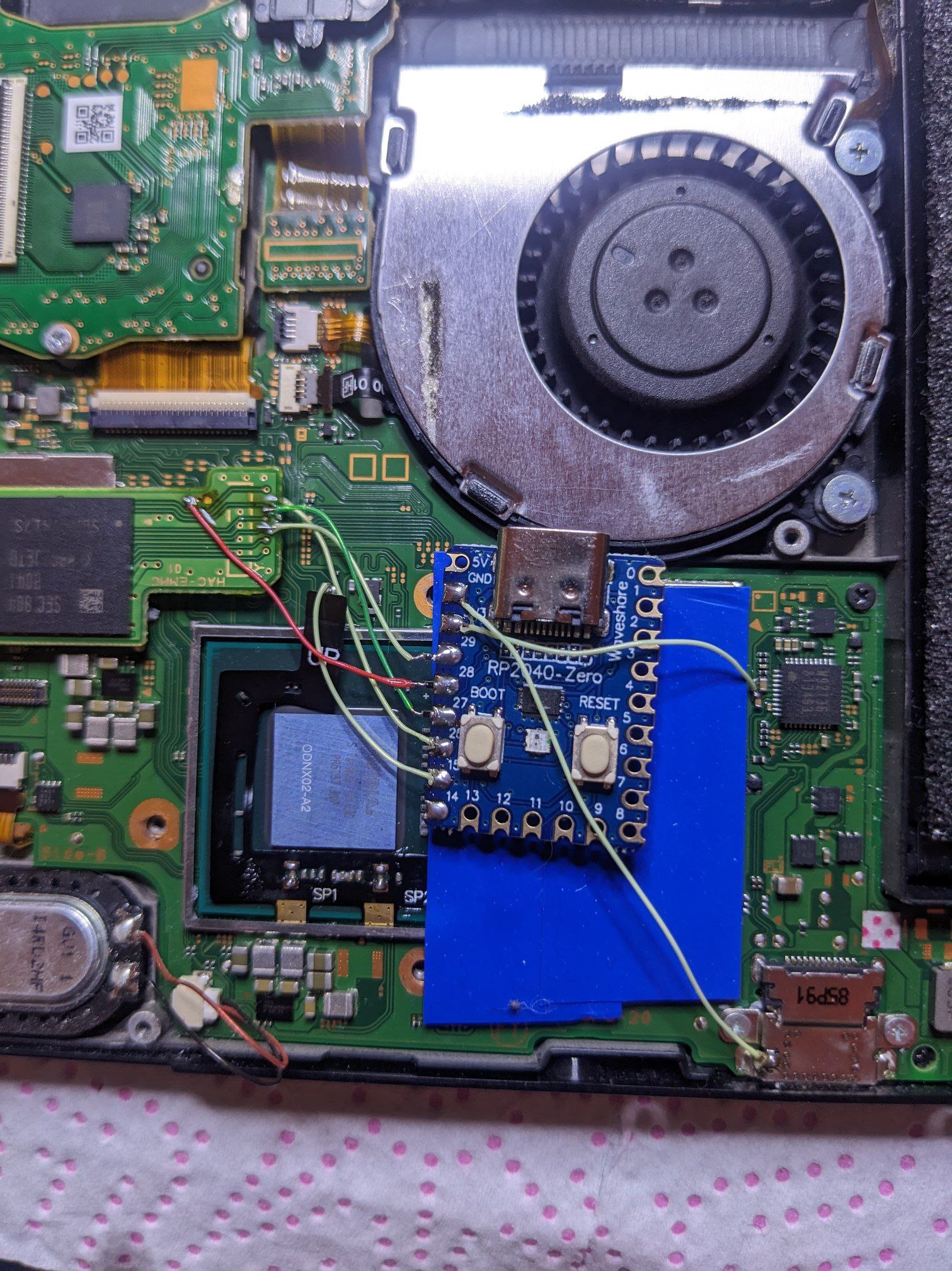

Tried to install 2040 on several of my switches, but everything comes down to a yellow LED blinking after attempting a glitch. I tried on v1, v2, OLED. All consoles except one have Samsung memory, while the other has Toshiba memory. If you short two LED pins at the back, the end will light up green instead of orange. I tried two different 2040s and flashed the firmware with Ubuntu after flash nuke, but the result is always the same.

I'm wondering, what's the actual payload/sdloader the unbuntu firmware is injecting. Again it seems to me it's doing what sx did and that's clearing the keyslots after the glitch happens preventing us from booting hos.
Is it possible just to change out the payload it's injecting to standard hekate would even be feasible
It was originally stated this won't work on v1 units

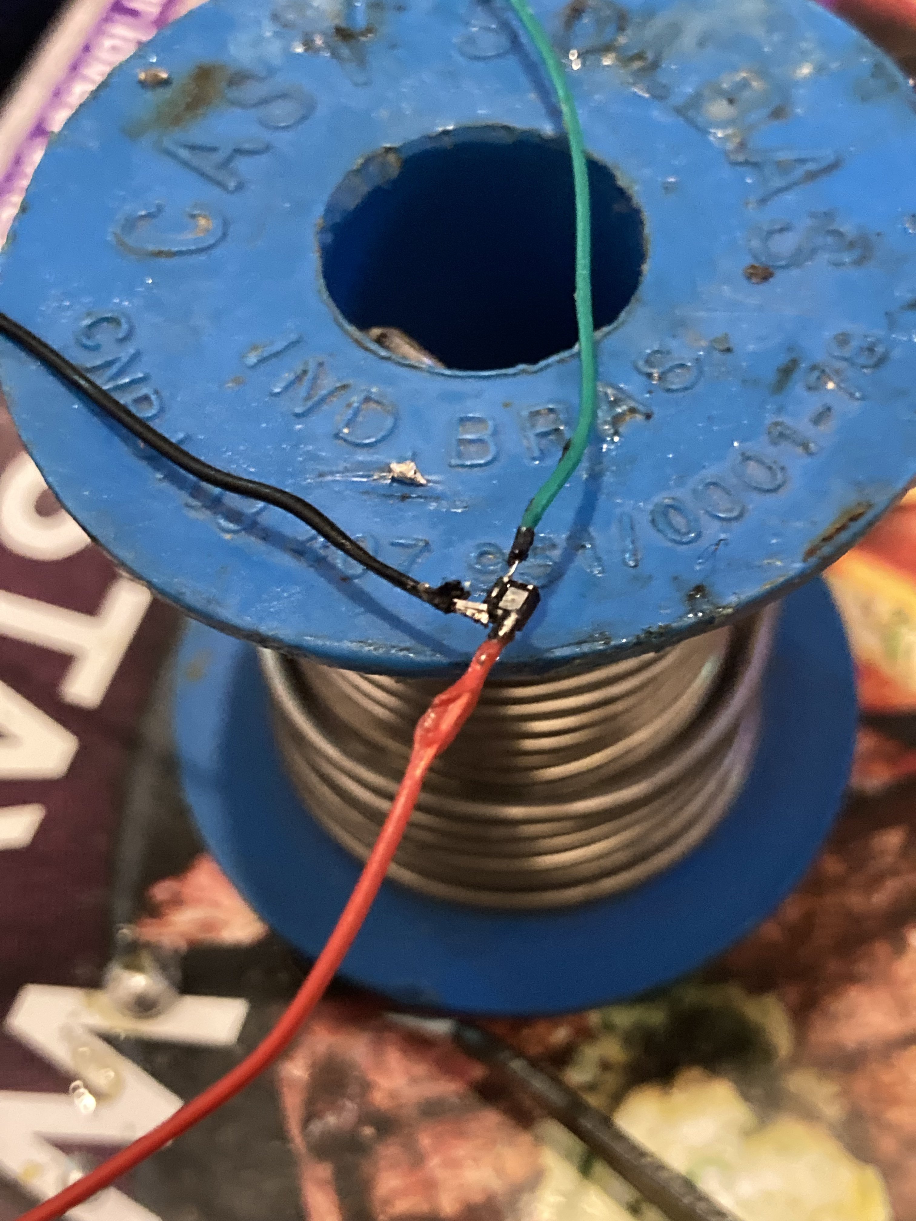

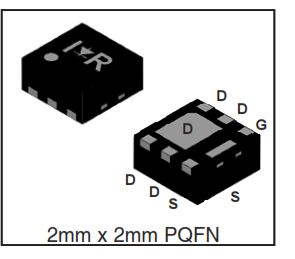

That mariko diagram is not correct
Oh, what’s specifically incorrect?
Mosfet goes from (S)ource to (D)rain and is controlled by the (G)ate, no? Pico controls the (G)ate.
lenoa
Feb 8, 2023
40
32
195
Iceland
so in short G to pico then, got it
let me try this,
wish me luck not gonna break my lite lol solder this fukin mosfet is the harder one lol
I’m just a layman that tries to read as much as I can in order to get my feeble mind wrapped around things and when corrected so matter of factly I like to understand why before I tear down the mental construct I built in my head. (G)ate being controlled by the Pico was what I thought it was supposed to be.
sauce: https://www.electronics-tutorials.ws/transistor/tran_6.html
