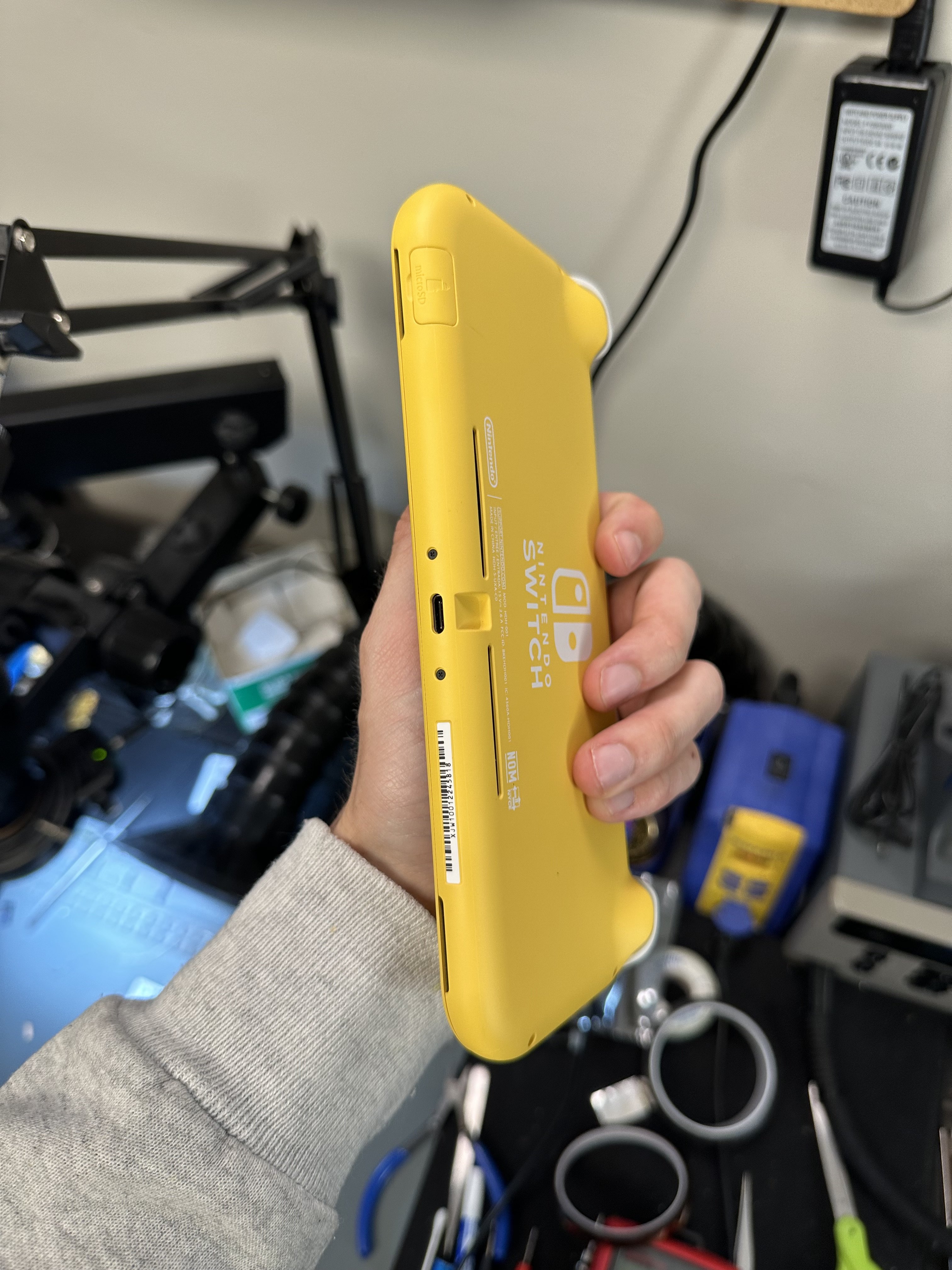

And with that, my switch lite install is complete! Took far too long, and this was before I swapped out the CPU wires with something a little bit thicker, but it looks effectively the same as these photos. Can't even tell it's inside :)
Only slightly concerned... did you completely remove the APU shield and not reapply it before closing back up? I only ask due to the placement of your mosfets ON the shield frame.
I've never attempted to put the heatpipe directly onto the APU, so I'm not sure whether or not this presents an issue, but hope it all works out for you!
I cut the shield, removed the half that sits on top of the memory. It's not cooling it anyways, so it's basically useless. I could have fit the picofly on top of the shield in the same spot, but this allowed it to be slightly lower, so everything fits a bit better
