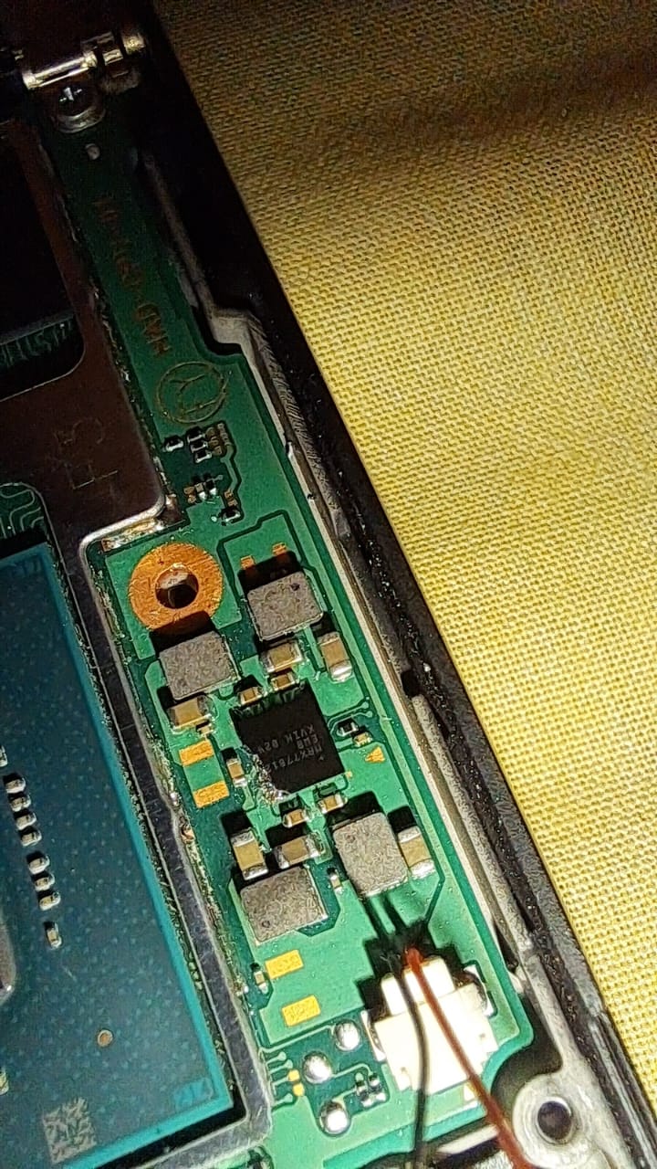

Seriously, has anyone ever rebal/replace this IC, can i done it using hot air, also any advise on solder ball size?, as this is the first time i will do any bga reball.

How did you know?

How did you know?
Just buy another one that's pre-balled.
If you can't though - Find a stencil and get some leaded solder paste, should have a melting temp of ~183c. Clean all of the solder off of the pcb and the component. Place the stencil on the component, add some solder paste and spread it around. Use a tiny squeegee/metal scraper/xacto knife to scrape off all of the extra. Then use hot air on a low air speed like 10, and a temperature of 250-300c. Heat the whole chip, moving the hot air around in a circle, for about 5 seconds, then hold the hot air in one corner. Once the balls start to melt, slowly move over the whole chip. Once melted, remove the hot air and keep holding the stencil there for another 20-30 seconds. From there you should be able to remove the component from the stencil, and then install it on the pcb :)
I haven't done that exact component, but I've done a lot of bga work on graphics cards, and that's almost exactly what I do.
