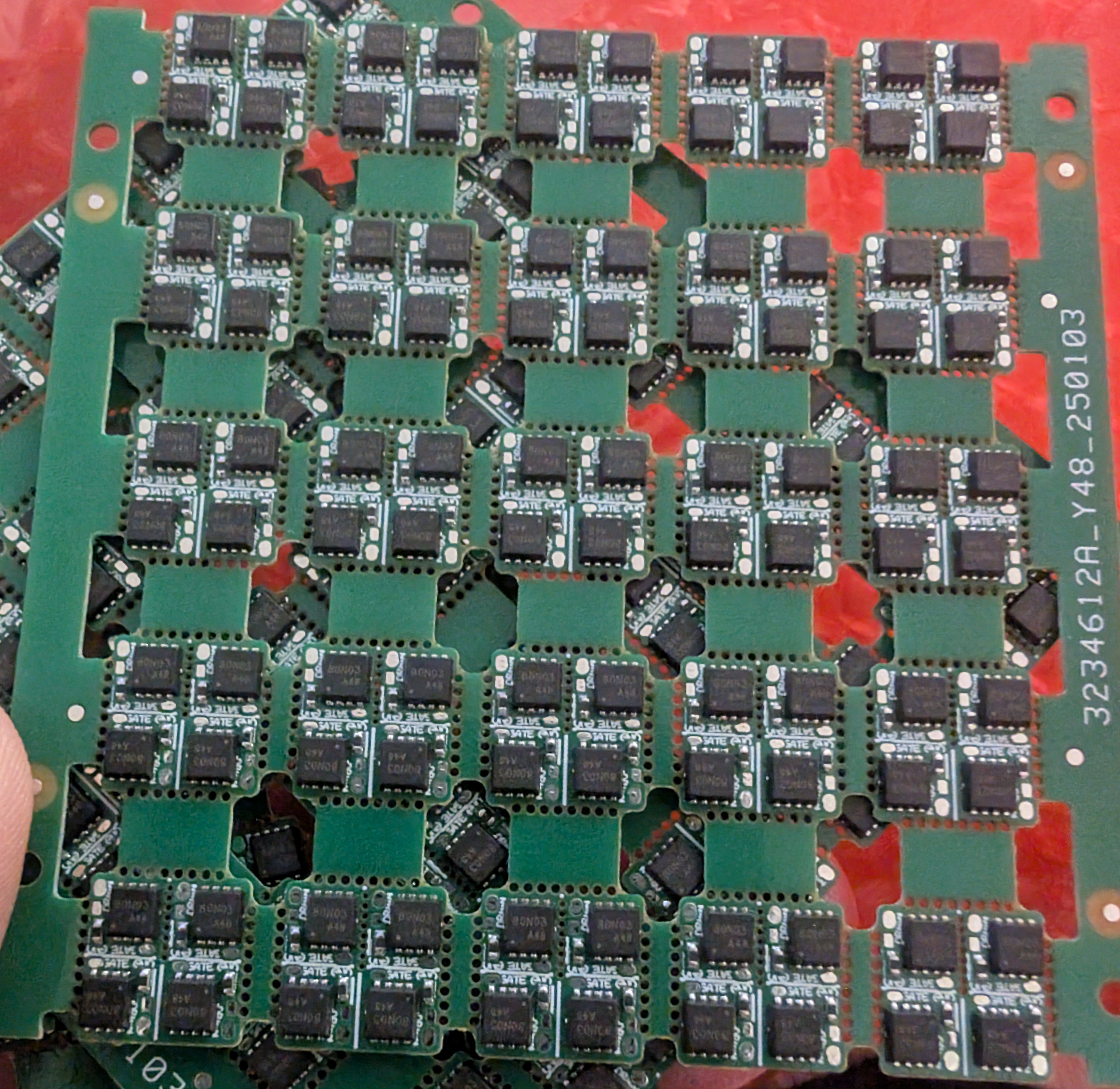

Dear friend, good evening.
The 200 pieces I ordered from JLC PCB were ready and sent, but the government in my country did not authorize their entry into the country.
I need to make a whole sheet like this photo, so it will be easier to enter.
Could you help me with this issue?
You want to use the "paneled" gerbers. Set the option to "paneled by customer, 5X5" for the boards. The flex cables i believe i set 3x6

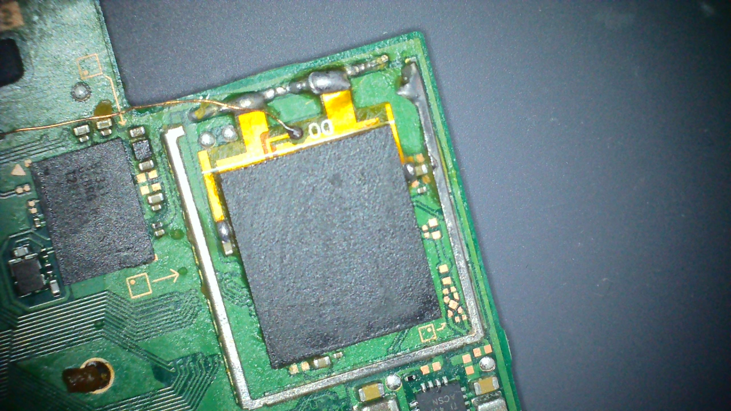

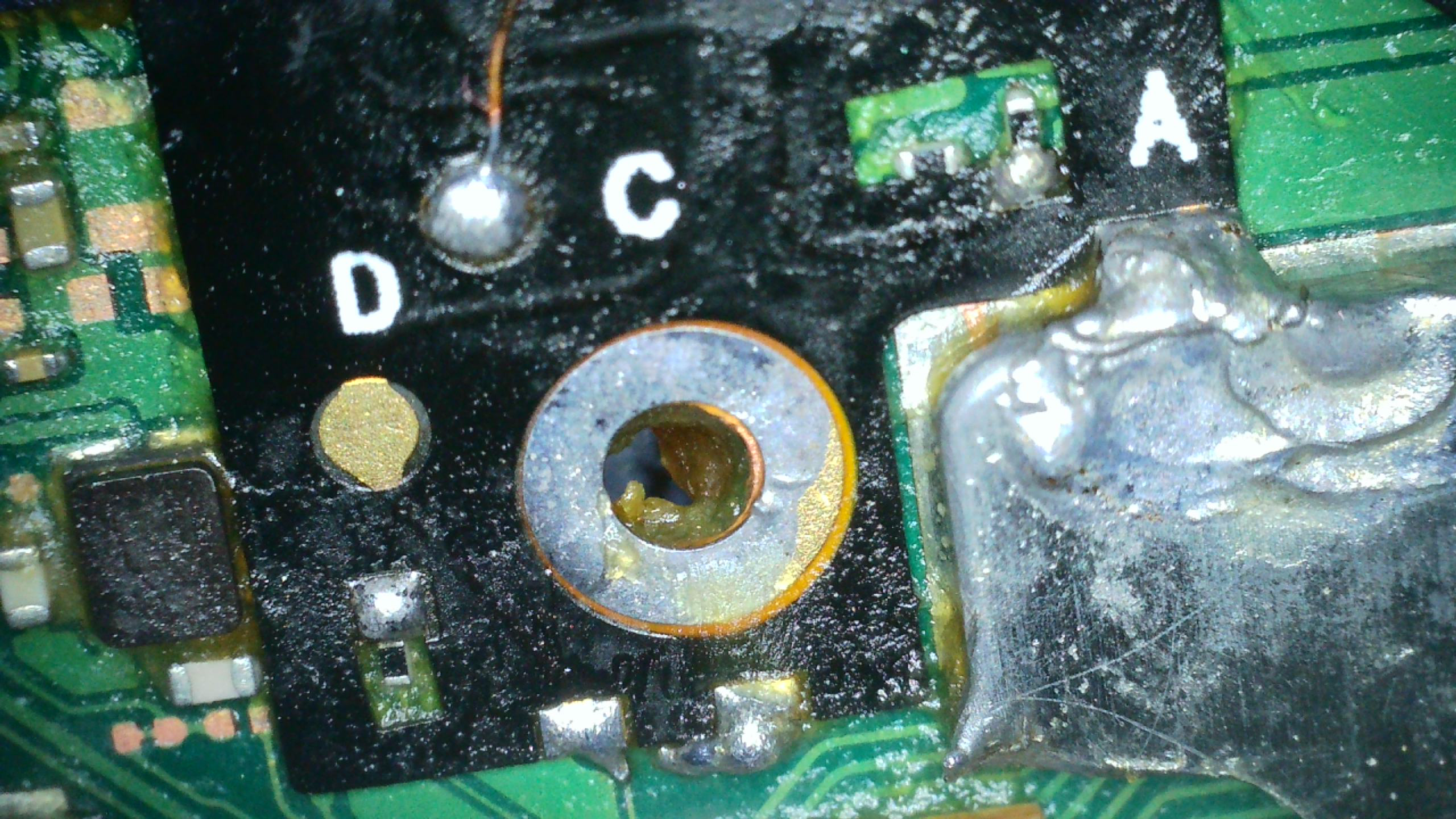

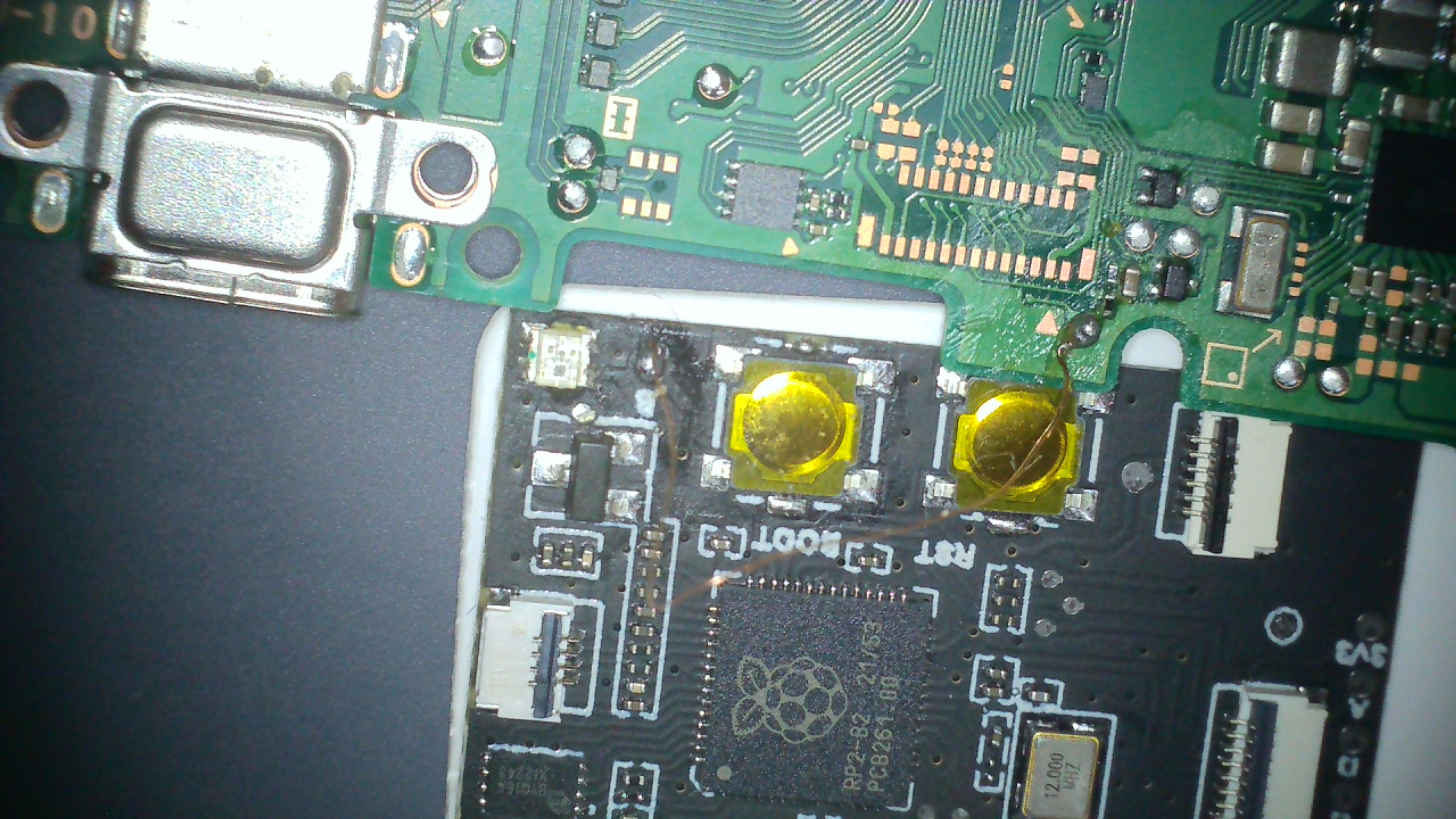

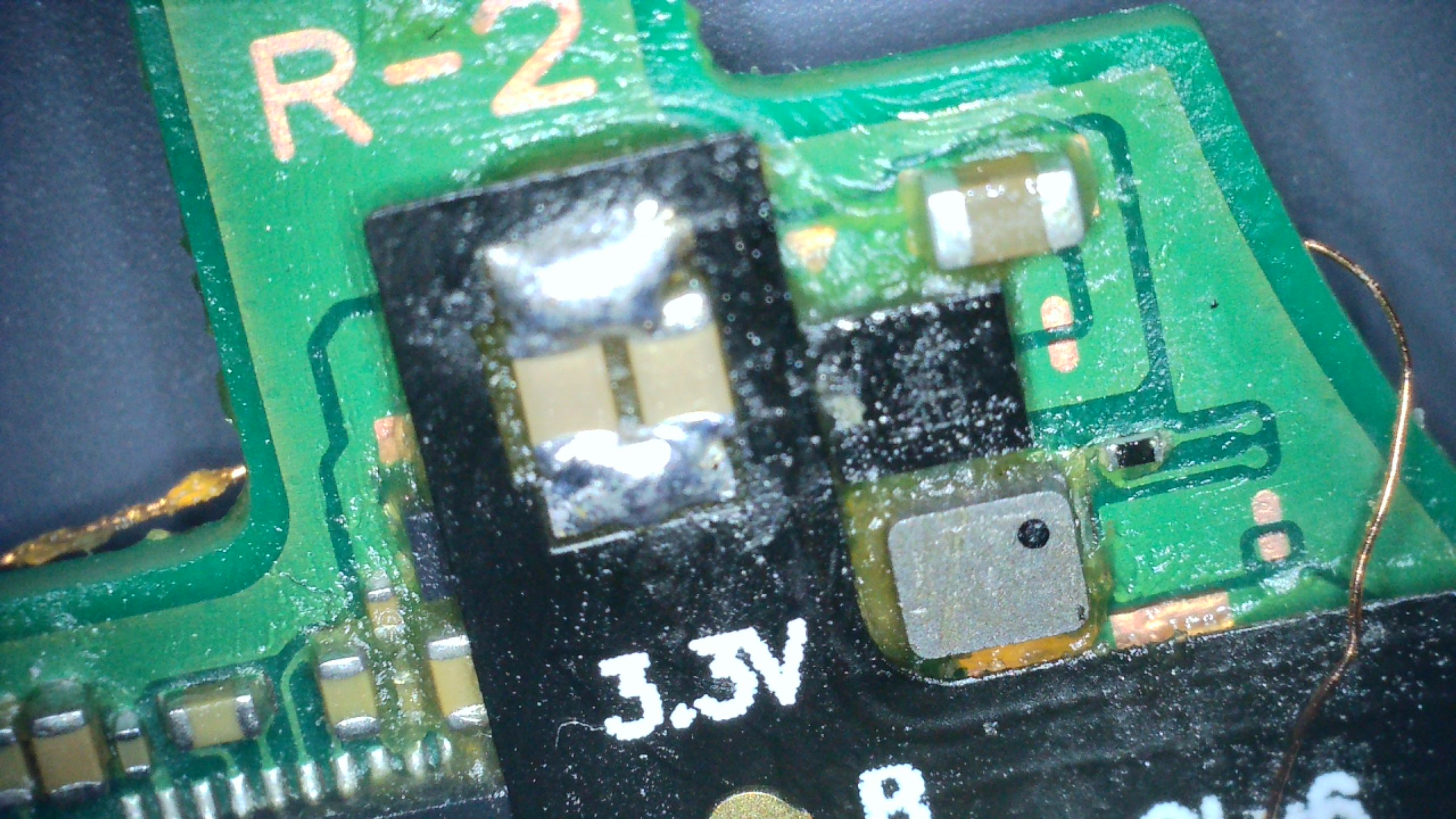

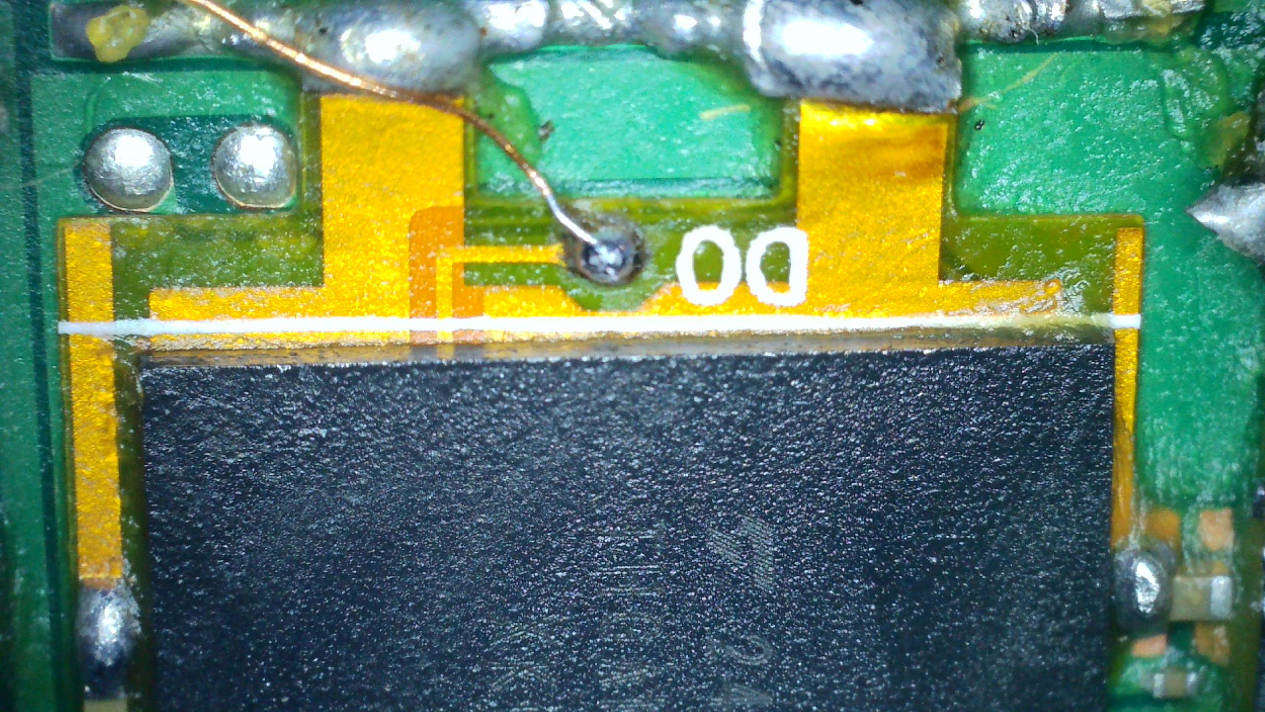

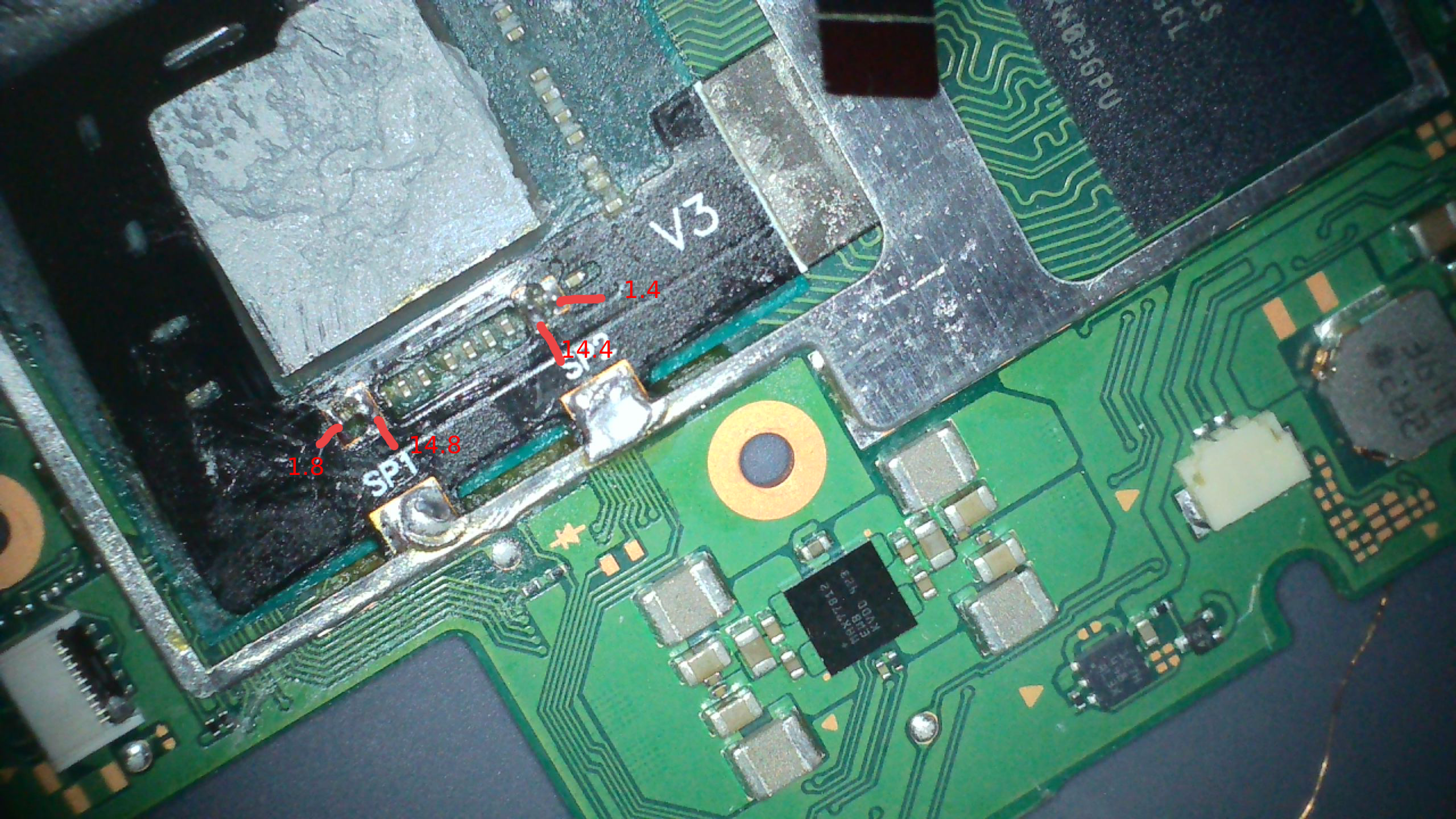

Dears, I am haunted by a yellow *== (No eMMC CMD1 request (poor wiring, or dead CPU)) on my oled chip install. Redid all the connections, everything reported in the correct ranges (sorry too tired to go back and note exact values) but this is my first attempt at soldering so im sure i must have messed whole a bunch up. I used this video as my bible.
Please see these pictures of how my attempt went, and let me know if something sticks out to you as to the cause for this short long long *==?
My leading theory is I might have bridged something under the emmc or just fried it completely as i attempted to solder on the super-close-to-chip pad on the right. Tomorrow I will take to it my 380c ts101 default tip , lots of flux and go tapping on it. I have a spare dat0 adapter but i dont want to try using it until I hear from you that its worth a try. I also went completely bananas on the apu shield - did not have an xacto or composure at the time, but I pulled it out and bent it, so I'm thinking chances of scratched trace underneath is low. I've chopped off all the locking mechanisms on the plate, do you reckon im good to flatten it as much as possible, insulate all my stuff inside as much as possible, and continue using it? Are there alternatives, like cutting it in half into a square and rectangle, so they individually hold their shape better?
Please let me know what options I have, also please do share a few words on how I should go about doing that, since that'll help me navigate this new thing im trying out. =]

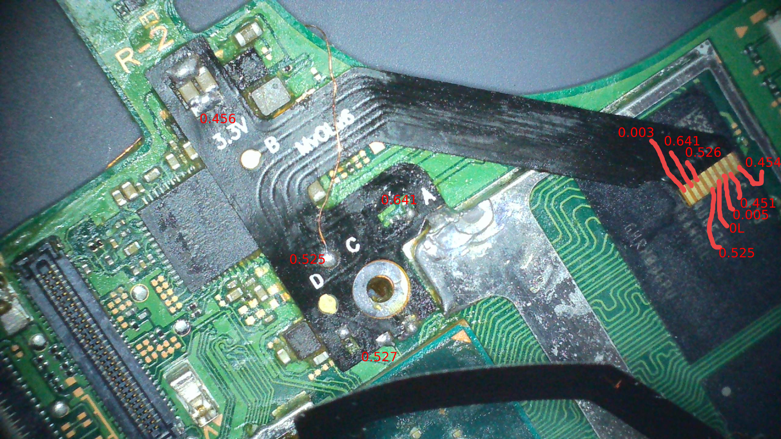

Dears I tried redoing all the connections again, with emphasis on not having cold joints. (lots of SRA flux, 380c, good contact) I still get the dreaded *== yellow.
What can I try next? Do you see something wrong in my attachments and the readings?
(All readings taken red on ground, black on point, diode mode)
(Except sp1/sp2, one on ground and one on either side in resistance mode)
(B point in diode mode with one tester on ground and one point, 0.400 one way and 0 in the other)

Ok, took all the cables, adapters and everything off, it still boots into ofw.
I'll look for better solder, pick up another modchip packet, and try again. Should I be extra mindful of something before my next attempt?

that happend to me i was use raspberry pi pico it is working cfw ofw fine. after change it to rp2040 it is not working change mosfet same all point read good coz it is ready soldring for raspberry pi pico. i have more rp2040 will change it and see.
Reactions: impeeza
i have an oled that after a picofly install all diode values dropped to half (from 800 to 400). it stopped booting after that.
do you have any leads on how this could be fixed?
me be the dat0 point or line kimkazi is cut or iron ball damage if dat0 adapter. some time it need charge more. or ic 77801ewp chip is fulty.
It is very important to install on OLEDs starting from the most problematic point. I always start with the kamikaze. A kamikaze finished text smoothly if everything works as it should. then it continues. By doing so, you rule out 90% of the problems.
