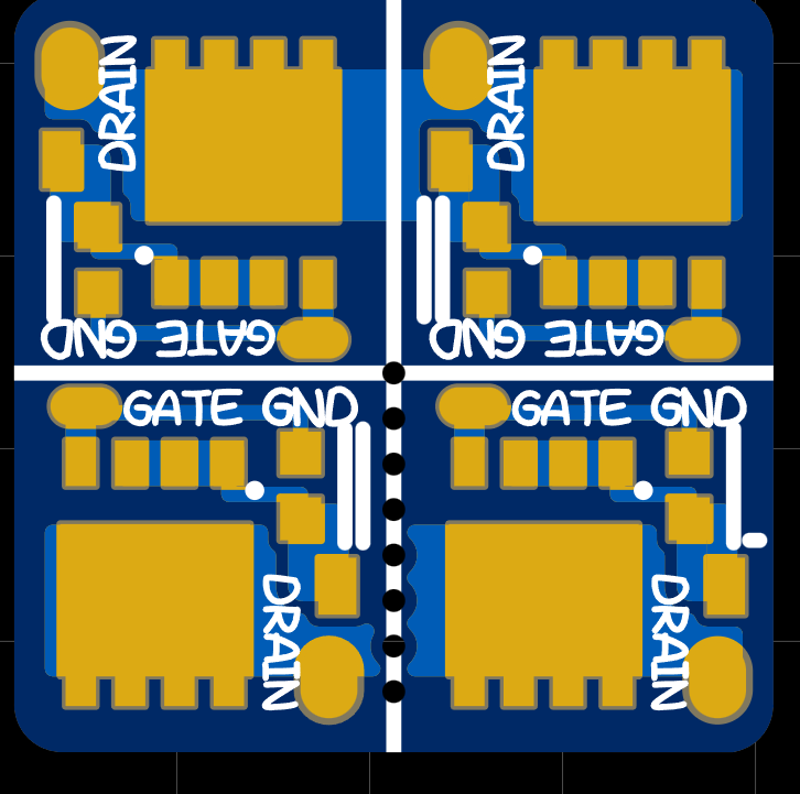

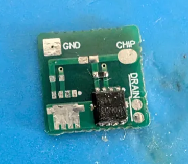

jkyoho https://github.com/pbanj/Fet-1 finally finished. Made 2 different styles​
Also working on this https://github.com/pbanj/HB-PCB there is a discussion open on the repo. would love feedback and what not.​

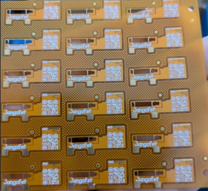

for jango you may have to cut the copper side used for v2 to use it on v1. i thinned it out more recently to hopefully solve that. have some on the way to make sure.
i also updated boba so each board is 2 boards. just have to cut them
also soon ;)

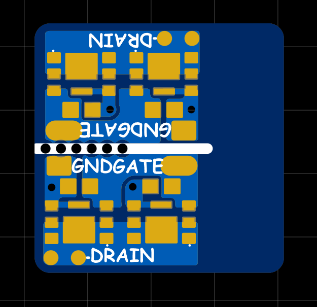

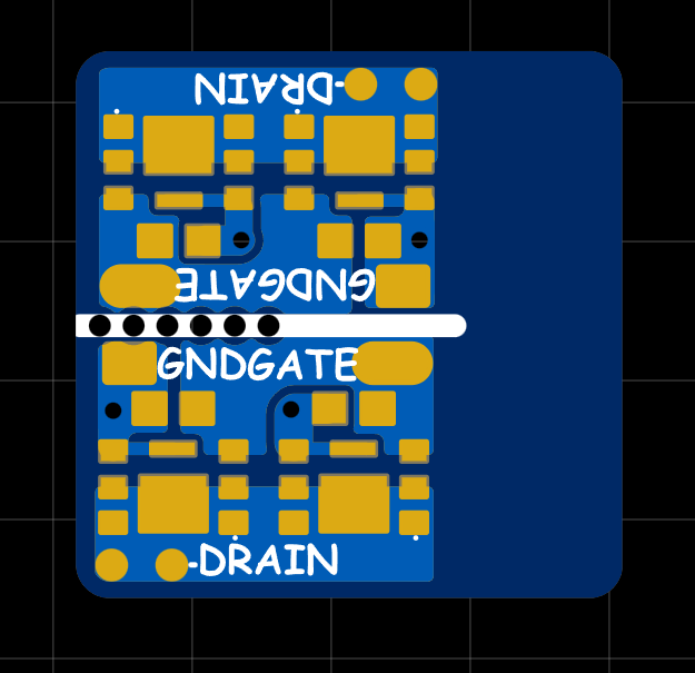

also working on this. waiting for the mosfet to come in. it should work with only one. which would allow for each board to become 4 after you cut it. jlc wont assemble under 10mm*10mm so im keeping all the different version within that range and just adding more to it if i can.

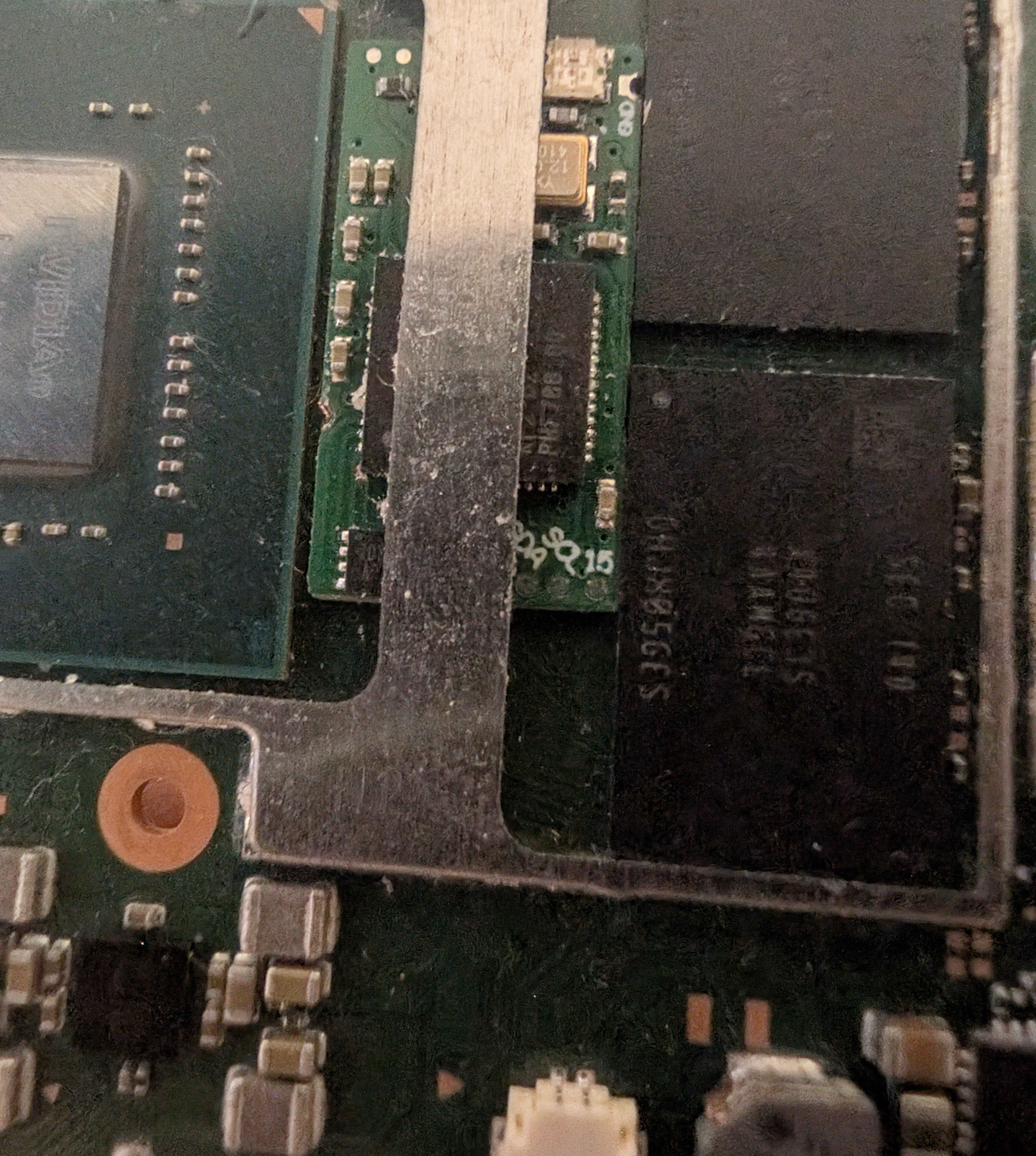

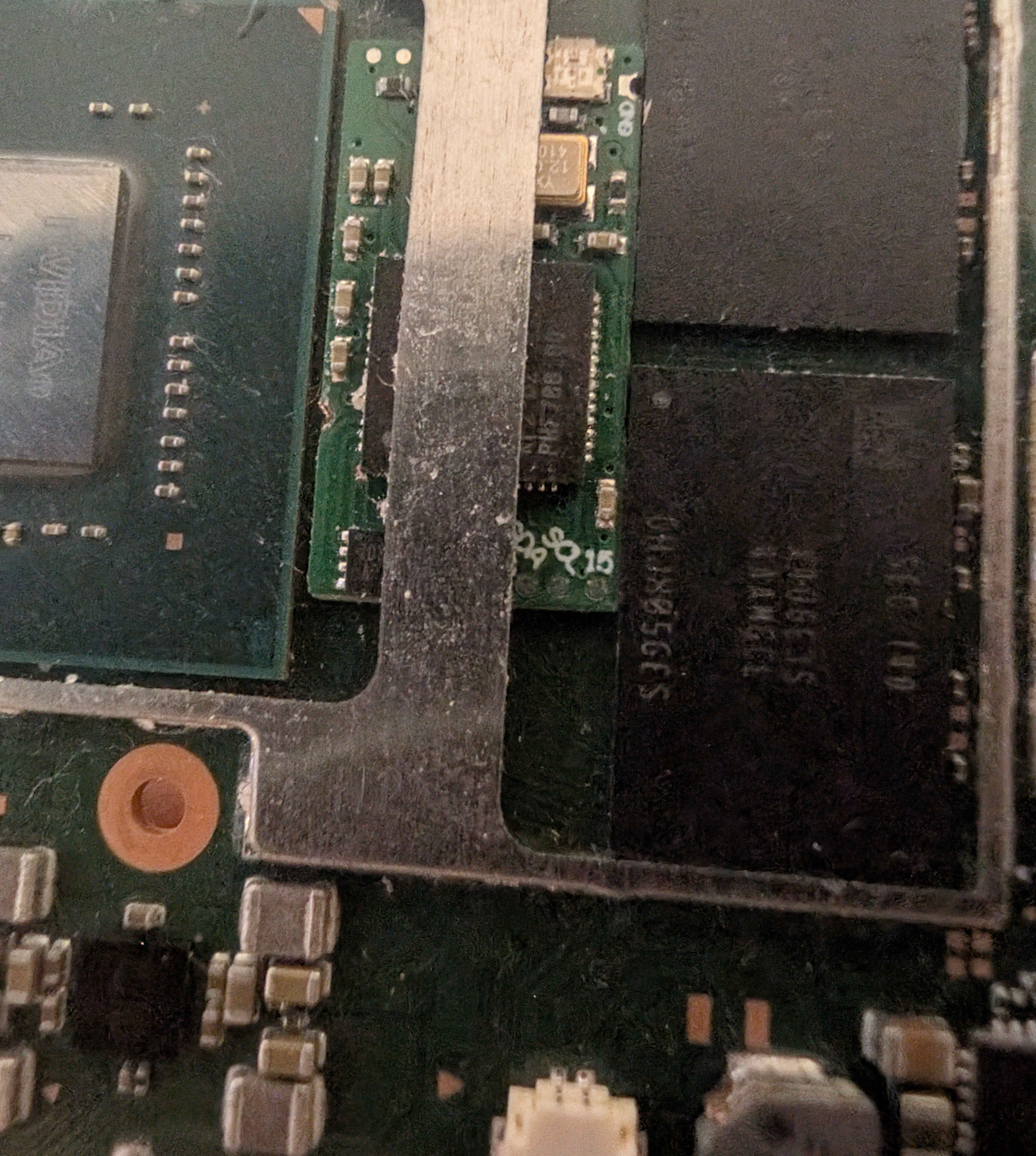

Having an issue, installed a picofly on a v1 switch, everything was smooth. Console shut down out of nowhere and now all i get is a single pulse blue light from the chip. Found that the ram got pretty toasty upon further inspection.
Any leads?

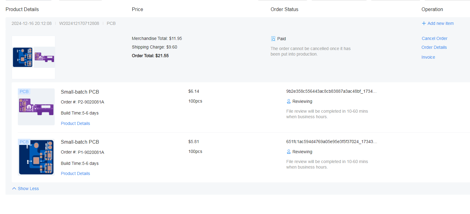

One more question: is it possible for me to order the adapters already assembled with the components from JLCPCB?
should be able to, it is just really expensive to get flex cables assembled. on the github i put some cost breakdowns. https://github.com/pbanj/Fet-1#price-breakdowns
the cables are super easy to assemble. just need to have a hot plate(these can be found for $20 on aliexpress), have a stencil made, and some decent low temp solder paste.

so i got in the updated jangofet in
no need to cut the vertical pad for it to fit the v1. i did have to shorten the "legs" as they were too long for the v1(can just cut them to fit}. also the default fpc thickness on jlc is extremely thin, make sure to up the thickness to 1.2.
Any leads?
post pics

so i looked at it again today, the battery charged a little bit. but now im getting error 2101-0001 (0x265) on both emunand and OFW. there was some hissing sound coming from the apu. really weird considering i used the console for a good amount of time before it shut off.

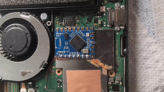

Does anyone know the value of this resistor right next to the capacitor? And if i could pull it from an oled donor board?
yes you can pull the parts off a donor board.

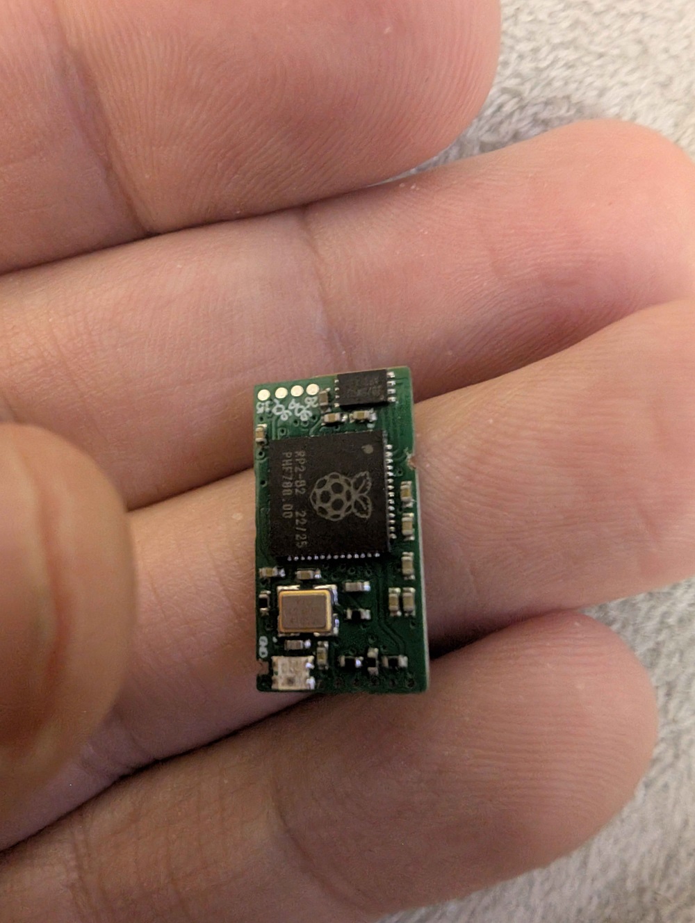

some updates on picochu for those who care. flasher design is finally done, now the software side needs to be done. the picocenter hat template is done. i have the hardware for the flasher on the way to me so the software side can be worked on. i was also able to shrink picochu down .8mm so it is now 10x18mm.
heres a crappy 3d render of the bottom of the flasher
Dealing with RF frequencies you'll need plenty of grounding vias so that it wouldn't interfere and produce noise on the lines.
