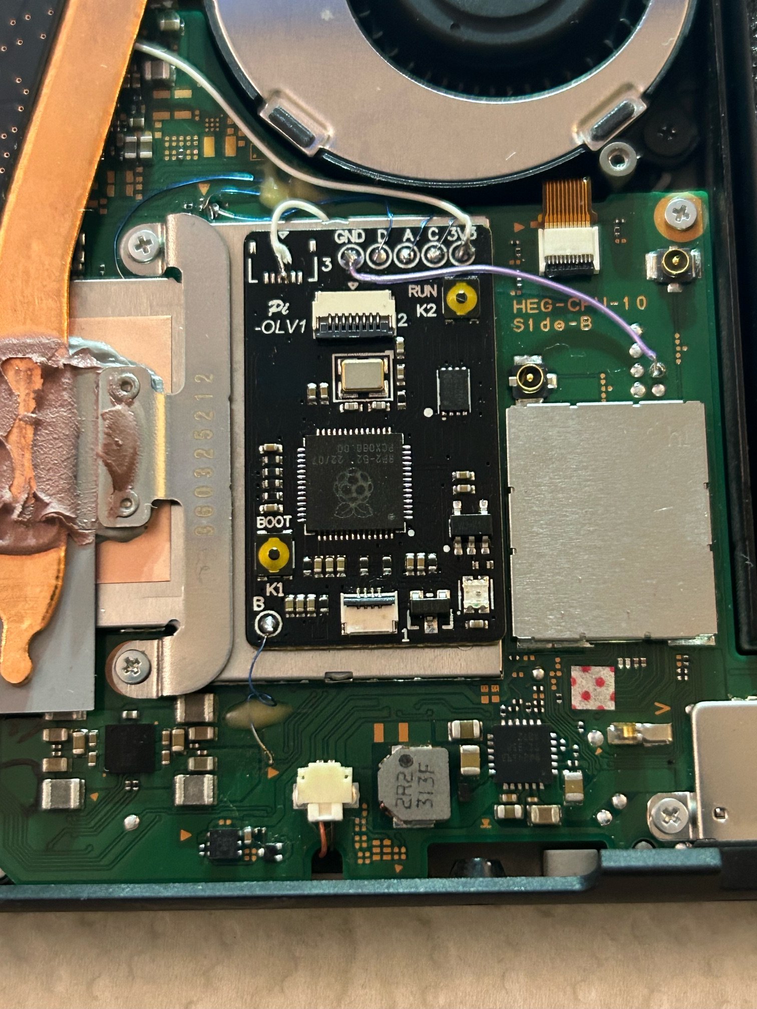

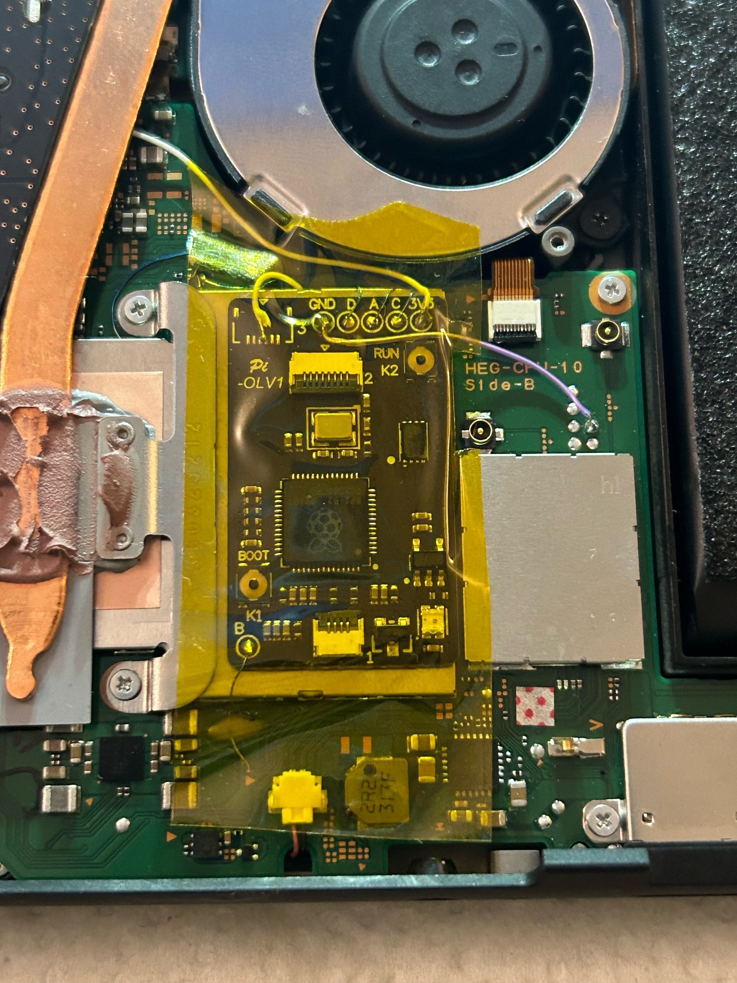

Is one quick green flash okay while flashing pico chip? Or do i need to bridge it to get the red flash still?
Also, is 40AWG magnet wire too thin or fine for V2/OLED installation?
It's perfectly fine. This has now been asked several times here.
You can take it. Personally, I use AWG36. For AWG40 I would perhaps prefer 3.3V and ground thicker cables.

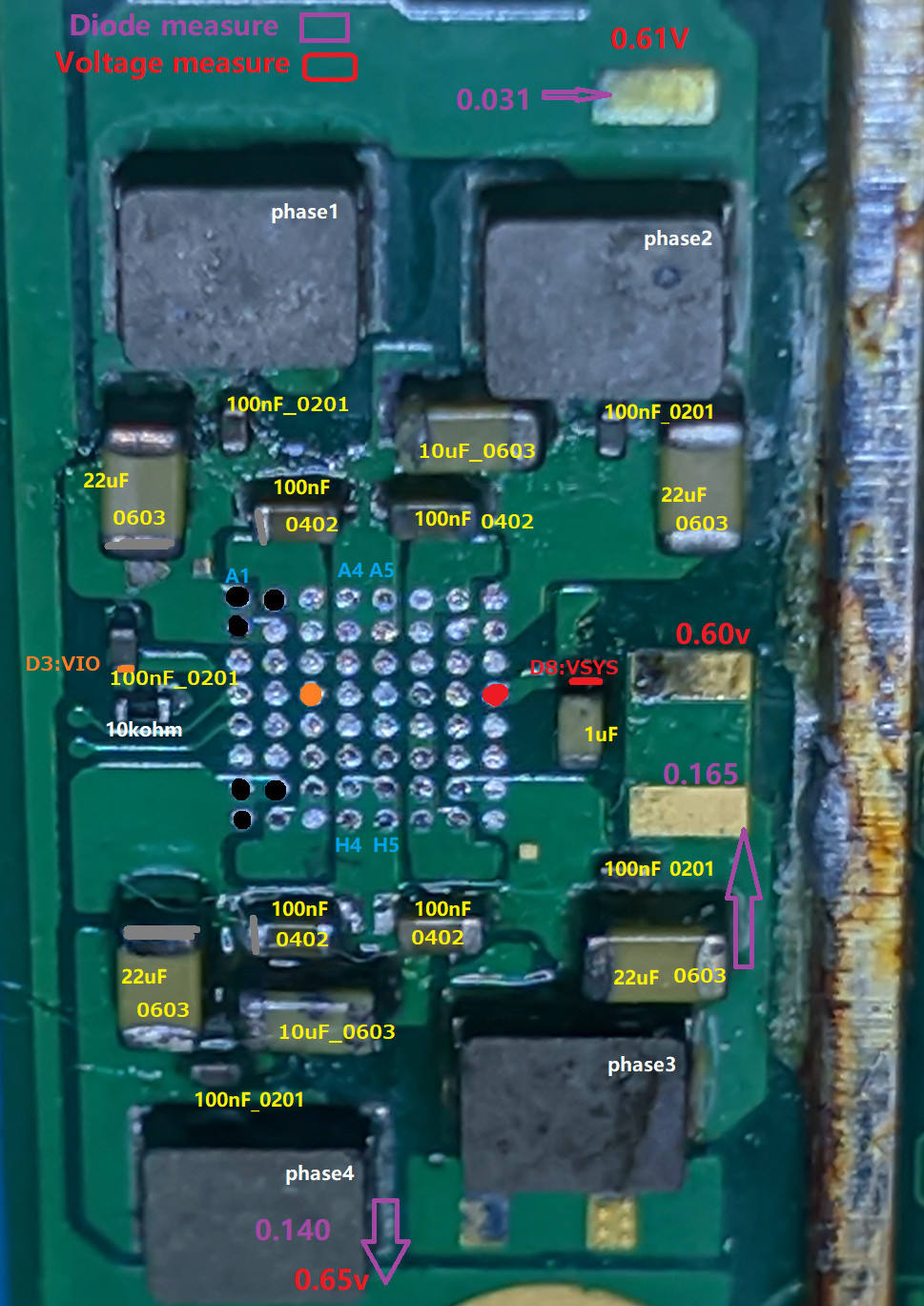

hi, is your original MAX77812 had any defects visible under the microscope? Also make sure your new IC has no defects and sit on the board properly. Is any voltages present on its phases when you see the blue screen? This IC is vital for SDRAM I/O, so its should be enabled on early stages when loading fw.

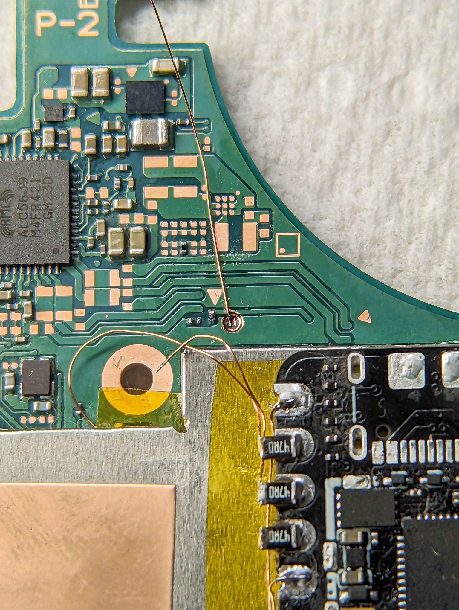

Thanks for your response! Yeah it boots all the way to the game selector. I checked through system settings and stuff a few times and all seemed fully working in the OFW side. But thanks to your suggestions I have some places to start now. Tomorrow I will try replacing the 47ohm CMD resistor on the Picofly and change the wire too just incase. For the 3.3v I used the one from the capacitors near the fan connector. Picofly seems to get power every time but I will remove solder mask and check readings properly tomorrow too. Cheers!
Update to this, it was the connection between the Picofly and the CMD resistor on the motherboard, like abal1000x suggested! It was showing a reading on my multimeter but upon further inspection the connection under the solder mask was actually broken. Must have been a bad solder joint to begin with on my part. This was my own personal OLED and the first one I modchipped (at the time). I got afraid of the CMD resistor and I guess I didn't use enough heat. But now the console boots to Hekate! Instant glitch. Just now I am masking up the connections and later I will put it in the ultrasonic bath and reassemble it. Thanks @abal1000x for your help!

Do you have a good diagram to check for the phase voltages? Just want to make sure I'm doing it correctly.

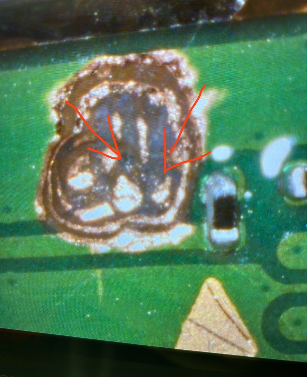

Hi Guys.
I want to share this terrifying experience I had today

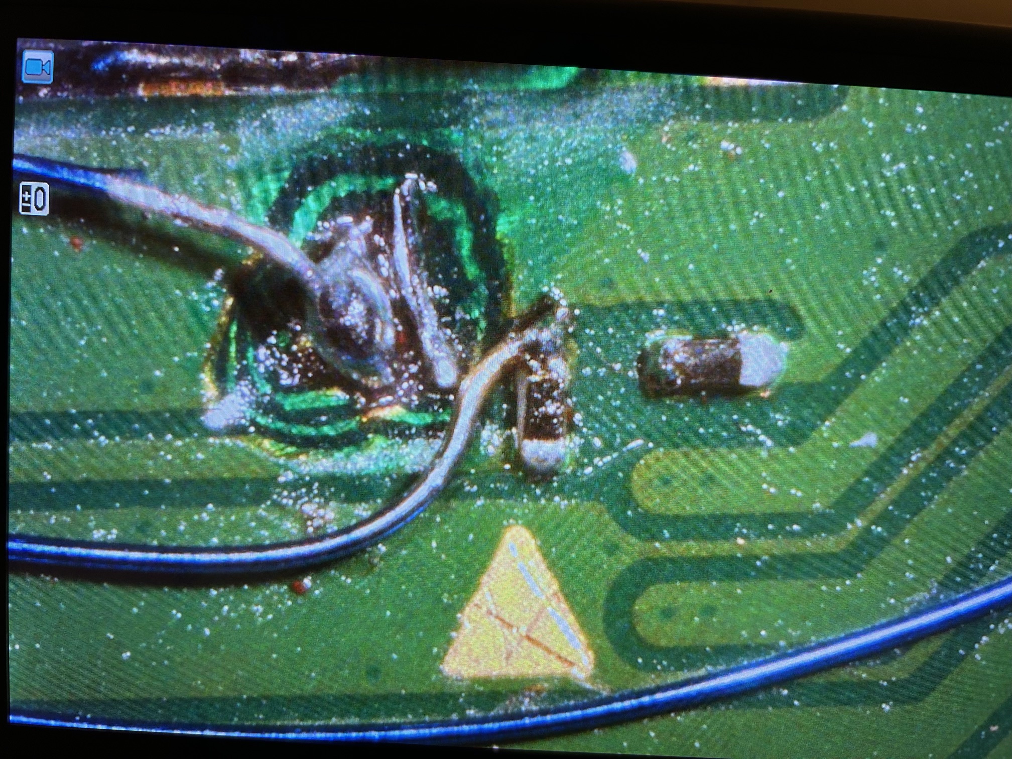

i received another Oled (brand new ) to Mod and decided to try another drilling tip (big mistake ). It drill´s faster and after a while i saw that i´ve fucked up the Dat1 and Dat0 via :cry:. Of course console stop power on when i press the power button. I went to deep in the layers before i stop. Problem with the self-confidence I gained from doing the previous kamikazes.

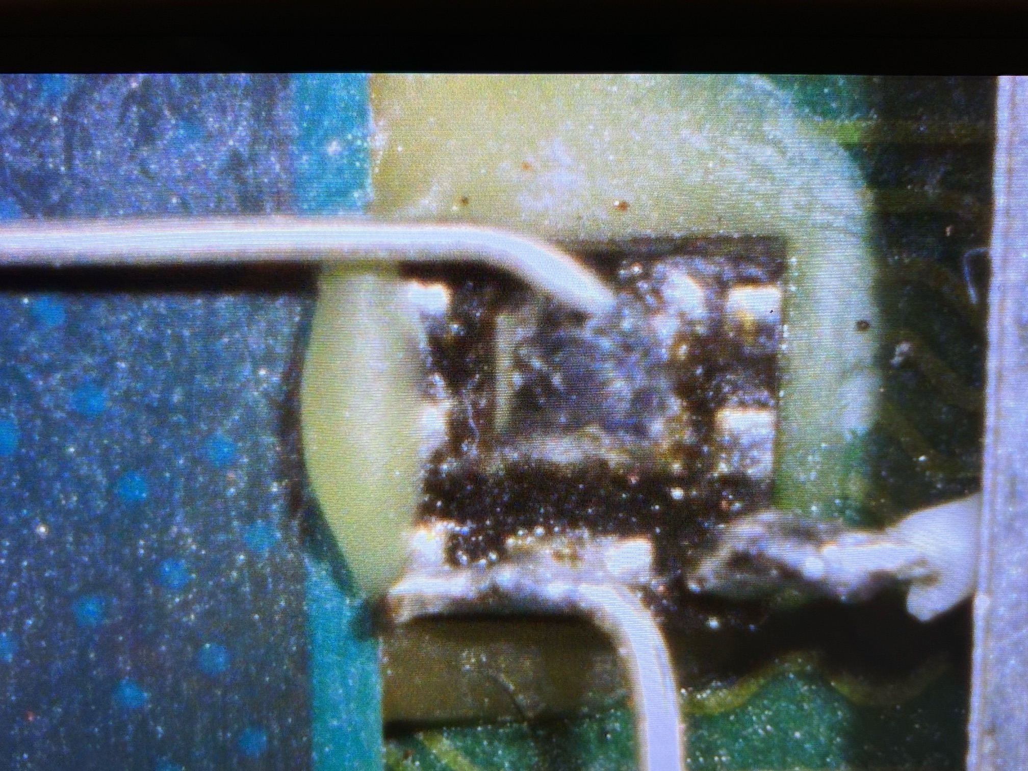

Decided not to give up and do my best to get it back. Applyed some solder mask to proteck groud contact and start rebuilding both via connections . After 2h fully made it :toot: :
It seems easy, but then who already perform kamikaze on the oled knows that its a tiny litle hole. Connecting to via´s and take the risk to connect dat0 to picofly was just crazy. But in the end it paid off.
I allways use the single mosfet installation with out any problems (V1,V2, Lite and Oled)
At the end everything works perfectly. Allways instant boot. This Oled come back from the dead :)))
