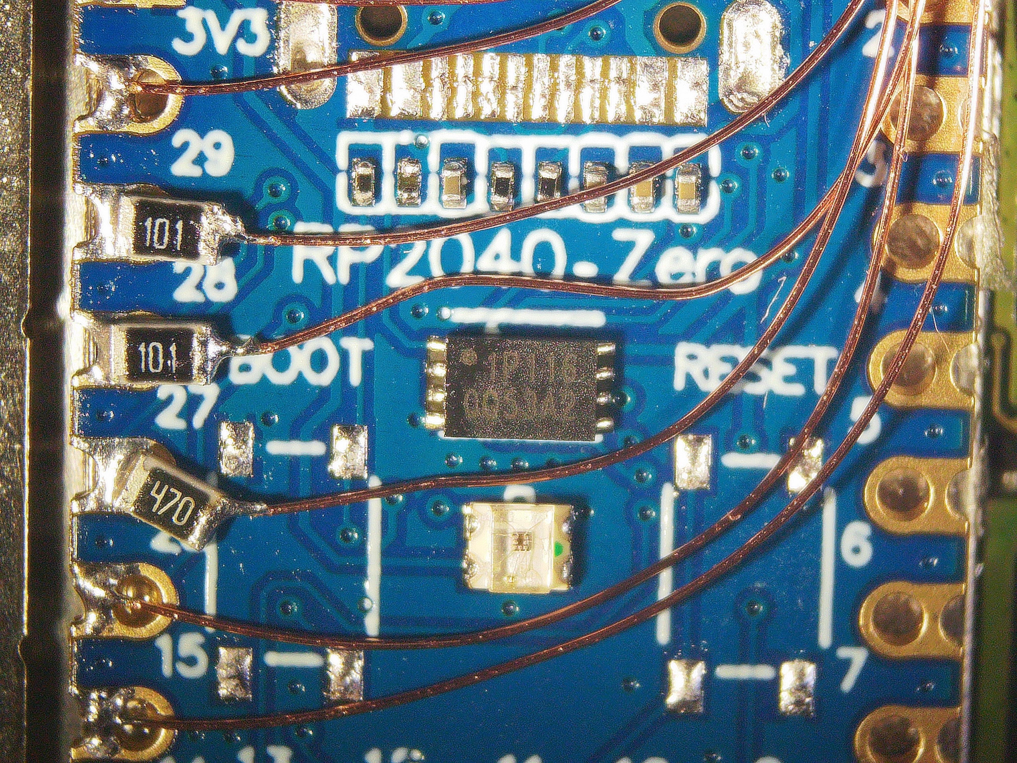

What he is saying/doing is that he uses single 100ohm resistor on dat0, single 100ohm on CMD, and single 47ohm on CLK. So 3 resistors in total, same as always just different values so it's not a single 240ohm resistor.
Nothing else as far as I remember, he is just good at what he does and I think that after encountering this slow emmc error a couple of times he started using 100/100/47 as default and never had any issues with this setup.
Oh! That makes sense, thought he did all three in series on all lines :D

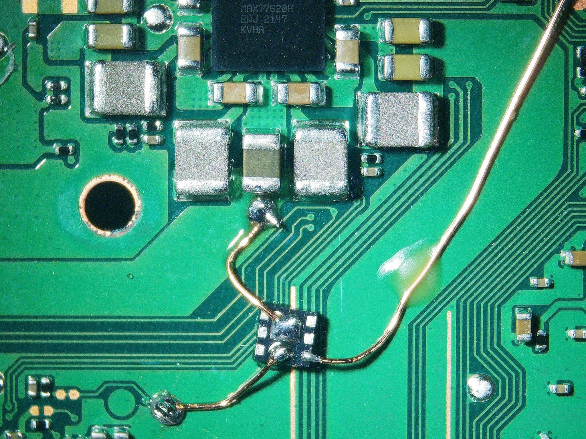

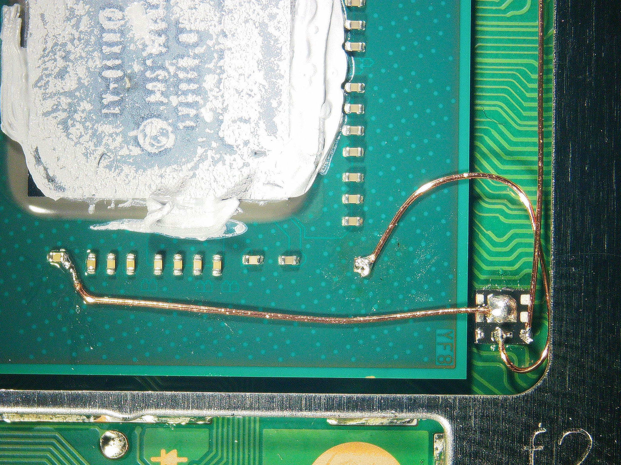

Nothing, really. I put the mosfet on the back on OLEDs because I find it easier and I don't have to lift the apu cover at all. front mosfet on v1/v2/lite since then I can skip detaching the mainboard. I use the green reball adapters for emmc on OLEDs because it's a more permanent solution (than the slide-under dat0 adapters) that also provides easier CMD/CLK points, and allows me to not have to cut any shield frames.

Do you have a picture? How do you fit that many resistors? :D I have two Erista's with some weird error, one has a EMMC slow error, and the other, Atmosphere just errors out, or doesn't boot. Booting to OFW seems to work fine on both.
EDIT: Also, wouldn't a 240ohm resistor do the same as 100/100/47?

I fully agree here. From all the ones I did, I only needed to add additional resistors 2-3 times and they were all Eristas.
But nowdays I follow @deeps route and I do 100+100+47 all the time, I haven't encountred that error since.

"mosfet on the back" - alternative mosfet solder points on the back side of the motherboard. see picture. no need to lift apu cover because you don't need to solder anything to the apu if you put mosfet on the back of the board.
"mosfet on the front" - mosfet mounted on the apu, same place as the hwfly flex cables. see other picture.

By adding another resistor (3x 47 ohm) fixed my issue. In another thread, I read someone had to use 4 but I tried with 3 and it worked.

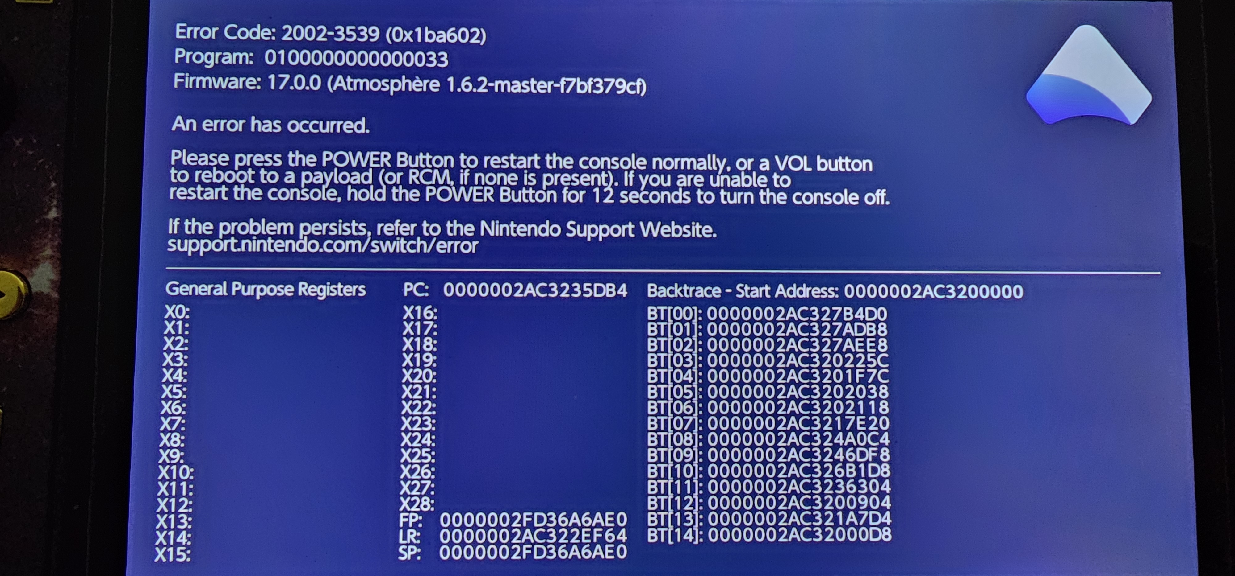

So, I decided to turn on my switch to OFW and got error code 2002-3539. Saw it was a problem with the NAND, but eMMC partitions was still there and it does pass through the Nintendo Logo and the Switch Logo before hitting the error. Checked my RP2040 Flyboard-clone firmware version and saw there was a new version. So I booted up the picofly toolbox and updated. No idea if it worked because after a reboot my switch went straight to purple screen and checking eMMC info says the entire GPP partition got wiped.
Currently restoring with a fresh backup of last week. But it is annoying to see this happening. Just hoping the NAND chip isn't fried.
edit: Restoration done. Now I'm booting into a black screen... this is just sad. Oh, and Picofly_toolbox reports it as still the same version so it didn't update. And updating it does clear the eMMC... again. Back to another half hour of restoring.

Well, restoring the backup did remove the purple screen. But now its replaced with a black screen. As for checking to see if its compatible with the update... tbh I thought Rehius' firmware would just work with the clone boards running Ansem's
edit: re-soldering the wires did not do anything.
Try adding more resistors to dat0. I had the same error a few posts back.
So, there was a reddit post by someone who also got the same problem and they got told to retrain the pico. Well, it does work and no longer black screens after the Nintendo Logo. But....
Sadly, I just return to the same error code that started all of this mess.
Well it boots into rcm mode, so that's good. Just delete your atmosphere folder and reinstall it from fresh and make sure your fusee.bin is updated. With the latest from the githb page.
