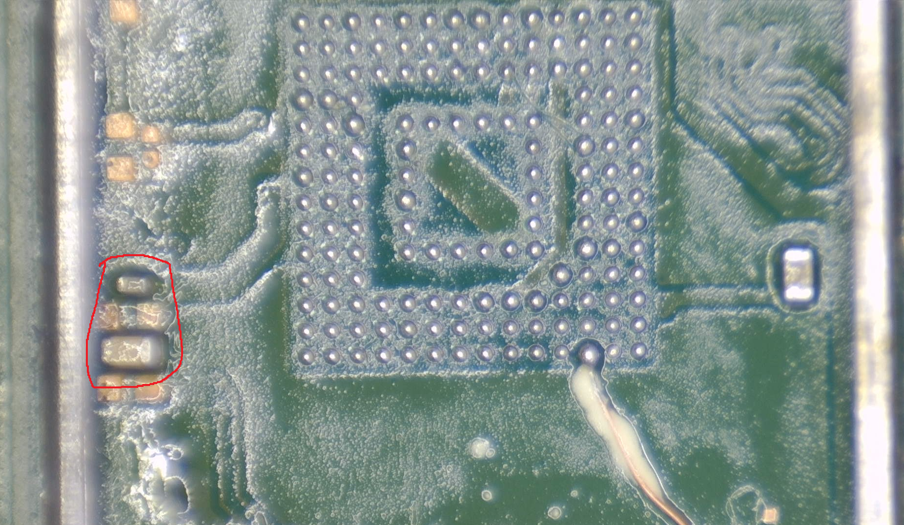

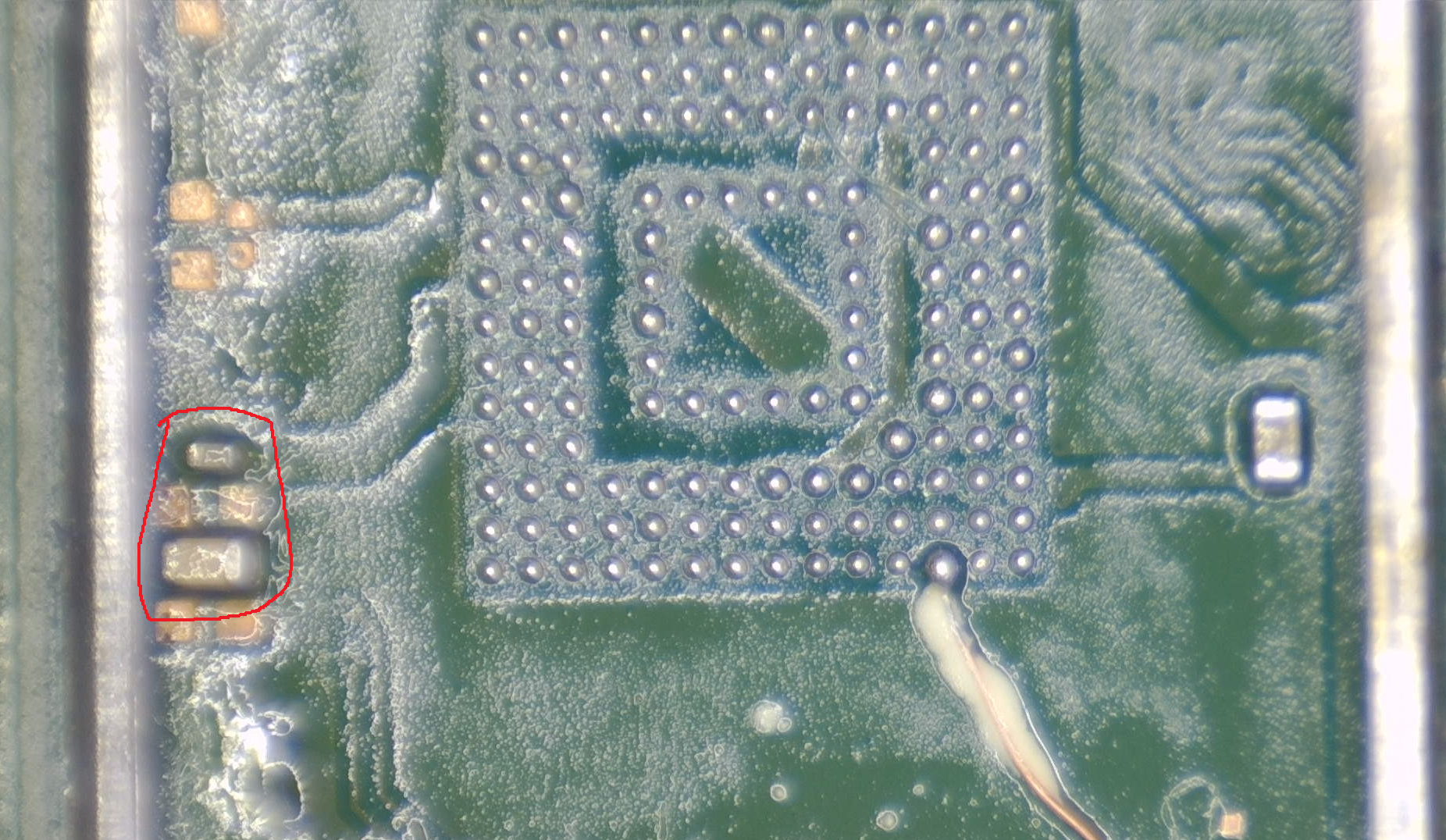

This oled broke after 1 month. No power. I did a reflow and it did not fix it wich leads me to think the problem could be somewhere else. When randomly checking the caps, these caps are shorted to ground with the emmc on, and without the emmc on. When i tested a known good motherboard, i should not have a short there. Where do those caps lead to? What size are they in case i want to replace?
first , remove the caps and check if the short is still there
They filter/stabilize the vcc (3.3v) supply for the emmc. i would guess some other chip on your 3.3v rail has broken - perhaps your rp2040 or the 3.3v wire to it?
