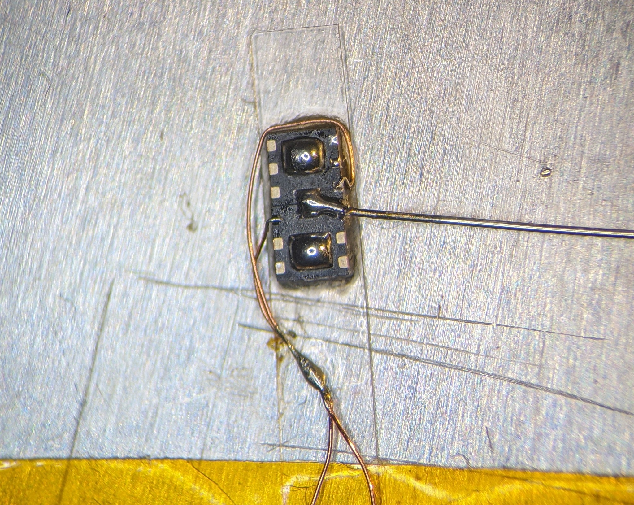

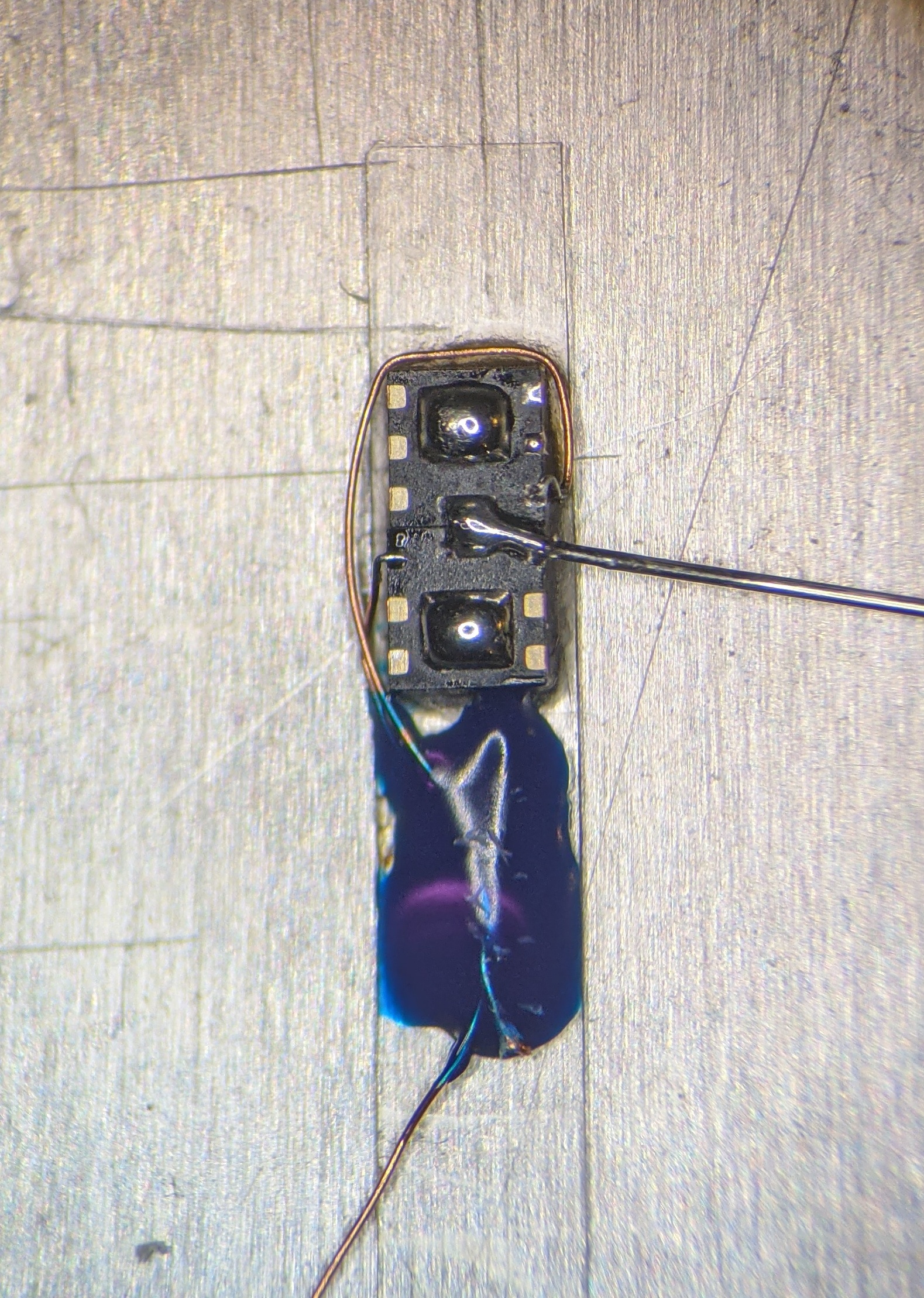

Had some time to play around with MOSFETs in order to find a way for a quicker soldering to the SoC.
  • basically, got a transparent plastic as a base on which I fixed the 2 MOSFETs with a tiny bit of superglue (from underneath). This way they won't move and make the soldering easier.
  • soldered the Source and 2 Gate wires. Afterwards bridged the 2 Gates, so there'll be only one wire that goes to the Pico and used some UV mask to isolate the soldering point.
  • now these "flying" MOSFETs can be taken by the plastic base and fixed easily nearby the SoC, and afterwards anchored well with Drain wires + more UV mask.
No science here, just a silly test that I wanted to share with you.
