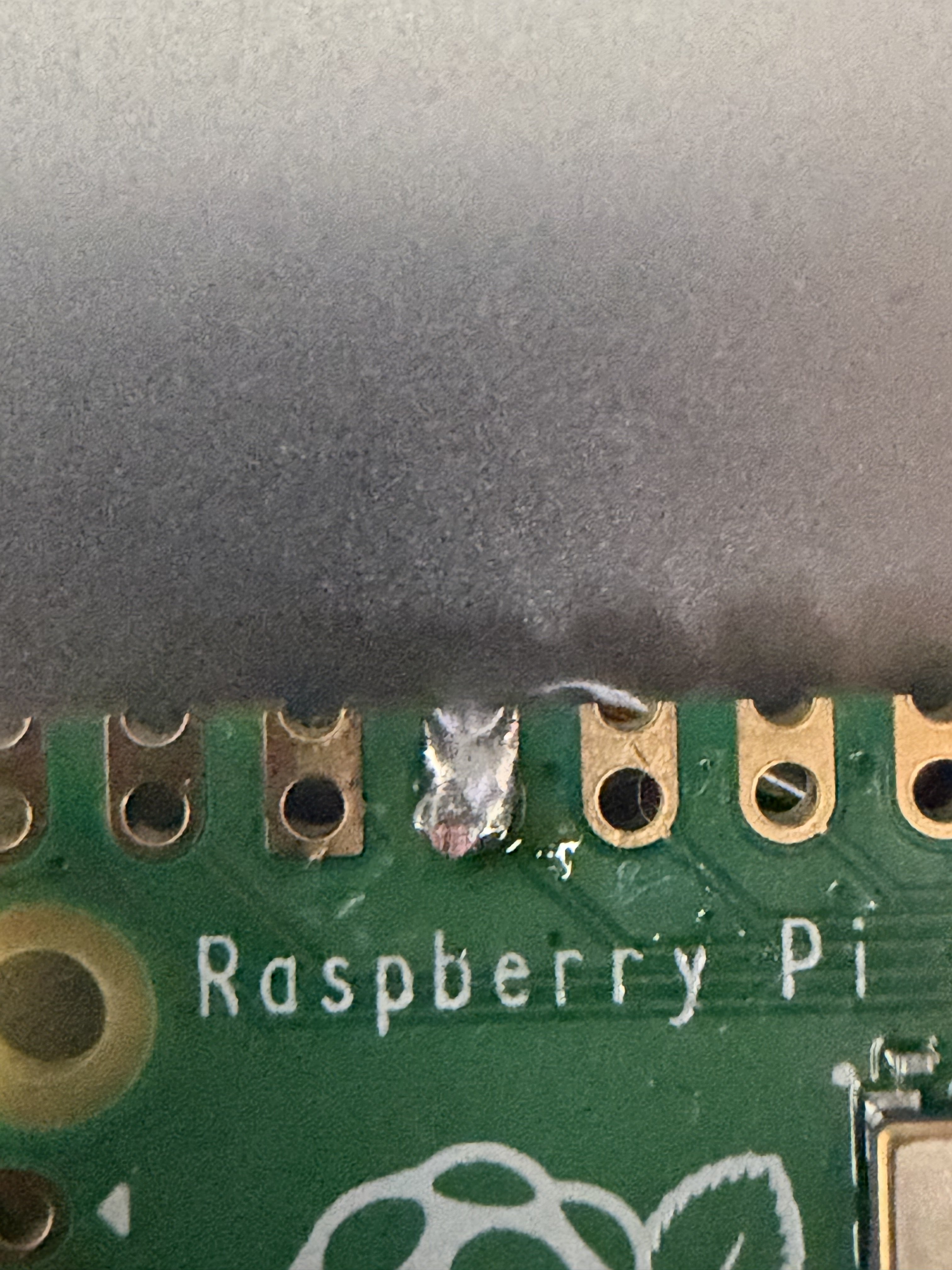

So, does it matter if I use solid core or stranded core wire? I’m using the soldering stations in the engineering lab in my school, and just want to make sure if there’s a certain type of wire needed to do the connection from pico to the board.
I made the jig, but does it look ok? Not sure if I soldered it properly! I was worried cause it wouldn’t read the pico from my MacBook, so I tried a windows laptop, and it worked. (Same laptop I flashed the .uf2 files onto just a bit before). I don’t want to accidentally short out the pico!

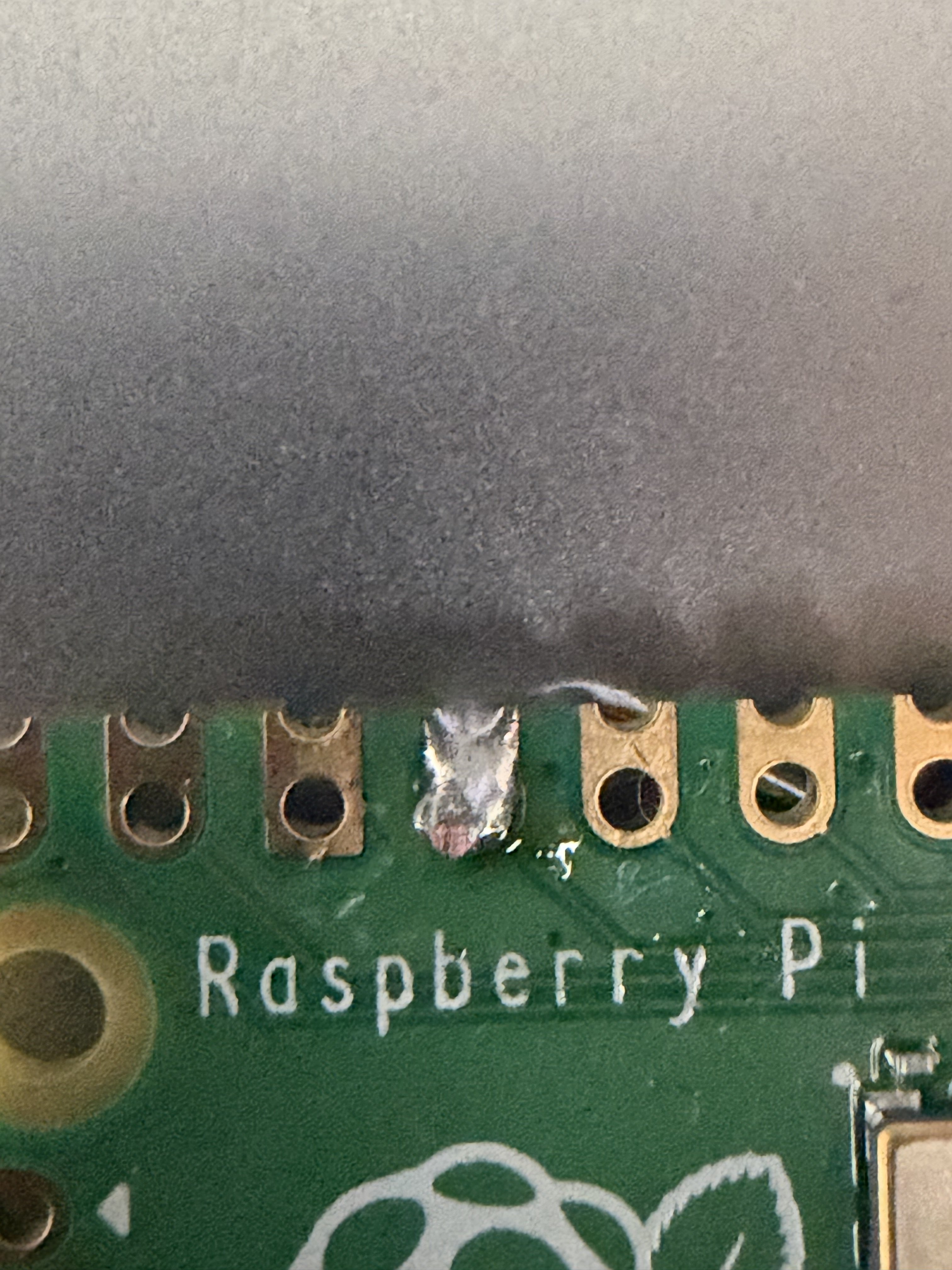

This good?

There's no video guide, but there is a text guide in another thread...
That sounds like a random software issue. Your Pico is fine, and don't worry about your Pico, what you really don't want to break is your Wii U, remember? Don't forget the Pico is very affordable :lol:
I'm a novice, but the solder joint looks good to me. The linked guide also recommends taping SWDIO and SWCLK, so don't forget to do that just in case.
Ok! Yeah, I’m a beginner with soldering, but just wanted to see if anything bridged that I couldn’t tell.
Thanks again for your help!

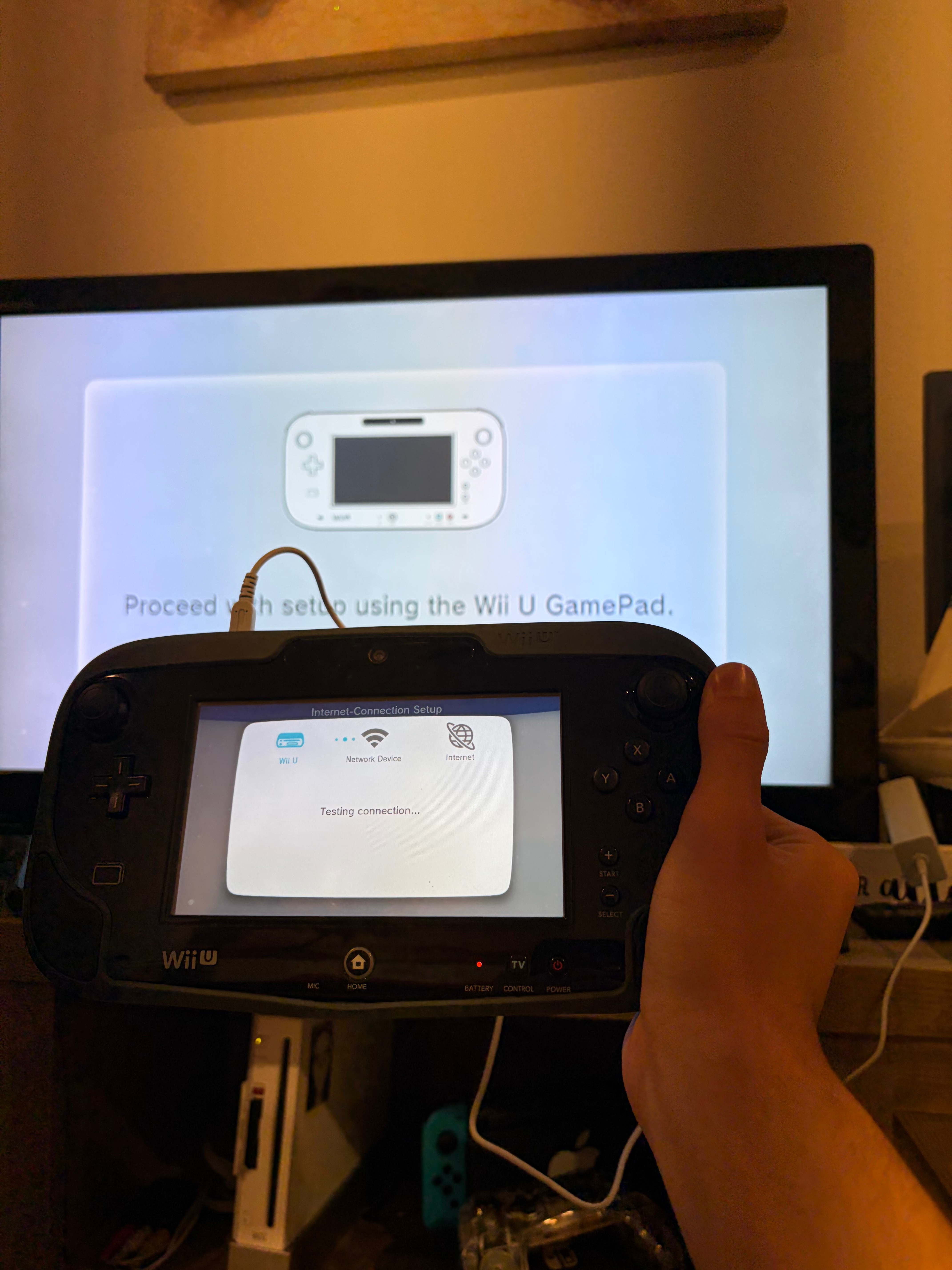

UPDATE- WAS ABLE TO GET TO NORMAL WII U MENU- didn’t freeze! Able to play smash bros and connected to internet! I’m gonna do the mods then install ifhshax to help if it happens.
Here’s a photo
