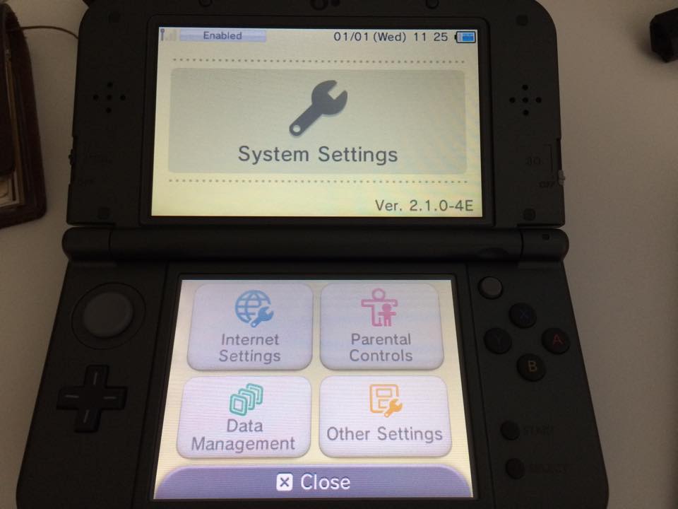

A quick question, where is ctr.bin? Is it CTRNAND Partition on sysNAND or bricked emuNAND (2.1)
3DSFAT16tool (C version) by d0k3
injecting & encrypting ctr.bin
to emuNAND.bin
using nand.fat16_0x4_.xorpad
open ctr.bin failed!

CTR.bin is extracted from your emuNAND.bin with the command "3DSFAT16tool.exe -d -n emuNAND.bin ctr.bin nand.fat16_0x5_xorpad"
It is than modified and reinjected with the command "3DSFAT16tool.exe -i -o emuNAND.bin ctr.bin nand.fat16_0x4_xorpad"
Do you mean it's extracted from my 9.2 emuNAND.bin then modified and reinjected to the bricked 2.1 emuNAND.bin?
No. It is extracted from the bricked 2.1 emuNAND, then modified and reinjected into the bricked 2.1 emuNAND.
