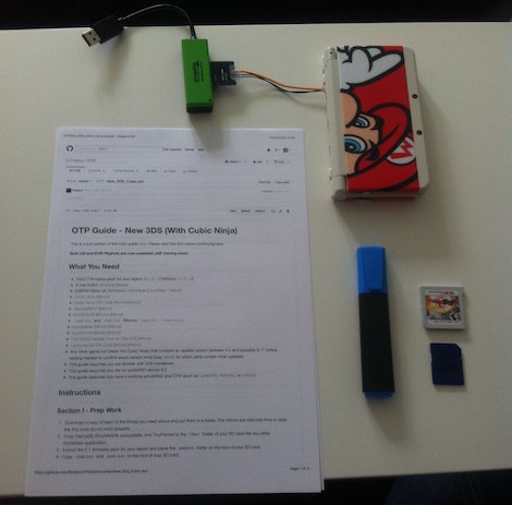

Thanks guys! I downloaded the one @ihaveamac attached above as although I could build my own, I would rather use one I know has been tested and works :)
Got everything downloaded and prepped now... My highlighter is ready :D
sooo... now that I've done what feels like an amazing feat, I am embarrassed to ask for help on how to use this with Rei arm9loaderhax.zip :shy:
Auch, you have a hard mod, just go wild :P
Think I'll hard mod my 3DS some time soon. Have some minor soldering experience. Need to find the parts to do it.
Yep, I'm going into this without fear :D
