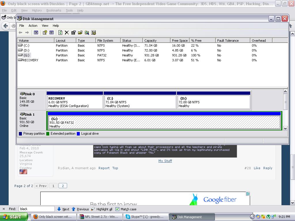

Is this what you mean?

I'm pretty sure I'm having the exact same problem.
His problem was that he had 2 partitions, and the first partition was NTFS, not FAT32.
You have only one partition, and it's FAT32, so it's fine. Totally not the same problem.
Your problem :
You are using Extended + Logical partition type.
You need PRIMARY partition type.
You can probably change the partition type using a partition manager, like Easus.
or if you don't care to re-format the partition, use the windows HDD utility (like in your picture), to delete the extended partition (the green outer's part) and create a primary partition instead. Then format to FAT32 again.

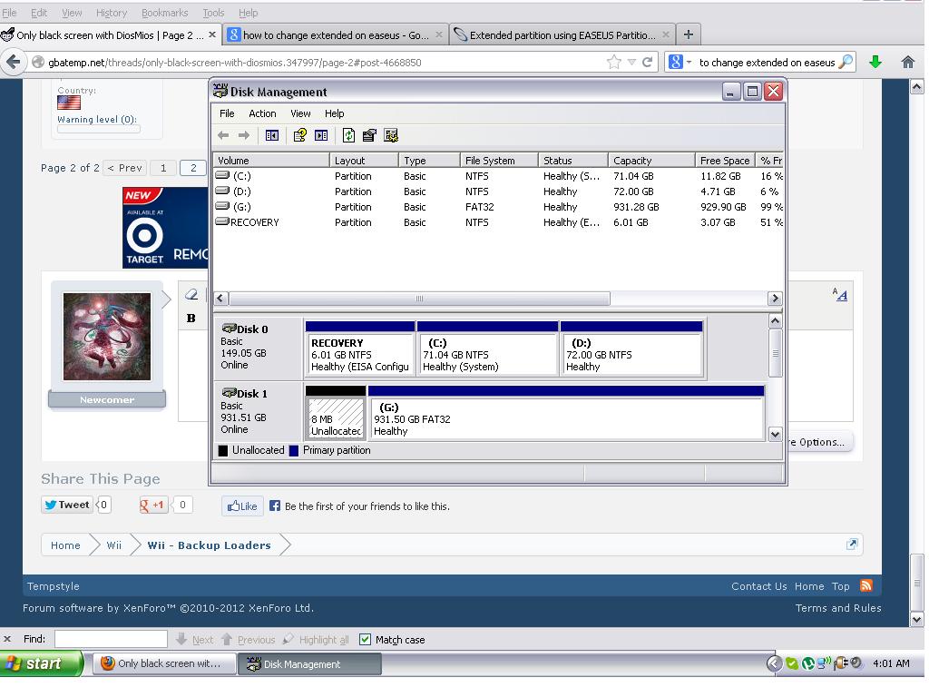

Now another potential problem: After I did that, I used Diskmgmt.msc and now it's showing an "unallocated" (partition?).
I already knew it existed, but it didn't surface on Diskmgmt until after I converted to Primary.
Would this pose a problem? I'll post another picture.

About the unallocated area:
it depends how it's refereed to into the partition table.
For information, the partition table can hold 4 partitions.
A B C D
DIOS MIOS Always mount partition A.
If the unallocated area is marked as first partition type "unallocated", and your FAT32 as second partition, then it's not working with DIOS MIOS.
A = unallocated, starting at sector 1
B = FAT32, starting at sector 16 (16 x 512Bytes = 8192Byte = 8MB)
DIOS MIOS = not working
if the unallocated area is only "not marked at all", and the First partition information is the FAT32 (but with a starting sector not physically at the start of the drive) it will work with DIOS MIOS.
A = FAT32 starting at sector 16 (the 8MB before that partition at not referenced at all)
DIOS MIOS = working
To fix your problem, I suggest you use Easus to fuse both unused and FAT32 partition into a single one, or move your FAT32 partition at the start of your device.
But you said you tried different USB devices, so maybe your problem is something else.
