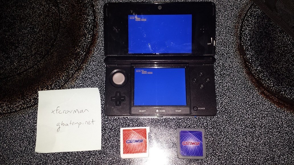

As promised, here's a pic of my dead 3DS, along with my Gateway cards. Since I purchased my Gateway in late December, I only used 2.0B2 and never upgraded from any older versions of Gateway firmware.

Here's a summary of the sad life of my bricked 3DS:
---- Never played any games before GW exploit
---- Emunand was on latest FW 7.1U
---- Wifi was mostly on
---- Used 2.0b2 from GW official download page, MD5 matched the ones posted by Gateway
---- SD brand was 2GB Toshiba (came with 3DS), MicroSD was a PNY 16GB Class 10.
---- N/A the 3DS was never used online with OFW, only with emuNand
---- N/A because no previous flash carts used
Exploited the console with the blue card and copied the 2.02b launcher.dat to the SD. Gateway mode screen boots via holding L on profile. I then backed up the nand, set up emunand, and upgraded emunand to the latest firmware. Diagnostic checks always passed (did this several times, as the Gateway would occasionally freeze when I went to DS profile).
After setup, I played Zelda Link Between Worlds to completion (about 20 hours of play time over 2 week period). I would intermittently look at some of the other apps on emunand (i.e. miiverse, eShop, etc). After finishing Zelda, I switched to playing Super Mario 3D Land. Played Mario several times, and on Jan 28 I powered on the 3DS in the morning and was bricked (No freezing or anything beforehand, I turned on the 3DS a few minutes after waking up). I didn't do anything unconventional with my 3DS (e.g. modified Launcher.dat etc), so it's unclear to me why the bricking code in 2.0b2 was activated.
I already upgraded to 2.0b1, and my old Zelda and Mario saves from the bricked 3DS are working properly. However, I might go back to 1.2 since I already completed Zelda and I don't have any other games with the latest SDK in my collection of roms. Please let me know if anyone wants additional info about the brick, and thanks for the help!
The order of events on my bricked 3DS is: Setup Gateway with 2.0b2 and emunand, updated emunand to latest firmware, played Zelda to completion. After finishing Zelda, I switched to playing Super Mario 3D Land. Played Mario several times, and on Jan 28 I powered on the 3DS in the morning and was bricked. I didn't do anything unconventional with my 3DS (e.g. modified Launcher.dat etc), so it's unclear to me why the bricking code in 2.0b2 was activated.

Yeah, it's pretty terrible and I'm sorry to hear that yours died within 30 minutes of getting your Gateway. I updated my post to match what you did a few posts back, hopefully the extra info is useful.
I agree with you that the bricking code was a really awful thing to do, legit Gateway users and clone users should not have to worry about the risk of their console bricking like this. I know that many doubt that legit Gateway users are being bricked, but at some point there will be enough of us to dispel any doubts. At least it is now possible to unbrick without Gateway, and once people have Gateway unbricking services available I plan to fix my 3DS and then sell it off on ebay. I wish you the best of luck on your 3DS, and hopefully you will have it returned soon!
