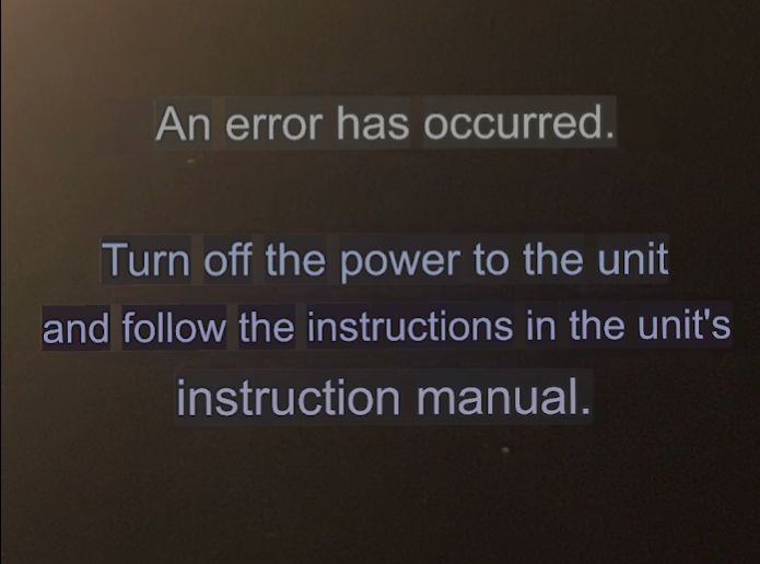

I have an old 3DS that not start any game or program about DS mode. My 3ds doesn´t start any games DS and aplications about DS. I tried with TWLFix-CFW and then update system but it doesn´t solve the problem

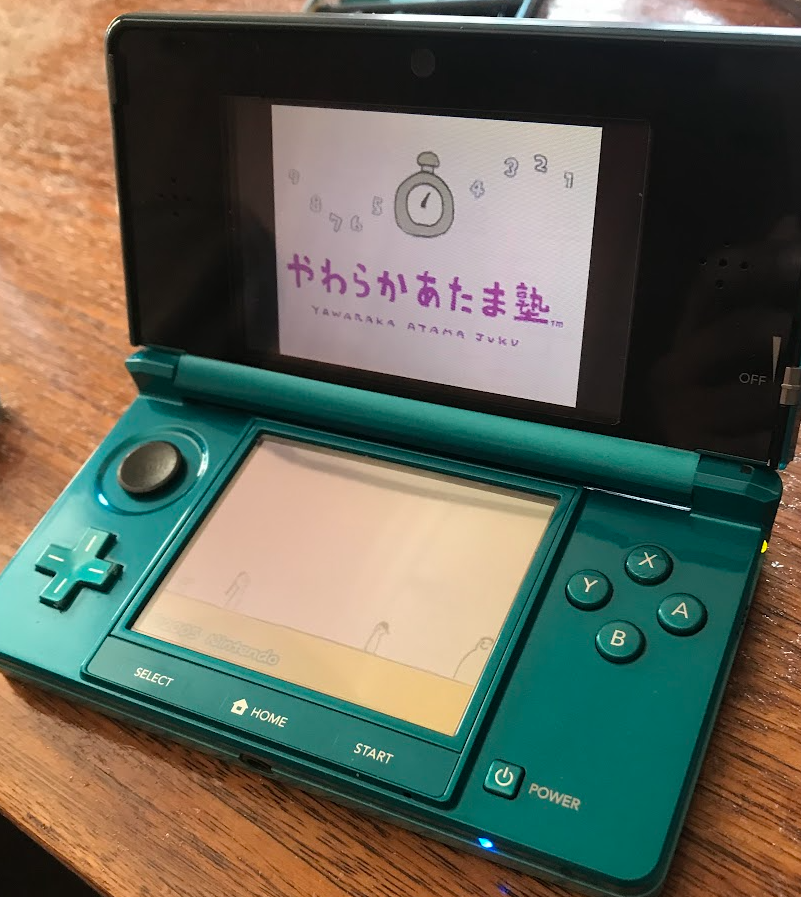

This didn't work, but i can found the problem. The problem was module WIfI in where is the NVRAM. When pass the test call ctrcheck, the program found the critical error in NVRAM, so i replace the module, and then ran the 3DS_NVRAMtool press the B button and then X button. After this i ran the TWLFix-CFW and then update the system and finally i can play my DS games.
