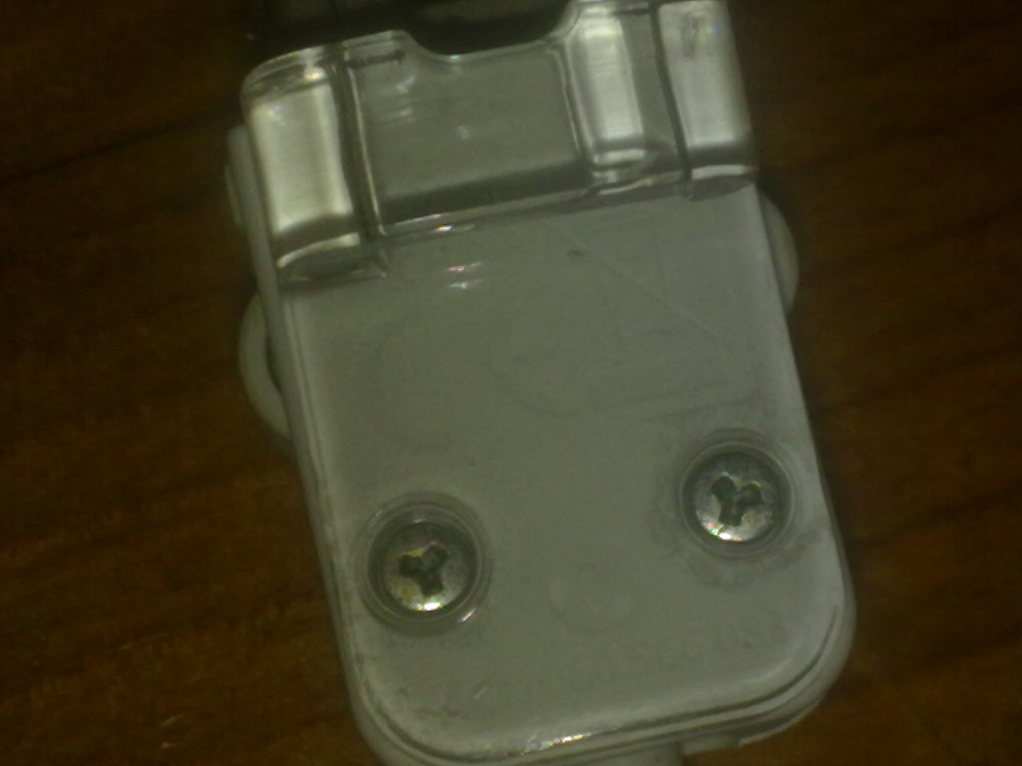

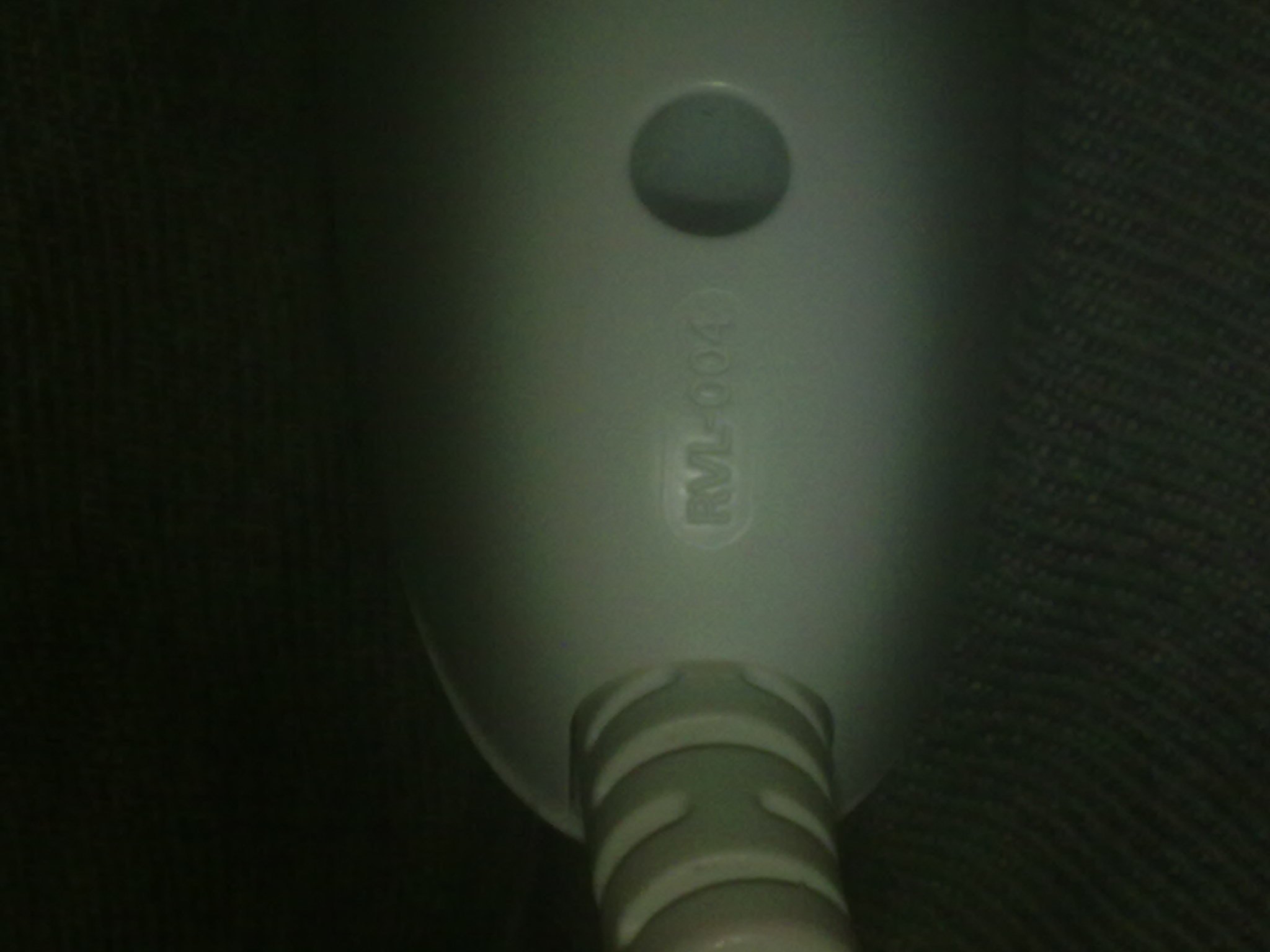

heres some details which can help you decide if its counterfeit..
RLV-004 between cable and hole
CE and trash icons or similar below the "glass" plastic (note, icons here are from an european nunchuck, i am not sure if they are universal)
usually counterfeit mafia will not care about these details...

@kokota
thanks for letting me know, i thought counterfeit stuff didn't care about thoose little details...
btw i will just open this nunchuck and check about glue...
edit: nice, nintendo uses a pin connector instead of glue...
edit 2: nice, a ferrite bead connected to a wire on the cable, this is high quality stuff...
for curious people heres a picture:
