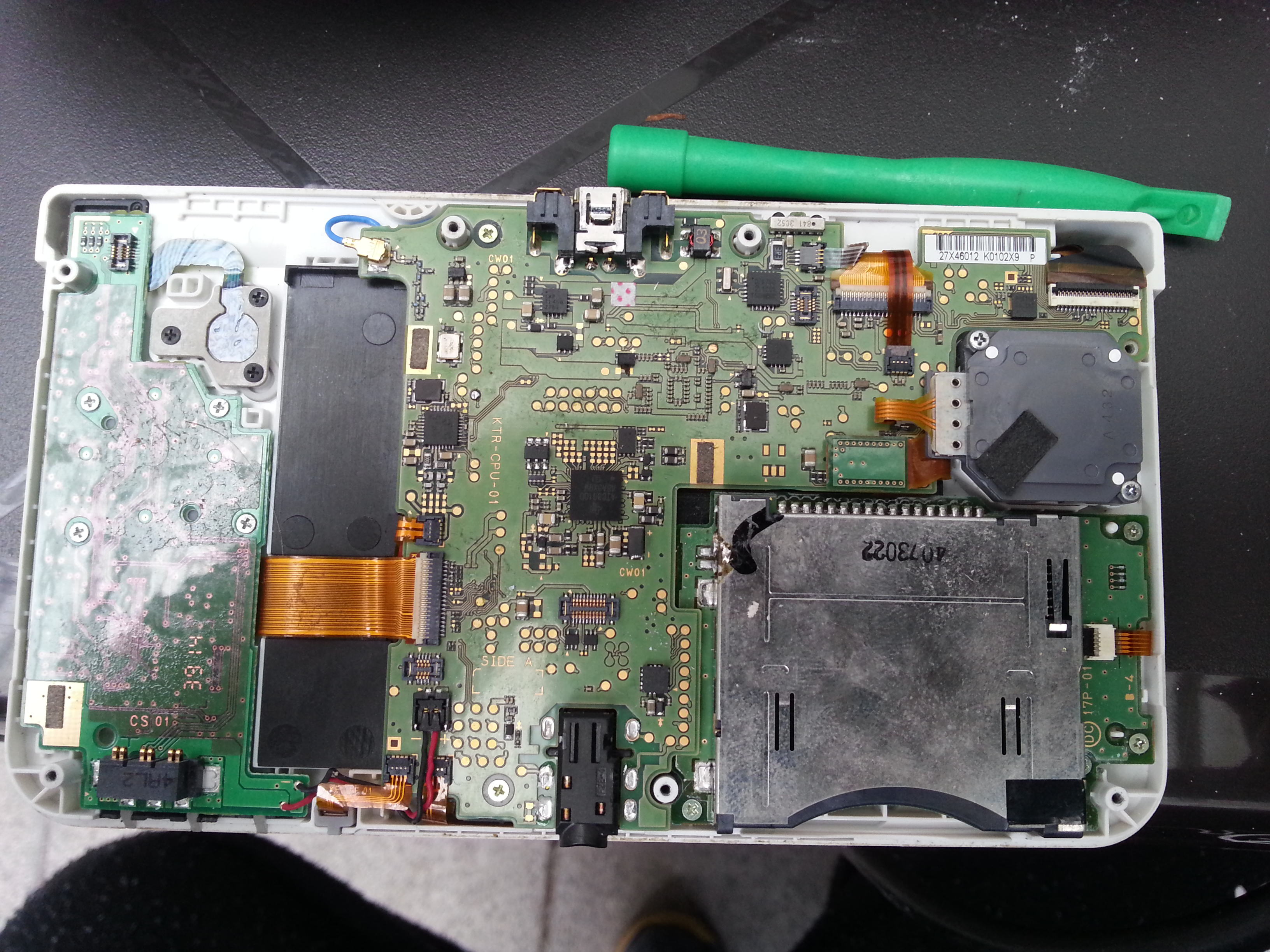

@leerpsp i solved my problem now with some luck and patience!
ive tried to hardmod this console so one cable wasnt attached right. now i csan gm9 straight from my flashcard (thanks to the guys on discord wich gave me a flashable firm!)
now i cant do a ctrrnandtransfer, time to do some more research....
What cable was it? i have taken mine 100% apart and put it back together 3 times and still did not work out for me.
i cant say but none of the screens. a small one at the top of the mobo between the two screens i think but im not sure. tomorrow i will make a photo (dont have a smartphone with me now) sorry
ok that sounds good.
so here the pictures i promised you, i hope you can see everything. in one of the picture the cable isnt inserted right.
