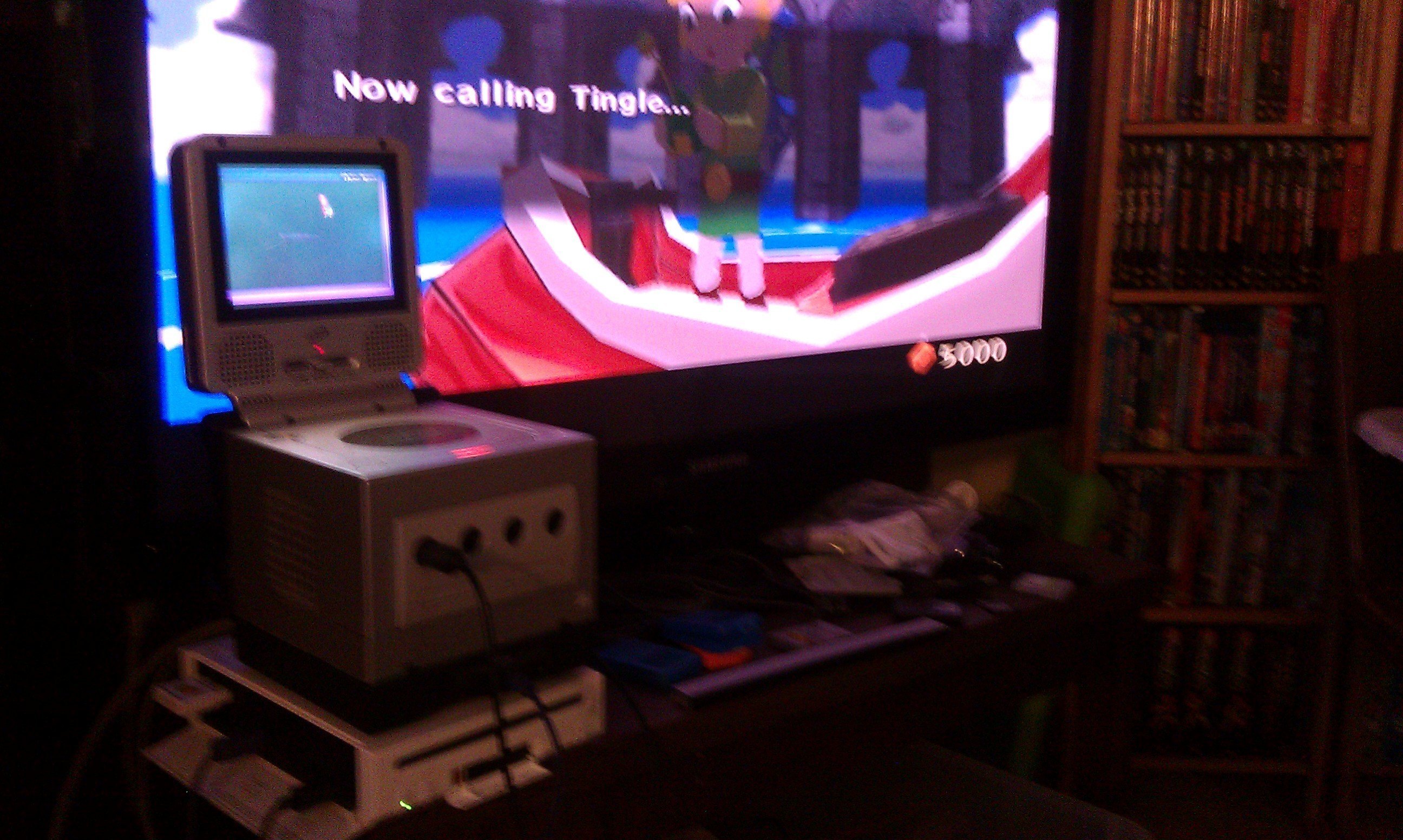

Is that an entire Gamecube acting as a GBA?
Gamecube + Gamecube Gameboy Player + GBA cable + Intec Game Screen = Unnecessarily large GBA. Although I could have hooked it up to another large TV, but nobody wants that much Tingle.
