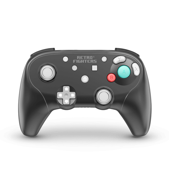

Just passing by to say that Retro Fighters BattlerGC works on Nintendont using Mayflash Magic NS adapter on dinput(PS3) mode.
Just paste the 0079_18D2.ini file on your SD:/controllers folder and you are good to go.
