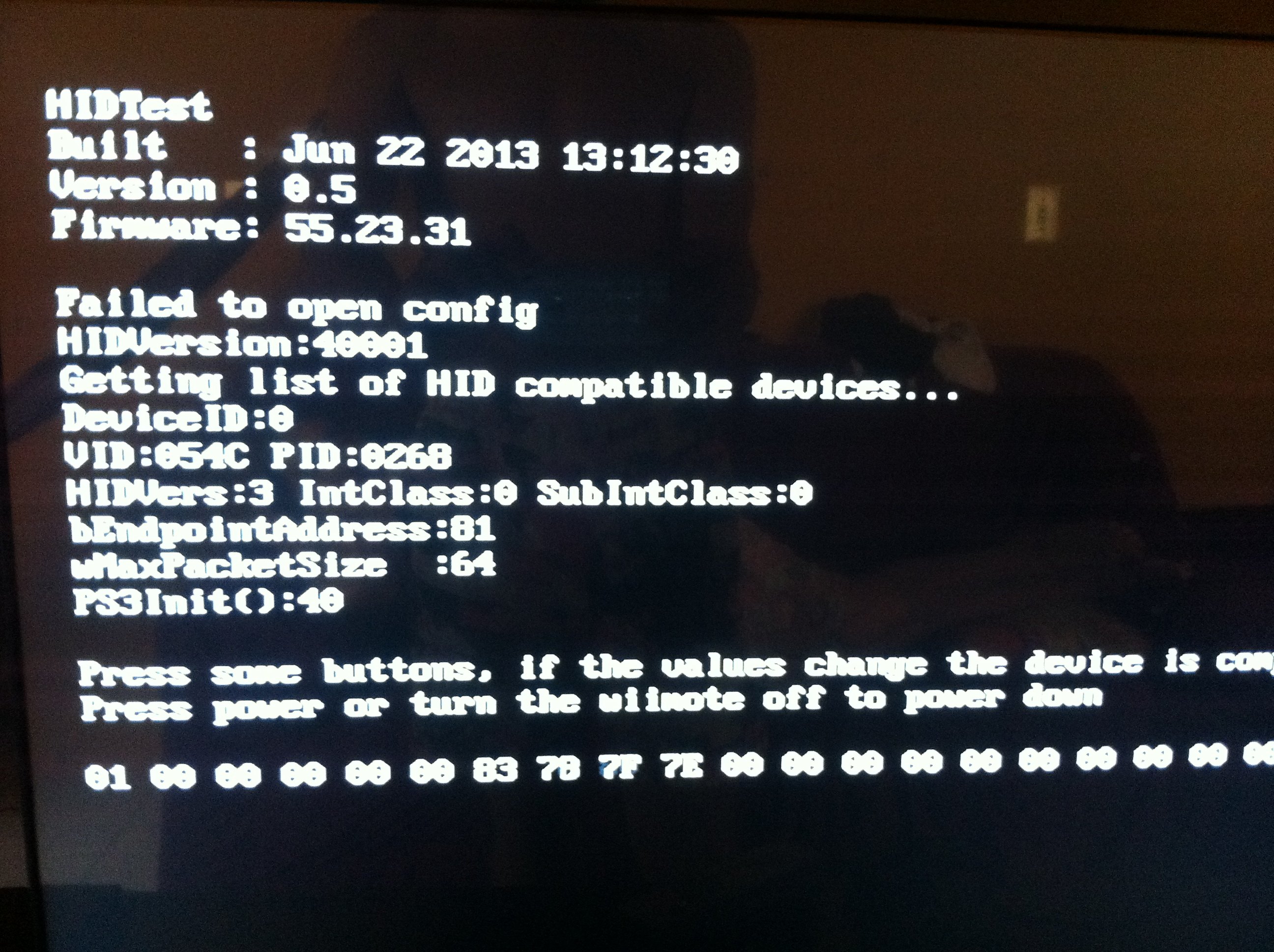

always have the same problem in HID
does not recognize the control, already tried usb ps2 and ps3 but whenever control of it. what could it be?
someone help me please.
