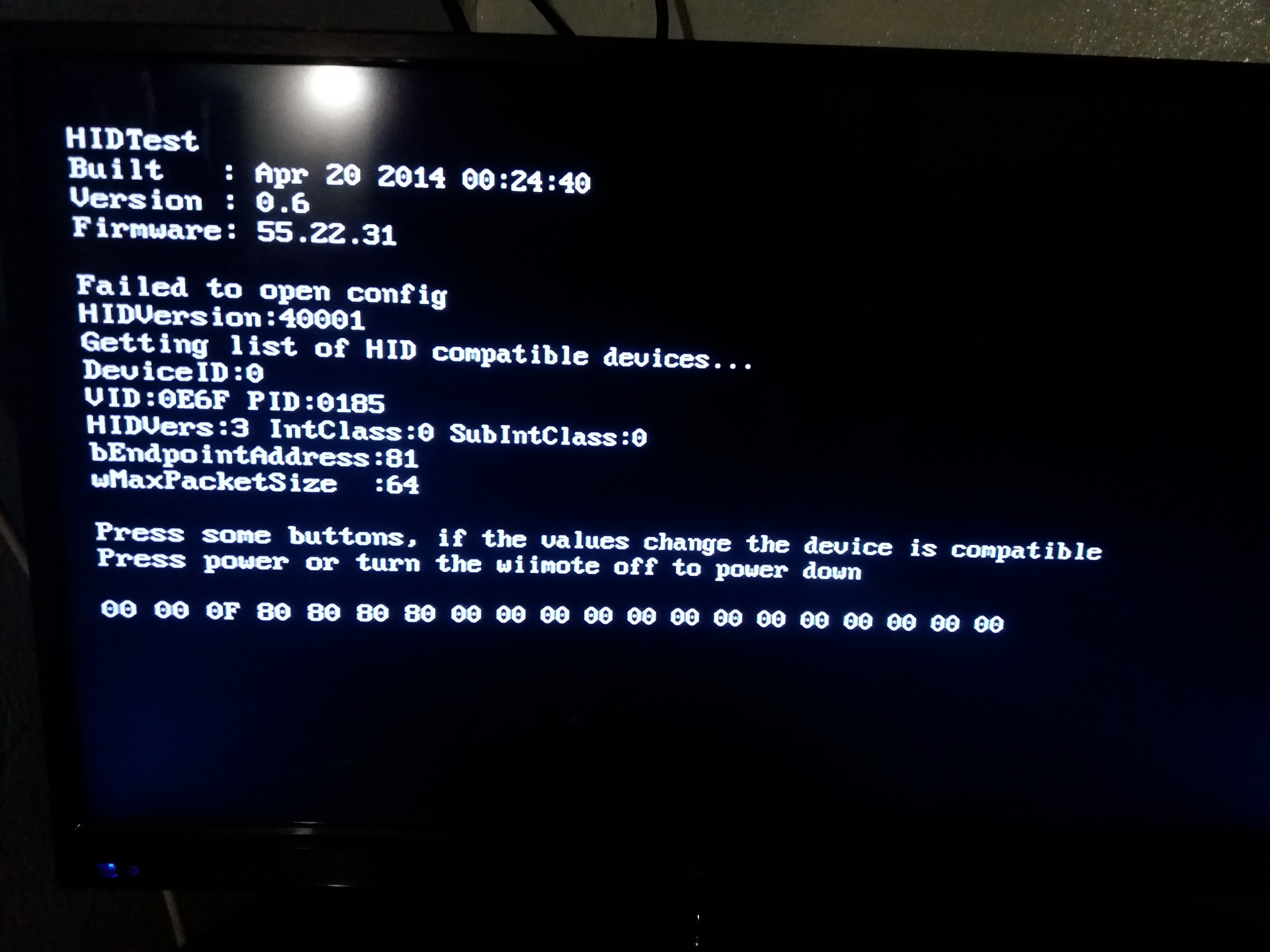

1. Plug your gc controller in a usb port.
2. Run the HID_test_6 homebrew from homebrew launcher on vWii
3. Take note of the offsets you get and add them to a controller.ini according to this guide.

Yes I did, I have to install the HID test and load it on homebrew channel right? but it is for wii or vwii (I have wii)
It works on both. I didn't see you said you have a Wii, but the procedure is the same. I edited my post above with a short guide.
Good, the fact that the numbers change means that you have a nintendont compatible controller. Enjoy!

ook now I have the values, Ill try to create a .ini now

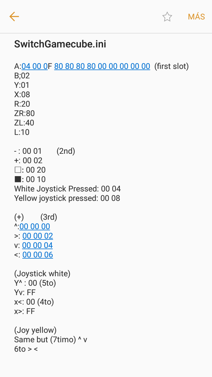

View attachment 186403 View attachment 186404
Nice, you have the info you need.
Now follow this format to make the .ini:
VID=
PID=
DPAD=1
A=2,01 <- 2 is the pair, so the offset. Going from your pictures, for you this should be "0,04"

StickX is the left-right direction on the white stick and CstickX is the left-right direction on the yellow stick.

Wait I just noticed you can press your joysticks? I guess yours is more than just a usb replica of the original gamecube controller then. If you want to register these buttons, even though the gamecube doesn't have them but nintendont can use them to reset the system, you'd have to add these two lines:
RAnalog=
LAnalog=
Just add them at the end of your .ini.
