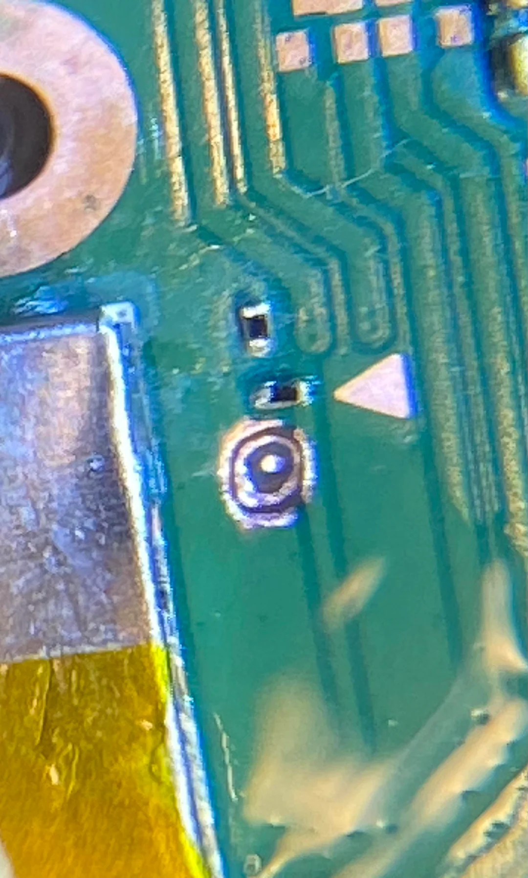

I recently tried kamikazee and i think i pulled out the wrong trace and destroyed it. After the trace was destroyed , the nintendo switch does not turn on. I plugged it into a usb charging station that tells you the amps and charging, it reads .045 mah when charging, but it does not do the .045 mah , 0 mah drop that happens when the switch loads into the SWITCH load screen. It stays in .45 mah, can this switch still be salvaged?

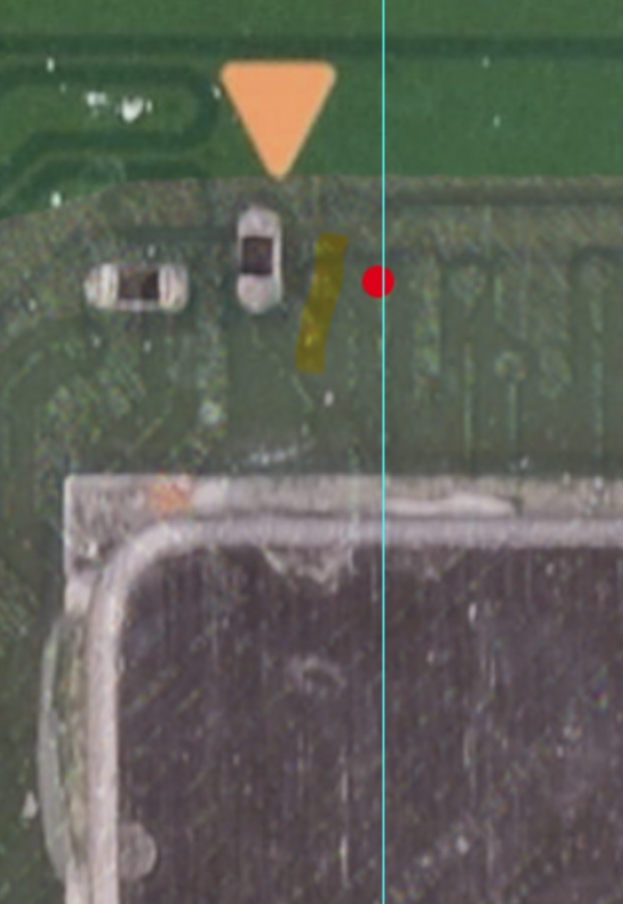

You seem to be a bit too much to the left :
A skilled repairshop can fix this for you.
They will do some more kamikazing to expose more of that layer to reconnect the damaged trace.
But you seem skilled enough to do it yourself.
I just got this link last week from another user here who pointed to the OLED information with all the layers and stuff :
https://files.zzattack.org/index.php?dir=img/console/switch
In doubt, just send the picture to the picofly thread for advice.
https://gbatemp.net/threads/picofly-a-hwfly-switch-modchip.622701/page-814
Hope that helps.
looks to me that your solder is shorting to the next layer's ground plane
MORE like you broke the dat2 on the left
thanks you, yes from the diagrams i have recieved from people, Yea the Dat2 communicates to both the GPU and EMMC and is the reason why it wont turn on or show booting voltage on while charged. I am waiting for the wire to solder and connect the line.

thank you very much, forgot to update but I am waiting to recieve the wire
problem solved, all I had to do was repair the trace DAT2 which is connected to GPU and EMMC, without communication no booting. Now everything boots and works fine, mod chip installed. thanks every one for the tips and help
