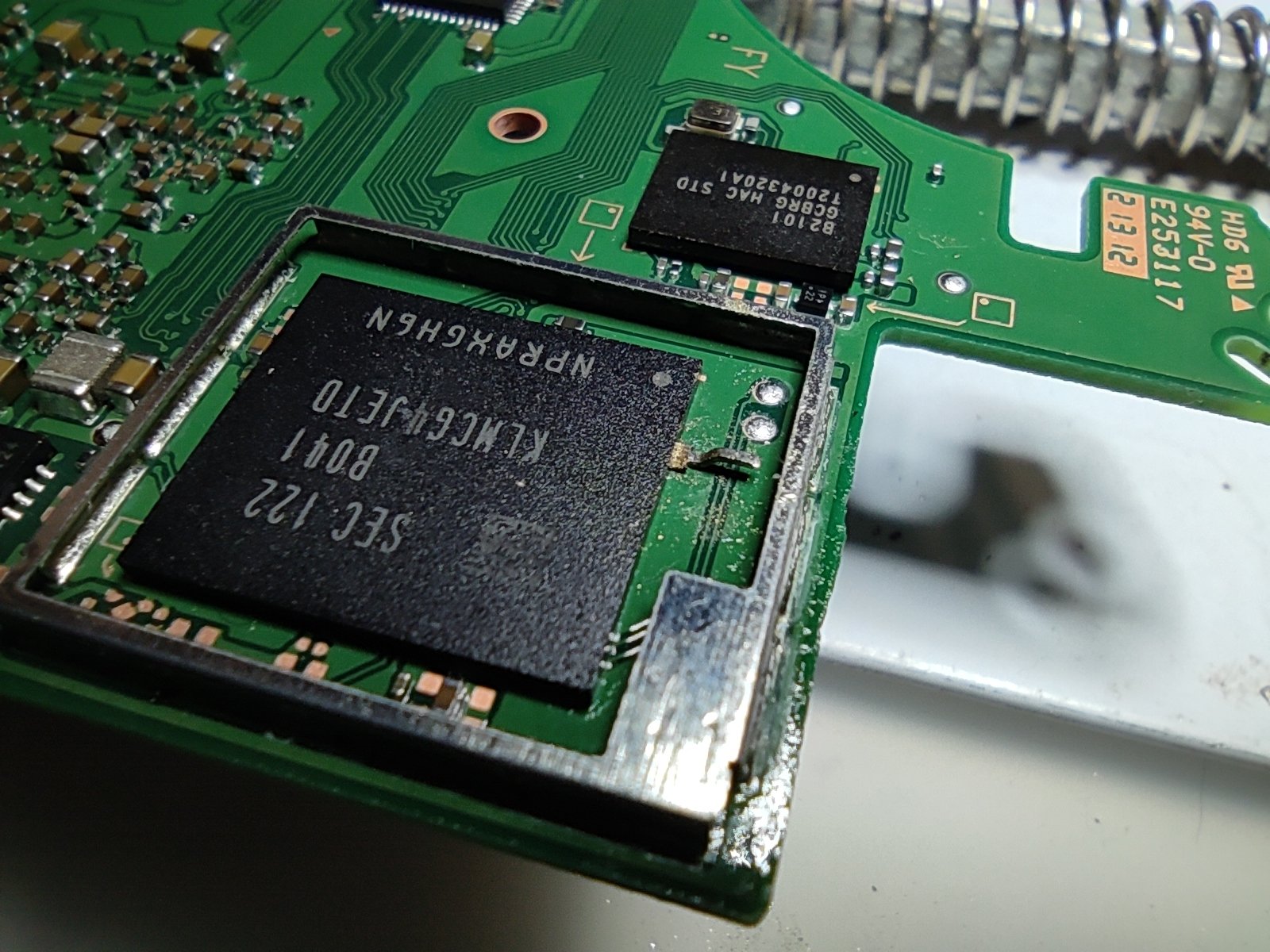

I don't follow you. From the pics from Shigenojay, there is a metal jig thing that slips under the chip and makes an easy to access solder point. Where can I buy this for a modder to use to a pod having to pull/reball the chip.

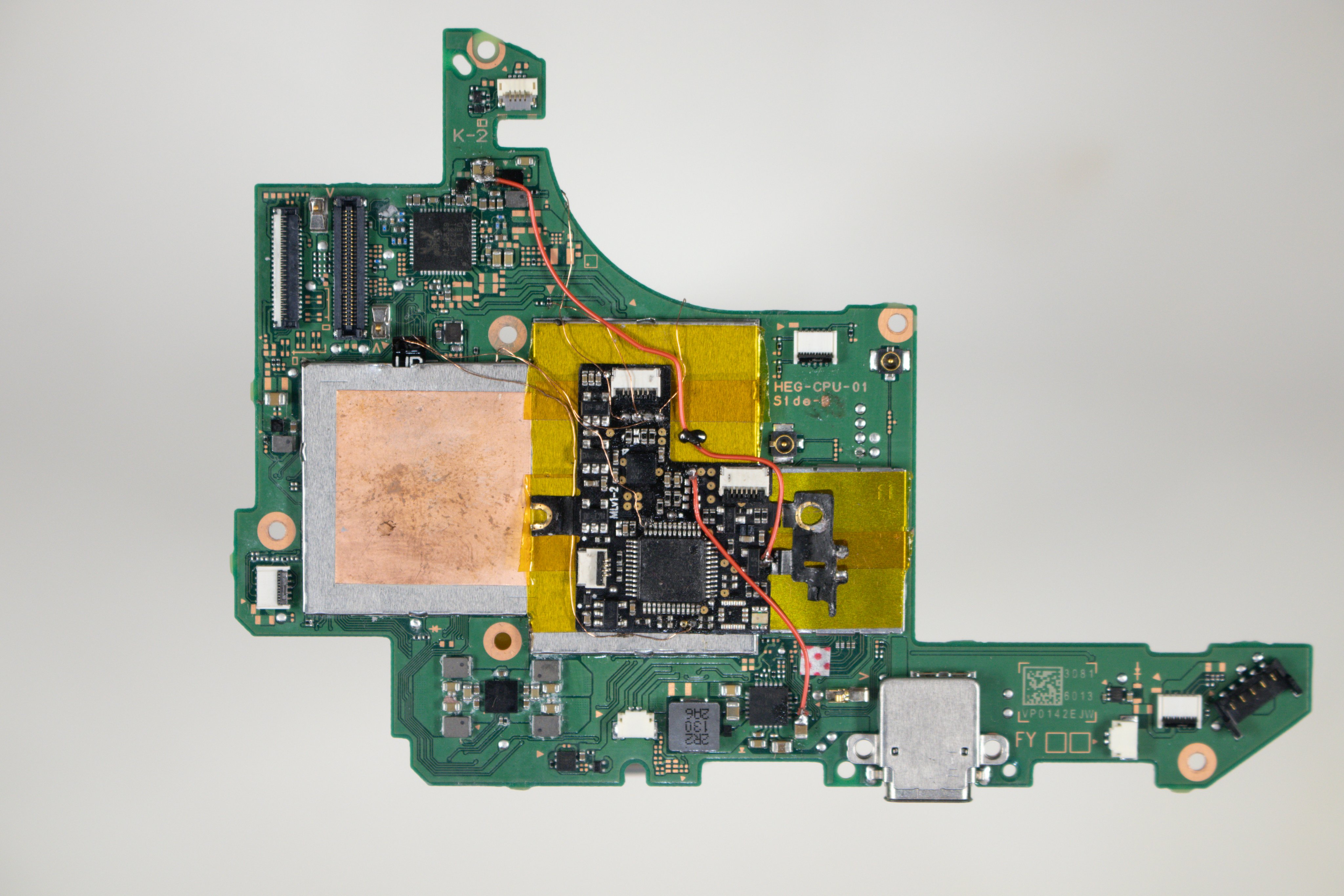

From the vids/comments of the users who successfully modded an OLED, only one has stated they used an SX lite, so I guess the hwfly lite should be ok. That's all I can find on AliExpress for now.

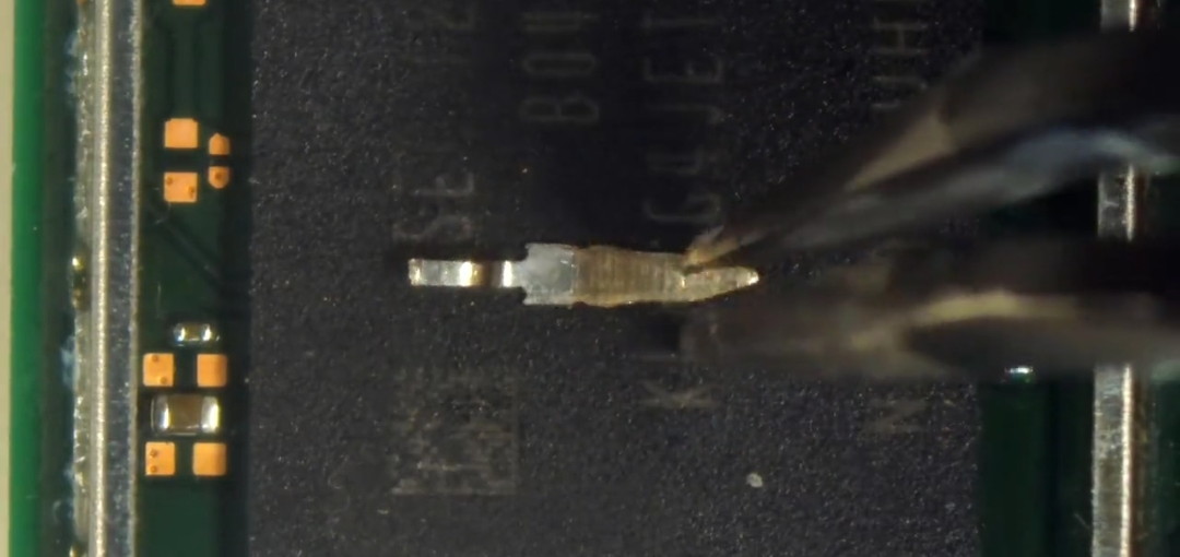

Where can you get this D0 point adapter/extender tool? How does it stay in place and not bump other points?
Also, did you use hwfly lite chip? Core V2? V3? Still need to buy the correct one. Don't want to find out it won't work in the OLED.

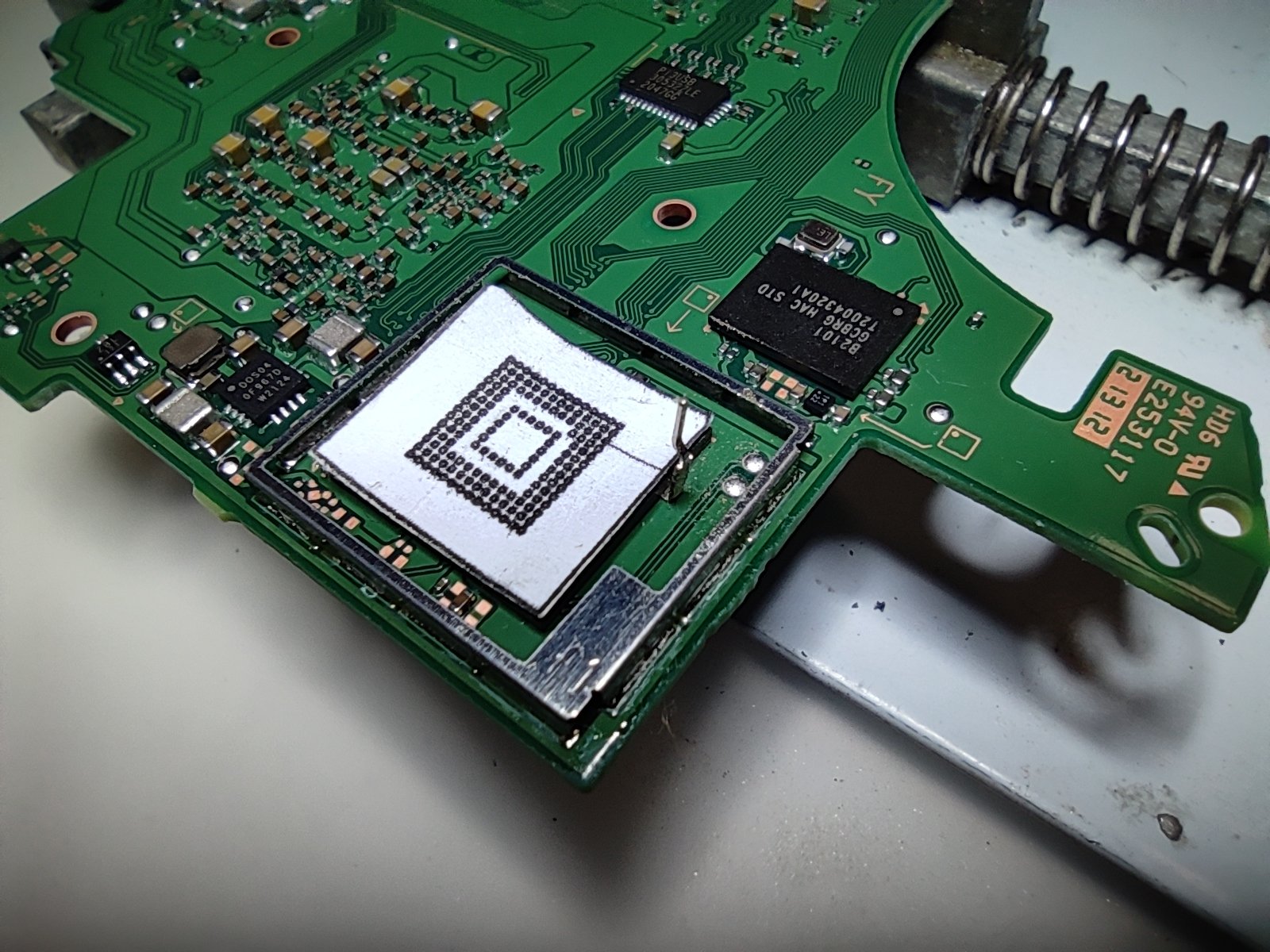

i use D0 point from the SATA socket it is tiny and thin.i have emmc from other switch and i point where the exact pin.
Genius using the stencil to get the location of the pin. Did you reflow it afterwards?
no reflow or reheat.I used another emmc chip as a template, I put it on top of the current emmc chip, and I aligned it using a jumper wire.
