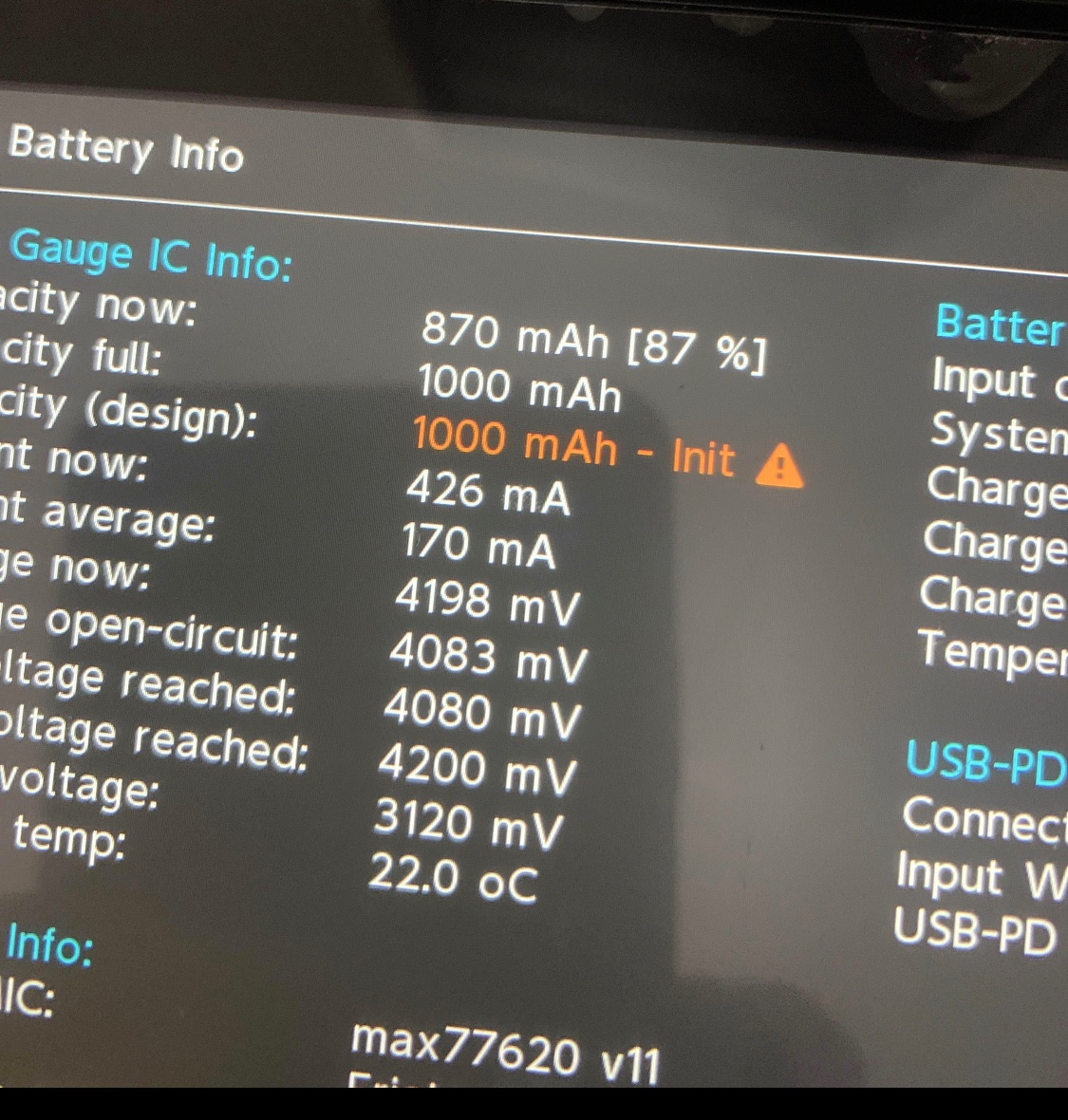

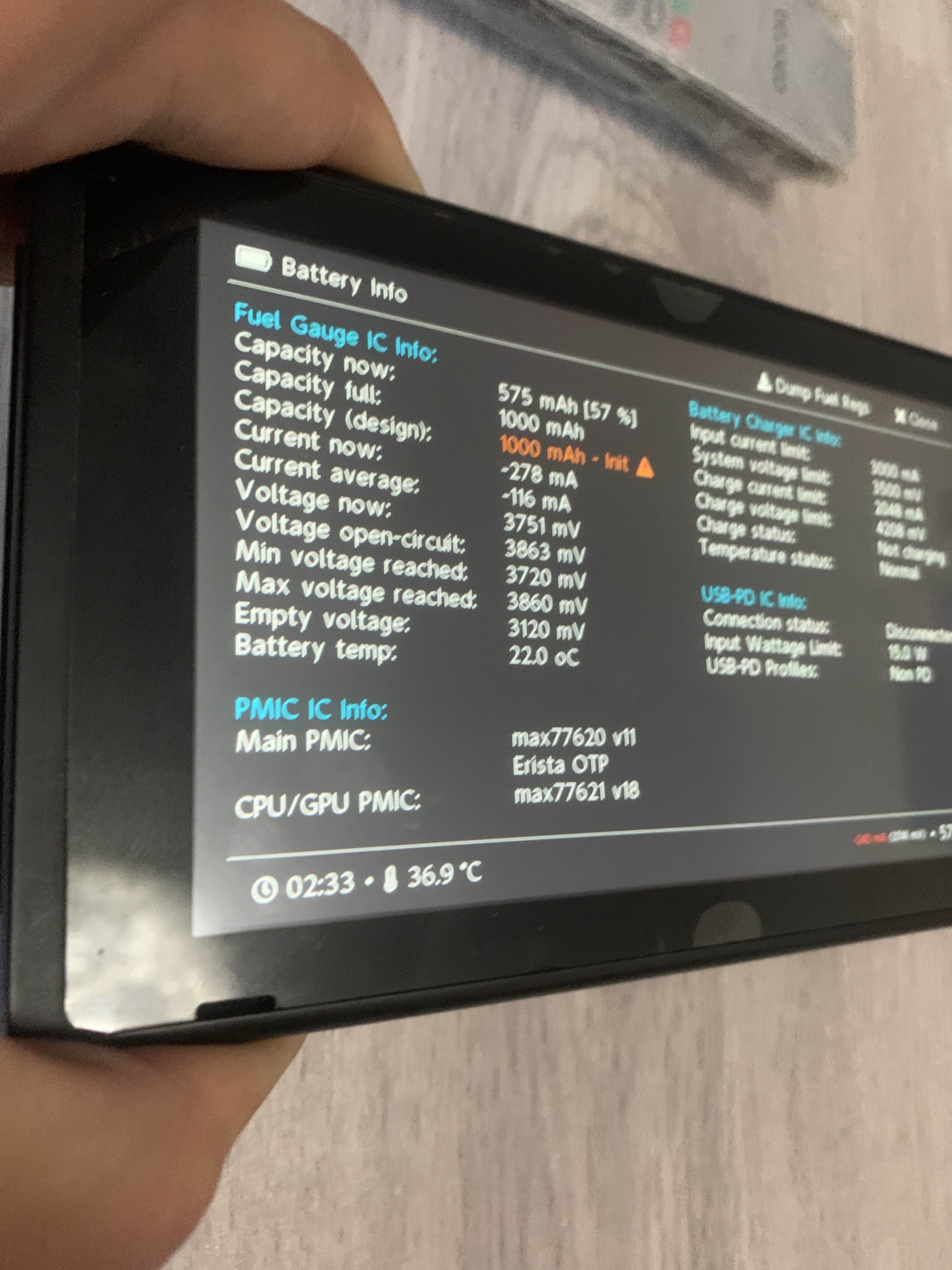

Hi i have a question is my Maxic17050 which i replaced working or is it false or broken again ?
i have that picture but my console booting only up to nintendo logo than its stays on 3.3v but not boot to nintendo main menue
I have here a missing M92T36 the tests are without that M92T36 Ic

That 1000mAh battery size is a bit weird but maybe that needs to be calibrated.
Someone wrote a homebrew app last month for that I vaguely recall.
The M92T36 takes care of (fast) charging so that should not impact those readings anyway.
But the rest looks fine to me.

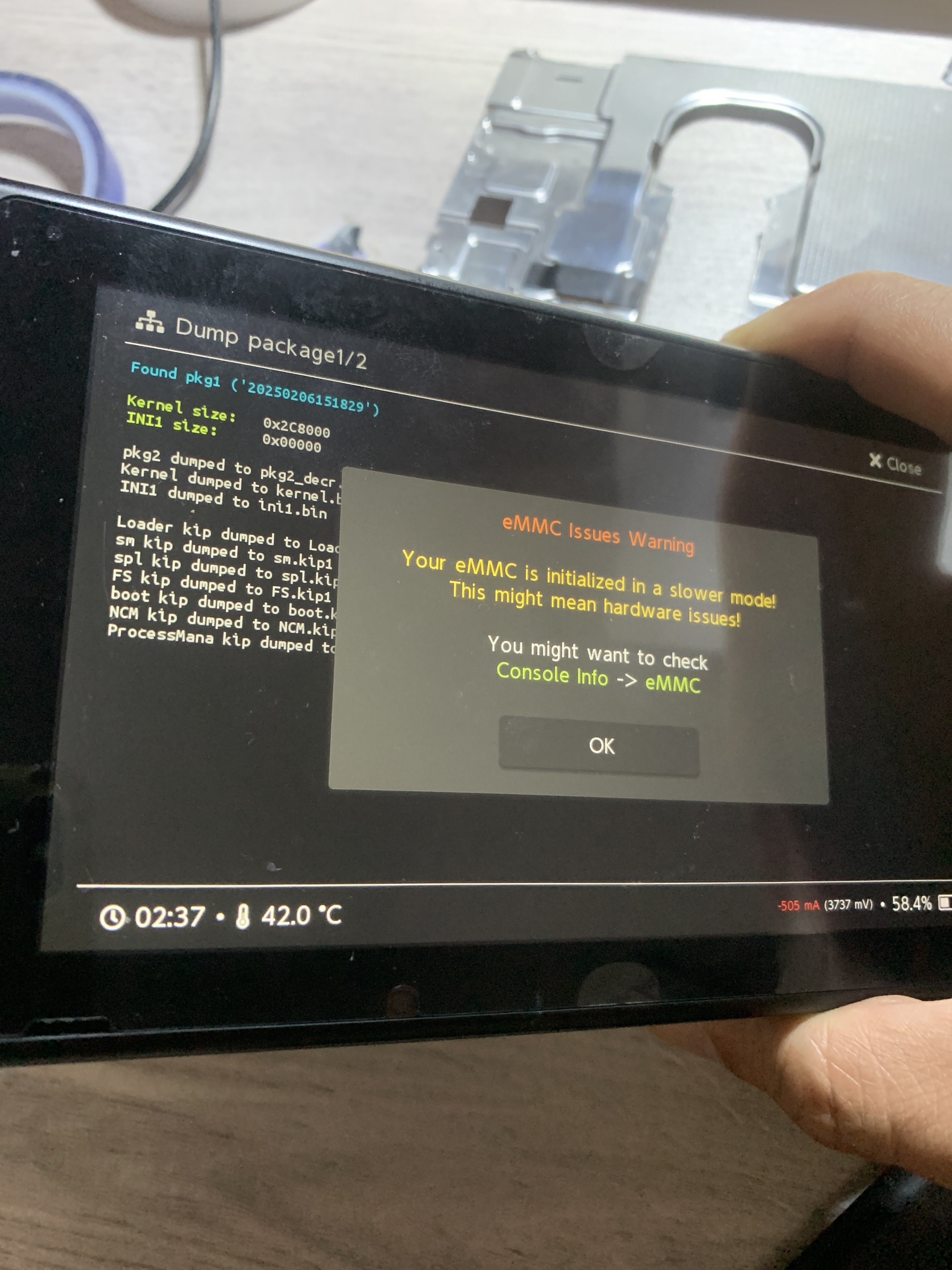

You might want to reball /reflow your emmc for that second message.
They wrote for setting max voltage, not for design capacity.
Hekate has explicitly stated that exactly 1000 mAh (not any other value) is an issue.
https://github.com/CTCaer/hekate/bl...cfc77dc/nyx/nyx_gui/frontend/gui_info.c#L2402
So it sounds like it is known and must be fixed on your side. But dunno what exactly you are supposed to do.
According to commit:
An icon and reason will be shown if design cap is 1000 mAh, which means that fuel gauge was reset and HOS not booted at least once.
So I guess fixing your emmc will also fix battery issue.

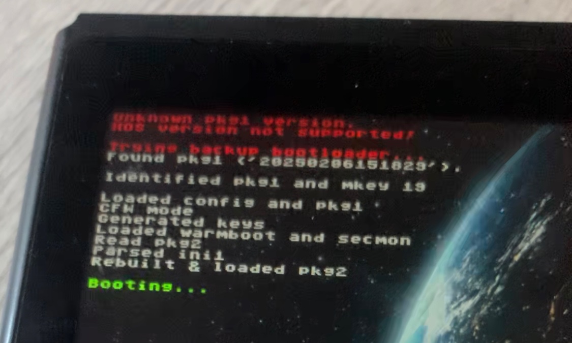

that is rightly i never can start to hos because it stucks on nintendo logo and a m92T36 Ic Chip is missing on the board is that stuck on logo because it missing that ic ?
I cant start to hos
It is a Erista v1 unpatched console

I cant start to hos
Yes, that is very likely because of the missing chip. That is a safety measure Nintendo added to prevent the Switch from catching fire.
it that a emmc problem ?
In many cases it is a problem with one or more solder balls of the emmc not making contact with the PCB anymore.
Unless you have some (deep) scratches somewhere on the PCB.
If you are planning on using an emummc, then you can just leave it like that.
The emmc will be 8 times as slow but since it will only be used during the boot you won't notice it.
Only when preparing the emummc you have to wait 8 times as long.
The emummc runs off the SD card anyway and not impacted by this issue.
Reflowing sometimes solves it but it depends on how bad the situation is under the emmc.
