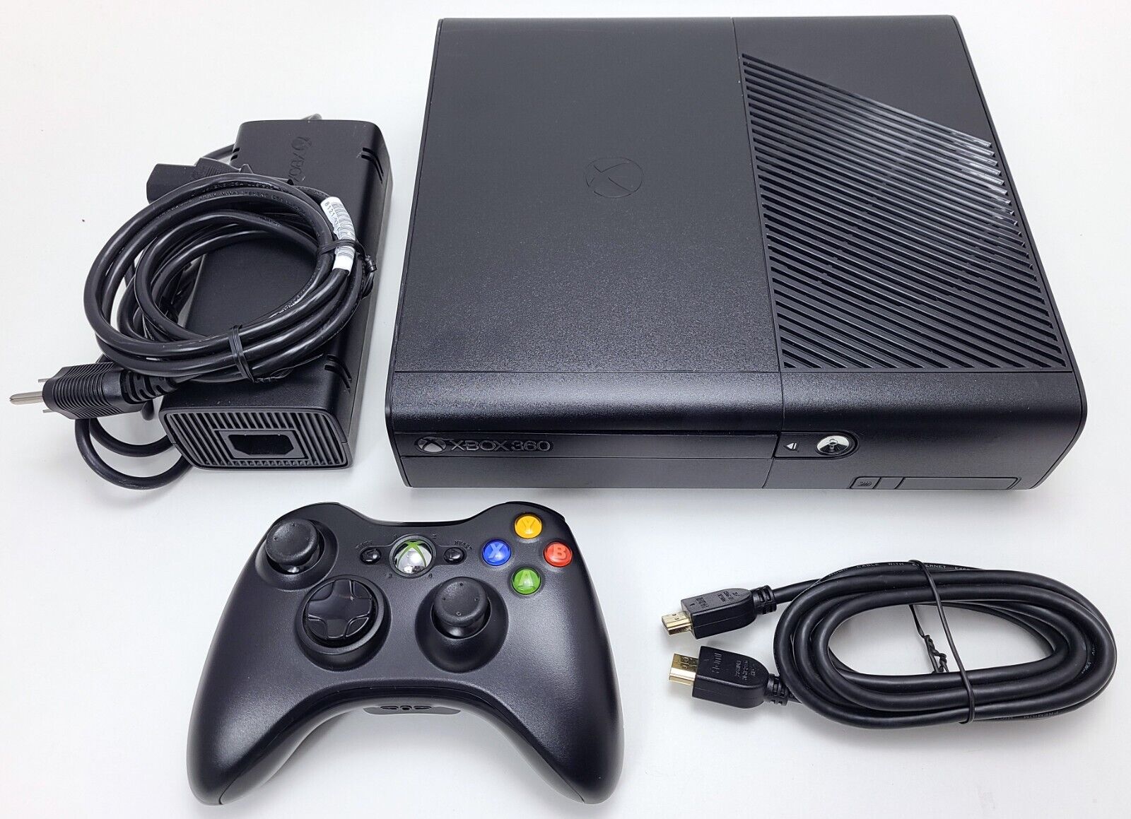

will get an x360 now. soldering scares me and i was always hoping to get a softmod. cool!!
The 360 that looks like an Xbox One is probably the safest one to get? I mean, no RRoDs or whatever.
Do those still have power bricks? Let me check... Unfortunately, yes.
And it's called the Model "E"
