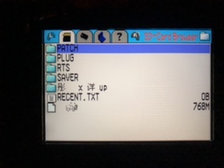

Hey there! First time posting. I love this theme, but just ran into an issue where all my saves got erased and everything else on the SYSTEM folder. I got everything replaced, but I have an odd folder with Chinese characters and a file with garbage text for a name. Are they supposed to be there? I can’t open either the folder or the document.

Hey, there! Looks like your folder got corrupted! This is actually quite common with this flashcart if you're not careful! It's happened to me too once or twice already!
Make sure to regularly backup all the folders (except the ones named CHEATS, and IMGS), and do what it says in the official Omega guide, I believe, wait five seconds or longer before turning off the system after it saves. Ten seconds to be perfectly safe, still not a long time to wait.
It can corrupt your ROMS folders too, not just SAVER folder saves. (Happened to me, and it was really annoying!) Be careful! You'll have to format the card. Sterophonick, the creator of this theme, is an awesome guy, he might be able to offer more advice! Peace!

Thank you! I'm going to try reformatting the card and re-adding all of my games. I ran into this problem the other day - I tried loading a game and somehow it got hung up trying to create a save file, and the omega deleted all of my other save files. That was a sad moment :c And I always do wait the 5 seconds!
My RTC battery was only soldered in by one leg so it was constantly shorting against the PCB and losing time; I wonder if that was a part of the cause of my woes. I reflowed the soldering so now it's nice and secure, and I'll see if that improves the stability of my cart...
Thanks again!

My card is actually a relatively generic 4GB Toshiba microSD card that I believe came with one of my 3DSs somewhere along the way. It is formatted and confirmed working in Disk Utility :)
