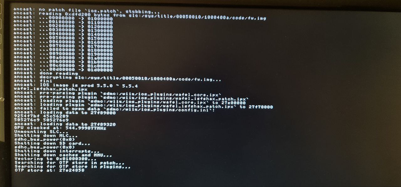

I believe i am doing something wrong, the console stops at the point in the image after I select Patch (sd) and boot IOS (slc) @SDIO a little help?
is it normal that the MLC and SD Card shuts down?

Can you show the crash log? And also try downloading and copying the ios_plugins again to the SD, maybe one of them got corrupted.
Also you don't have the lastest OSv10 installed. You can also use JNUS to download the latest OSv10 title 000500101000400A and take the fw.img from that, rename it to ios_orig.img, put it on the SD and chose the minute entry to boot that. Maybe a patch doesn't line up with the old IOSU and causes the illegal instruction crash.
Also make sure all the wireless modules are connected.
Also check if it writes new logs, to make sure we are not just seeing an old unrelated log.

I tried to download all the plugins again same thing, here are the logs, meanwhile I will try to download the latest iosu version

I mean the 3 wireless modules of the Wii U, attached to the Mainboard (BT, 2.4GHz Wifi, 5GHz DRC)
If I look at the latest log (41.log) I see that it is crashing because of corruption on the mlc:
00:00:05:468: FSA: ### DATA CORRUPTION ERROR ###, dev:mlc01, err:-1245211, cmd:25, path:/sys/title/0005001b/10050000/code/app.xml

Try to boot again, then dump logs again and see if it wrote a new one

attached the new ones

Yeah it crashes because of the MLC error.
So either replace the eMMC, you can ask @V10lator for a NAND-AID or you can use redNAND
