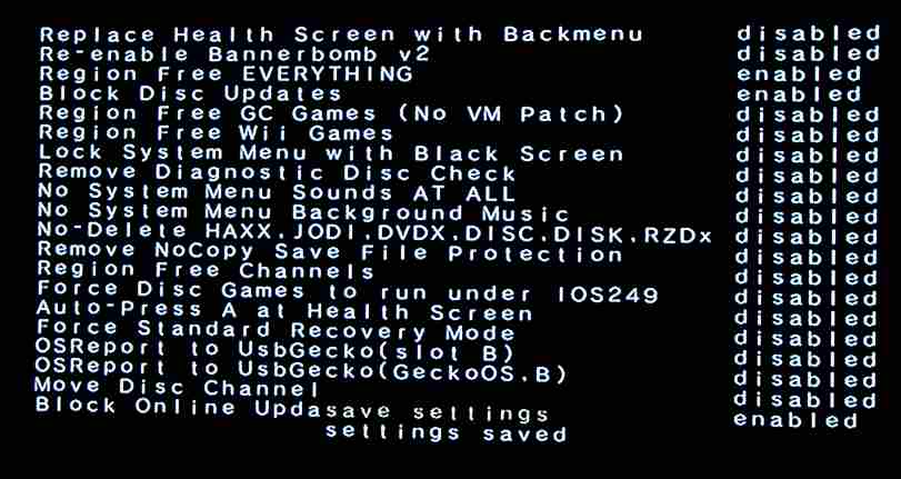

I use an NTSC Wii, but it doesn't accept RGB picture, so I changed it to PAL 60 to get it, the problem is that the games now run horribly and the sound is a mess. Is this a common problem for others too? What might I be doing wrong? I know there are a lot of other setting there.Mayeb something else need to be fixed, anyone know?

I'm loading them as I would with any game. Either through their discs or through clicking on the ones downloaded through Wii Shop Channel. I have no idea what a Syscheck is, but this is how I did it and these are my current settings: https://imgshare.io/image/20191126-053828.hnHcK

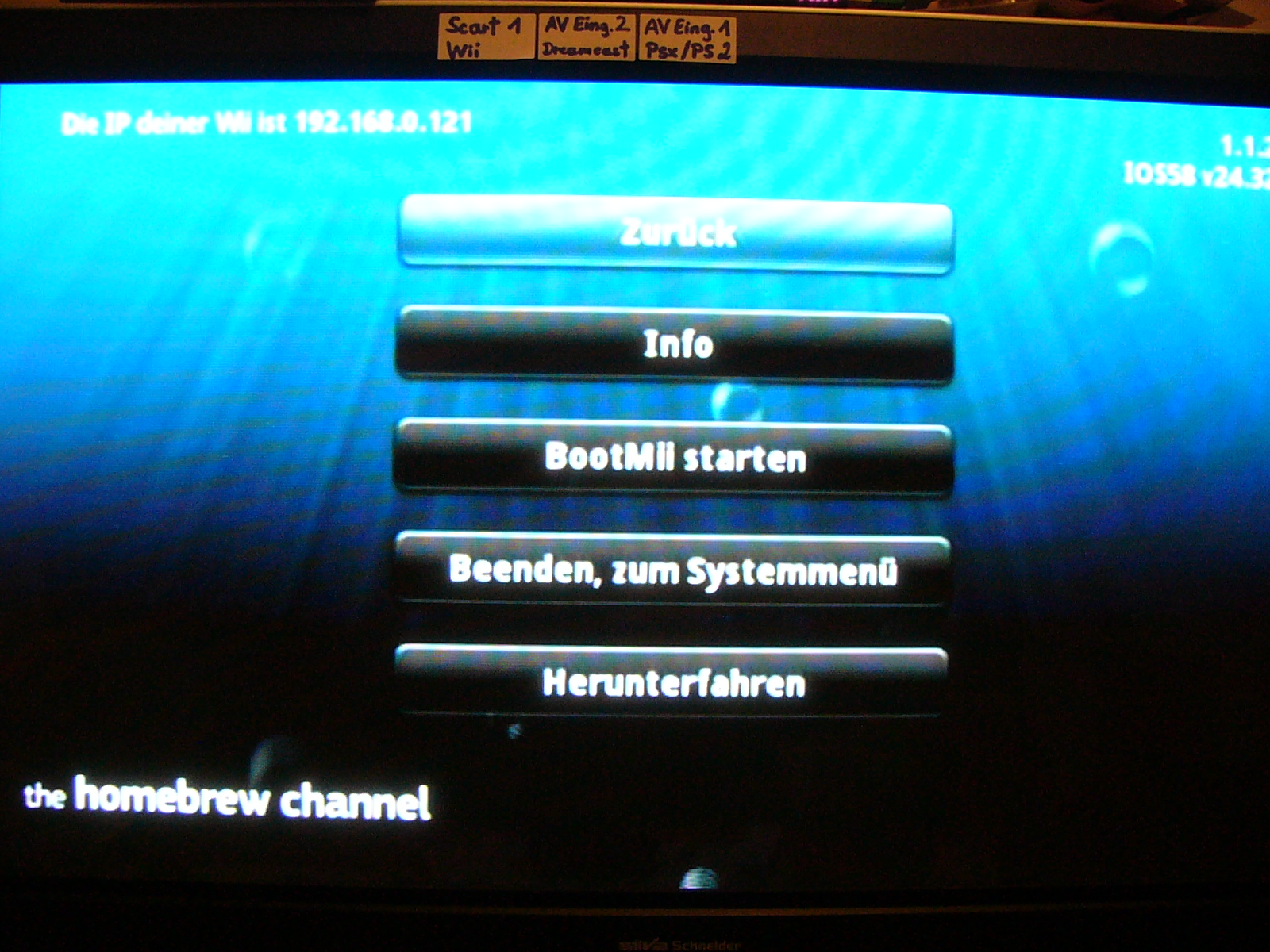

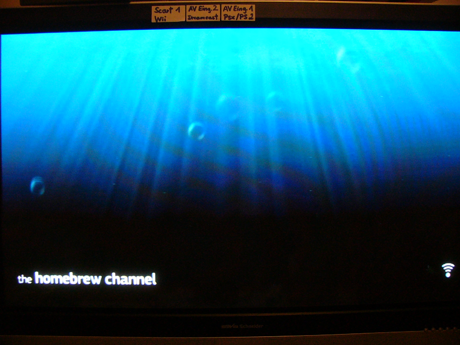

Did you try different Games or comes your Issue only on specific Games please ?
For your Wii:
- Do I understand it correct,it IS softmodded ? Do you know how ?
- Is an SD Card attached in your Wii´s SD Card Slot ?
- You have an HOMEBREW CHANNEL but no Applications on it ?

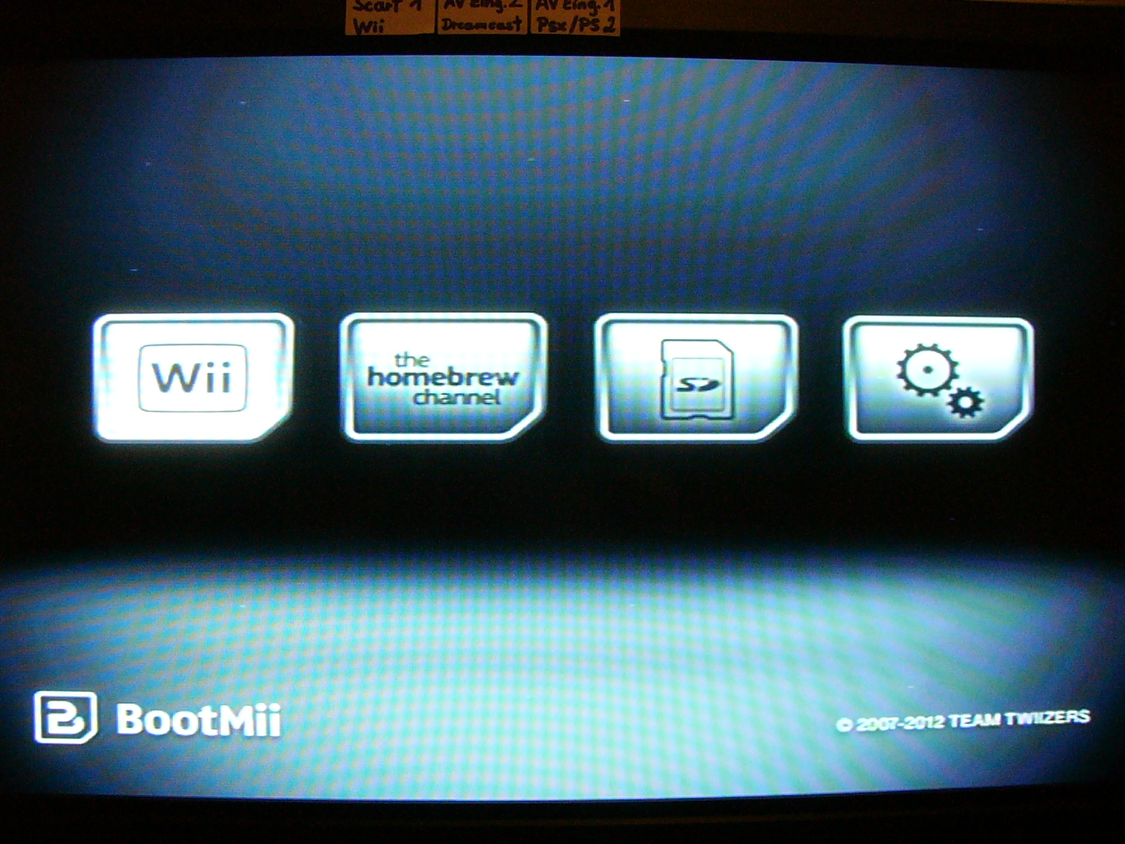

- When you press the "HOME" Button on the Homebrew Channel,can you boot into BootMii ?

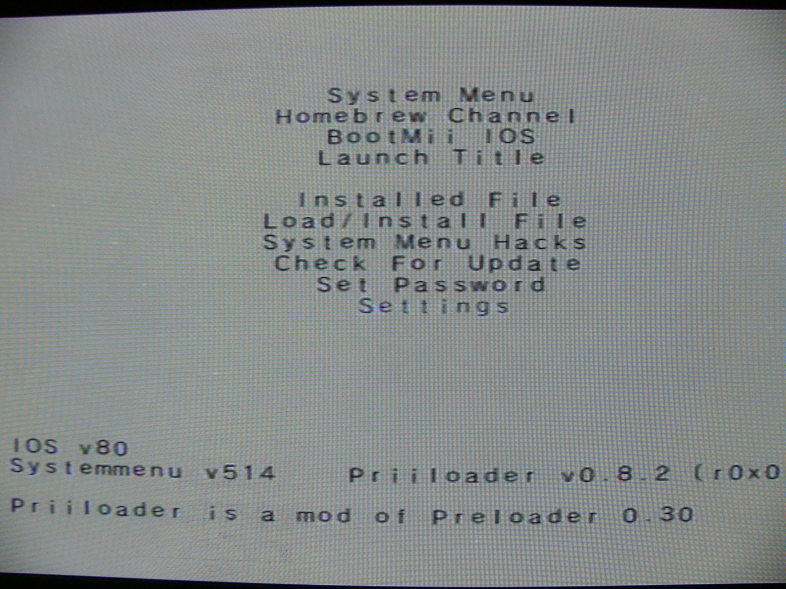

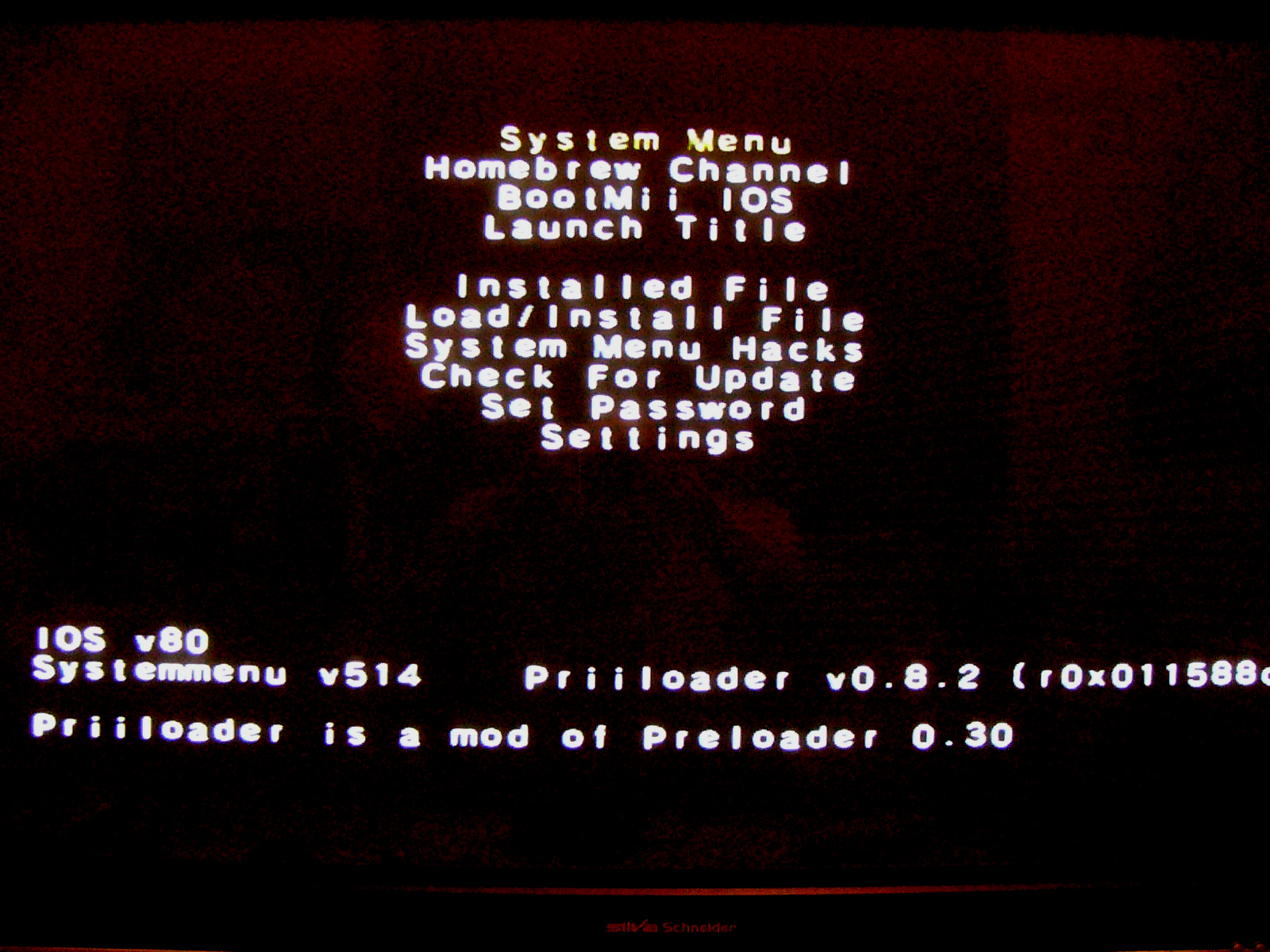

- When you press and HOLD the RESET Button on your Wii and power it on,comes the PRIILOADER Screen (Black or White) ?

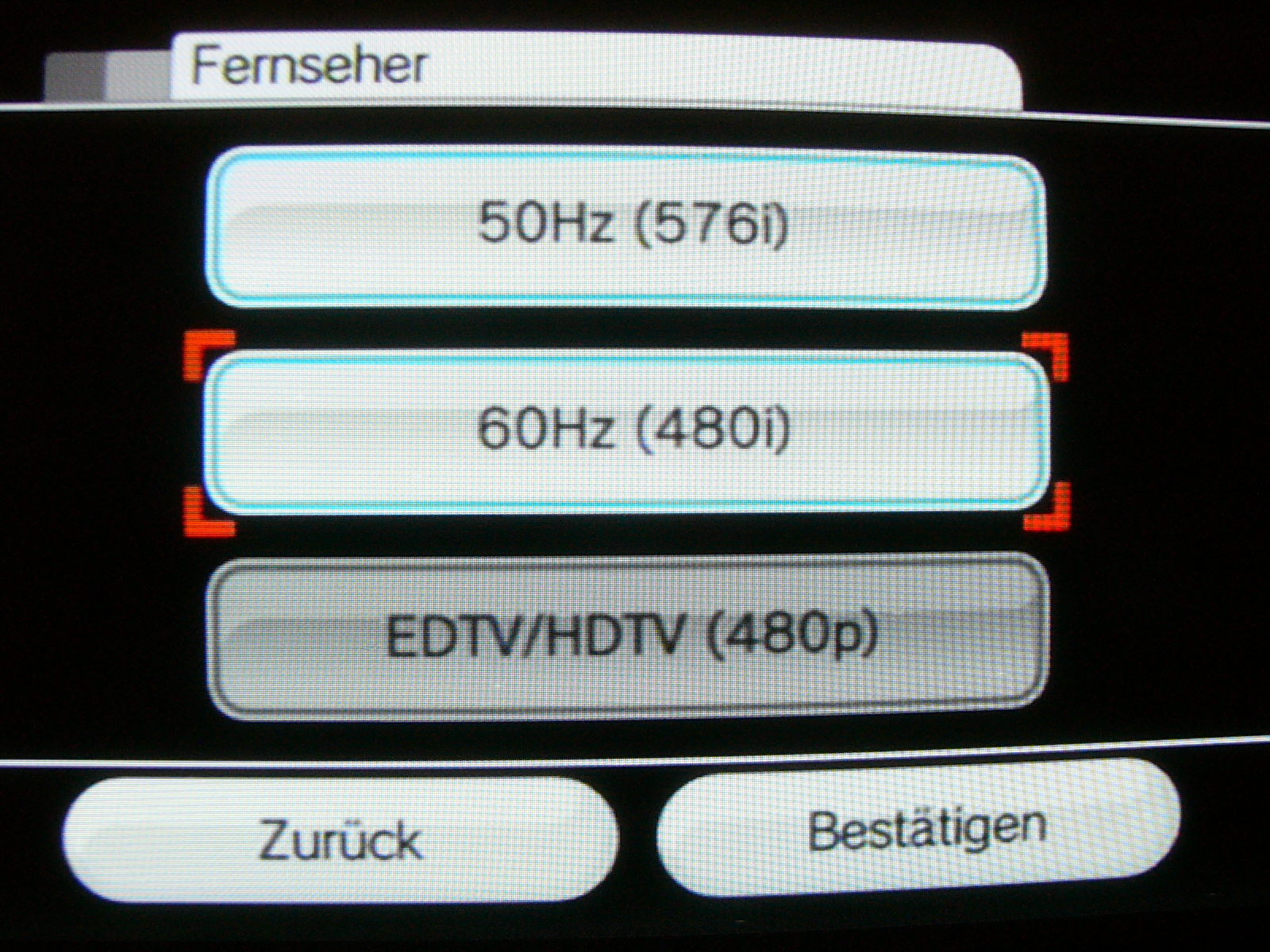

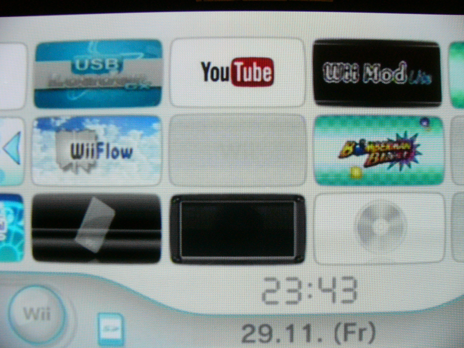

- Can you please post a Picture from your Wii´s System Menu/Video and TV Settings and from the Channel View ?
(You said you load your Wii Games through the DISC CHANNEL ?)
Thank you for your Assistance.:)
Reactions: jeannotte

- When you press the "HOME" Button on the Homebrew Channel,can you boot into BootMii ? I didn't know you could do that. I did and entered launch Boot Mii, but it won't let me navigate further. I'm pressing every button, but nothing works, so i have to restart the system.
- When you press and HOLD the RESET Button on your Wii and power it on,comes the PRIILOADER Screen (Black or White) ? No I don't think i've ever seen that exact screen.
View attachment 188292 View attachment 188293
- Can you please post a Picture from your Wii´s System Menu/Video and TV Settings and from the Channel View ? All of it looks completely normal, like a regular Wii system, like yours. I use an CRT SD TV due to LCD TVs input lag.
View attachment 188287 View attachment 188288
(You said you load your Wii Games through the DISC CHANNEL ?) I load them like regular games. either through their real discs, or if they were bought on the now defunt WiiSC

Will that make games play in best quality and make the games run appropriately too?
Hello.:)
with these Hacks you can make your Wii
- Region Free for anything - GameCube/Wii Games/Channels/Virtual Console
- set your Games to always use IOS 249 (important for the USBLoader)
- Block all Kinds of Updates
and many more.
Thank you.:)
