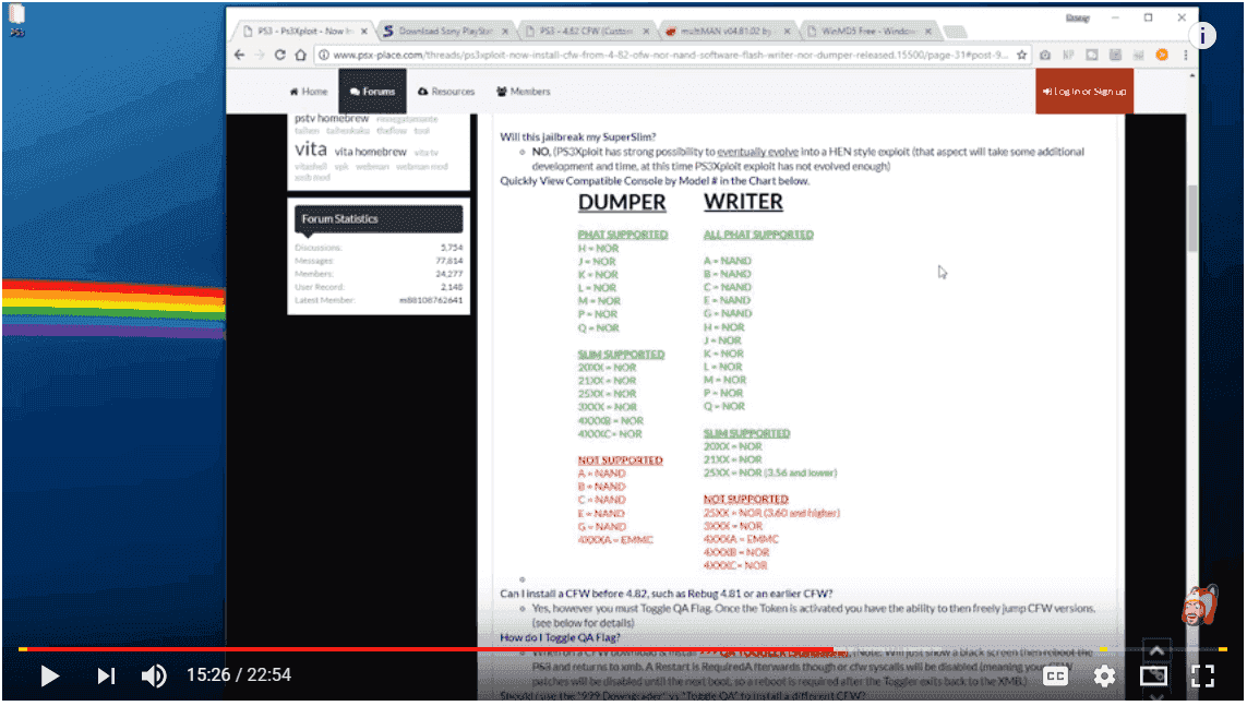

I need help modding my ps3 , don't even know if its possible tbh...
Should I be going on the discord think maybe somebody has the time to help?

Have you run minverchk?
  1. Create a folder called "PS3" on the root of your USB flash drive
  2. Create a folder within the PS3 folder called "UPDATE"
  3. Extract MinVerChk into the UPDATE folder, ensure it is named "PS3UPDAT.PUP"
  4. Plug flash drive into the right-most USB port on your PS3
  5. On the XMB, navigate to "System Update" under Settings and choose "Update via Storage Media"
  6. Run the update, and a message will appear stating "Update data of version ____ or later can be installed on this system". If this number is 3.56 or lower, your model is compatible with CFW. Consoles that report 3.56 still contain the original hardware keys for 3.55 and therefore are compatible with any CFW or OFW above 3.55.

alright, ill give it a watch. Quick question tough. Should i delete all current games i have on here or does that not matter?
If you want to upgrade the HDD, do it before the jailbreak, you can leave the game on the system, you don't need to wipe before Jailbreak. I upgraded from 40GB to 1TB before jailbreak.
i got a 500GB HDD in it already, i dont plan on overloading this thing, just the dozen physical games i own and a few emulators. mostly RPG's on the ps3 side.
will do
-edit-
damn i realised i need a windows machine to use the tools... ill have to wait till the kids asleep to use my desktop
@Hayato213 Which cfw do you recommend, this guy is using Ferox but isnt there a better one out?
