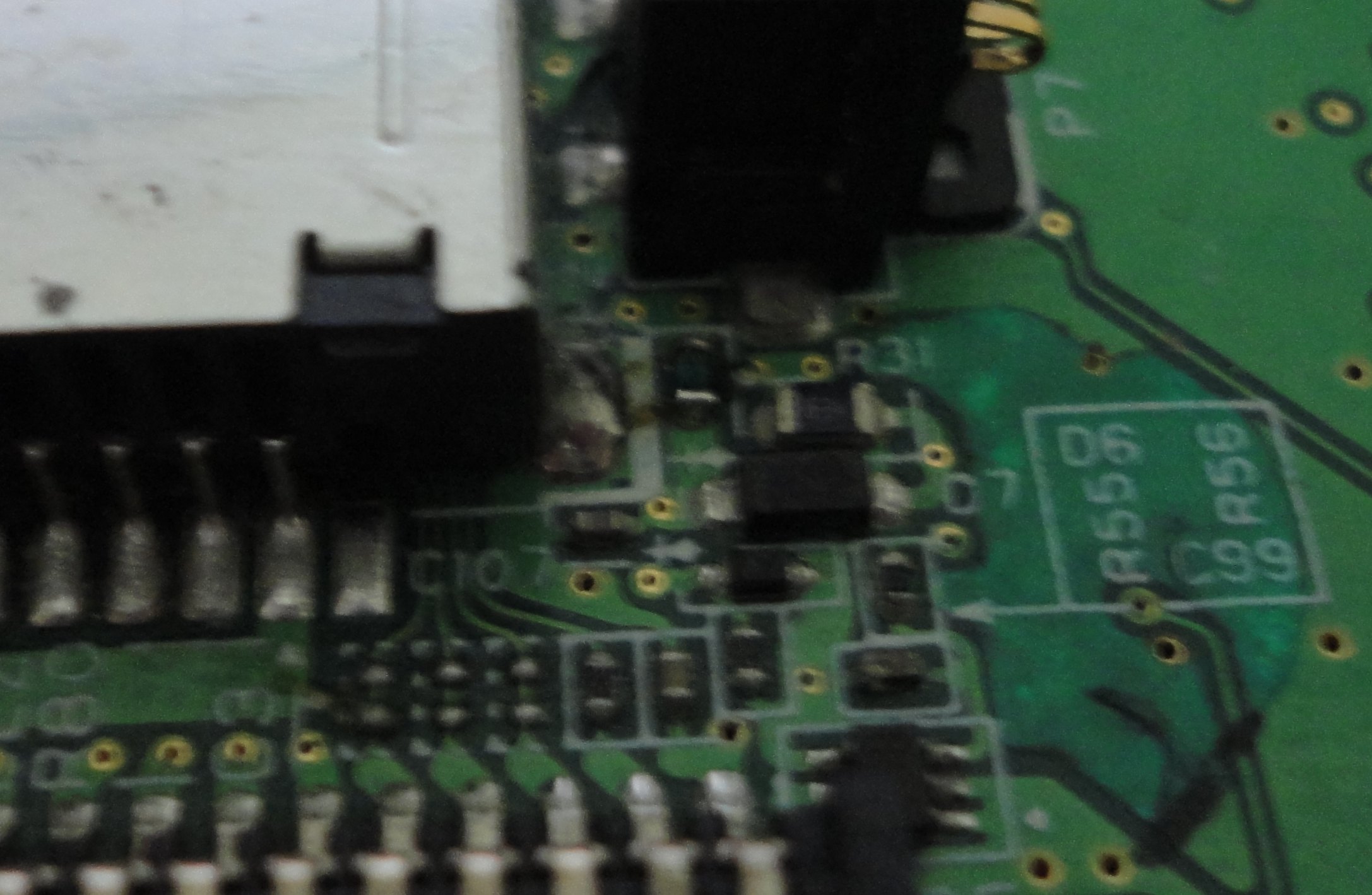

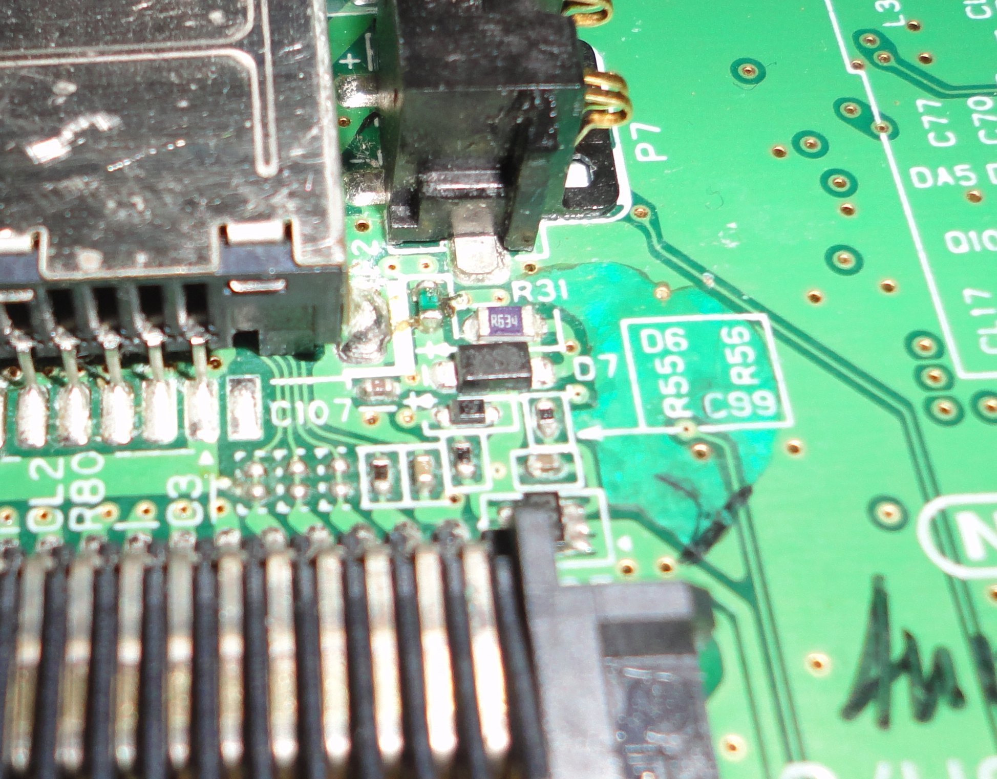

ohh could be that since he was charging it on stupid ways :p when I gave him this DS , was with an "OEM" charger, but ir broke and he someway used a mini usb with these normal wall energy -> usb charger :p I will post a photo here, could you give a look?I'm not 100% sure if this looks dead xD
here the photos...I took a time because the camera wasn't charged lol
Os this one, right?
Oh sorry, I meant the other side of the slot, where you insert cartridges.
Google F1 or F2 fuse, that's where they are.
these two? the left one is the one shown in my photos and making a comparision, this is the one that looks strange ... see the mark in different color that looks like come from it? D: well idk :v I should replace both them ?

I looked at it on my phone, on my computer I have to agree that F1 is looking like it's broken.

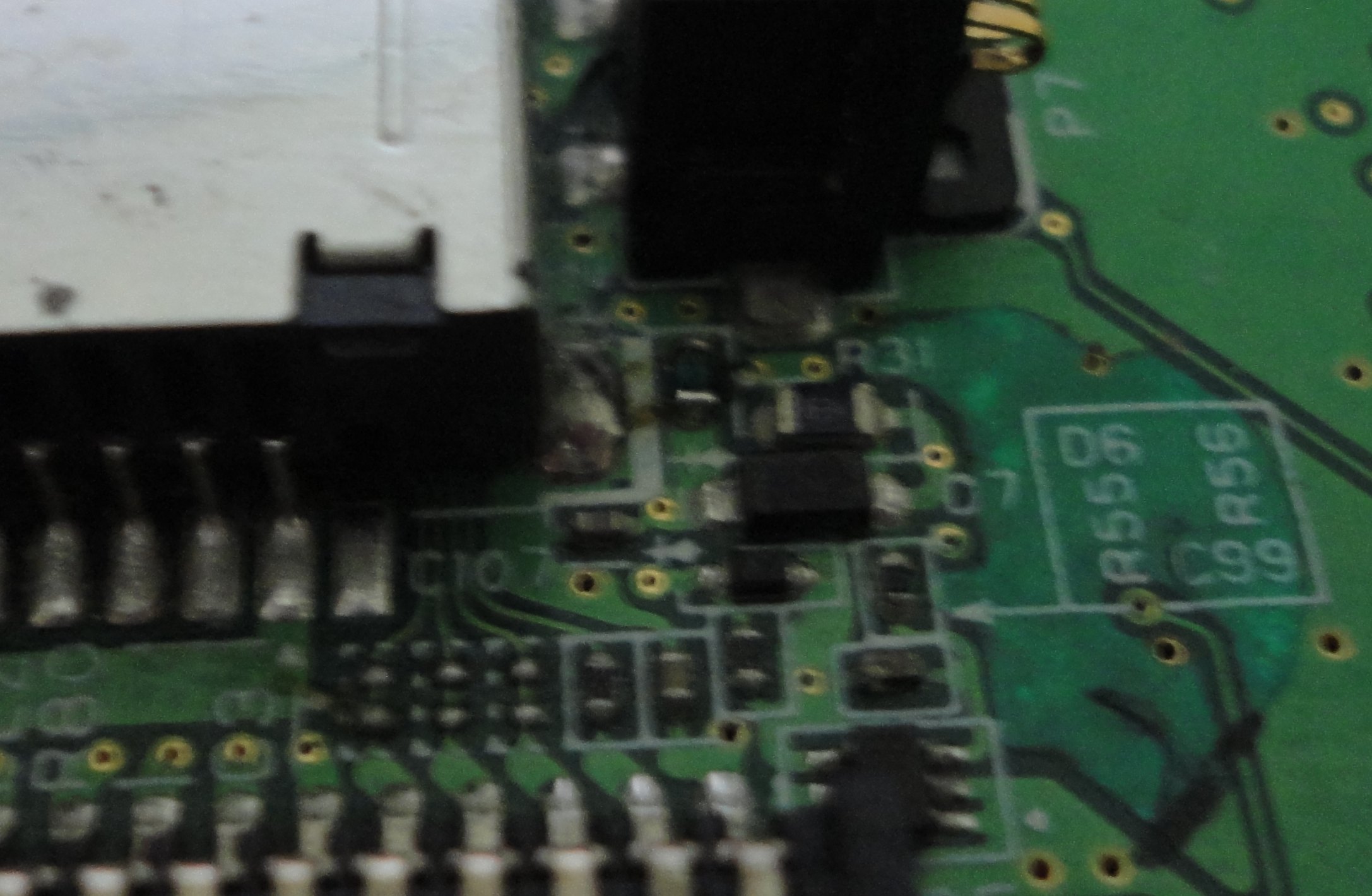

Hey guys I just got the minuscle F1 things but before tried to change them I gave another look on the board and I saw that this spot don`t really looks that come out the F1 and it`s like a "bubble ".. I think I can remove easily but I`m afraid :v
I used a multimeter to see if the F1 was really dead or not and it passed energy (tried to see as resistance) so looks alive ...so I think that spot got the problem... is something safe I could try out
Thanks everyone for helping, especially @Wuigi thanks for being right on the spot! I've got new fuses long ago but I was not confided I could change myself, and these days talking to a work's pal and he told me that he cold try, so said and made, and it's all alive again XD at least the problem don't got back until now!
