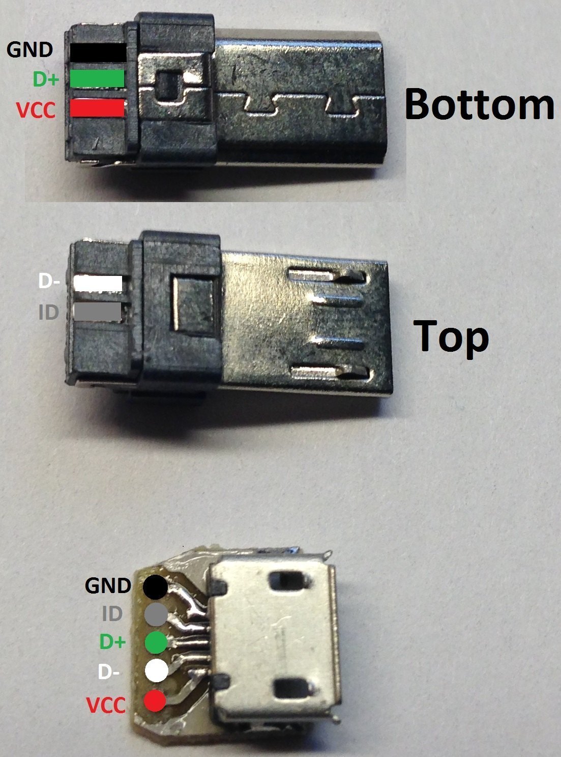

If you are going to do the microUSB there are a couple things I recommend, If you can get a microUSB male head (e.g. this) I would suggest this as you can then use the ID pin and skip the VCC pin entirely and can prevent any accidental normal USB plug in fry, maybe, I say maybe because it depends on a couple things, like the USB Data lines voltages, the distance between the Vcc and adjacent pin (arcing), and any shorting. The nice part though is you can put a little switch on the other side to disconnect those lines really easily, the CMD and CLK ones, when not in use.
This is something I use interms of a diagram but by all means not set in stone, just don't use the Vcc line unless you know what you are planning to do with it :

So in that diagram, which would be the ID pin? and I was just planning on getting a usb cable and cutting it

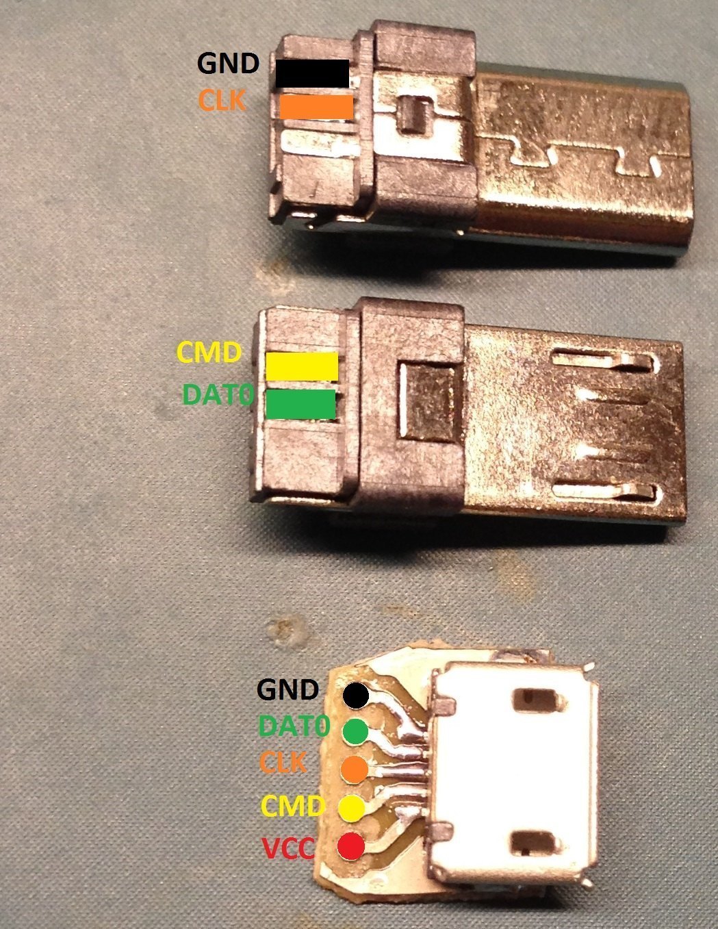

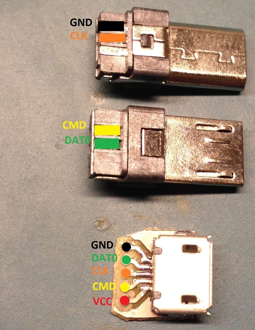

Ah yeah I was doing that before but I really really don't like using Vcc as that can fry the 3DS if someone plugs it into a normal USB connection. Here the same diagram but with the USB markings:
ah i see, so i just use the corresponding nodes, ideally ignoring VC completely, but using all the others.
So female goes into the 3ds, male gets attached separately to the micro SD adapter, correct?
Do electronic shops like Jaycar (Australian shop) sell just micro usb male and female heads?
Yes the female is in the 3DS, the male is attached to the SD card adapter externally.
