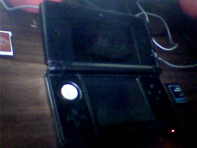

Hi! I've just ended moding my 3DS Xl, but after that strange thig happens - It just can't read SD card. I've checked my wires - there is no short, but something is wrong. Maybe I've damaged motherboard, because I tried accidently to screwdrive too big screw ang it made a hole in case, but seems that everything is OK, because there's no screw, which can make hole in motherboard :/ I can't open it now - one of the screws is damaged and I just cant get rid of it. I will try to do something tomorrow. Anyone have an idea what might happend?
EDIT: I've soldered one point really high temperature (325C?) Could that damage something. Tommorow I'll check oneof chips, because I've shorted its pins accidently, but I was sure I've repaired it...
EDIT: One more thing - when I tried to use flashcard's exploit with and without SD card instead of getting just black screen - which is normal when there's no card- I got kicked to system menu and got an error. Similiar error saying that SD card apps cannot be loaded I'm getting on system startup. Console still recognises card, but just can't read it's content :/
Is it still starting normally when you remove your sd adapter from the cardreader? (No need to desolder the wires, just pull the card and power on the 3DS)
If the 3DS doesn't start anymore, there's a chance you damaged something.
I didn't plug it into PC. It satrts normally, but when SD card is in I get an error - look at my edited post.
