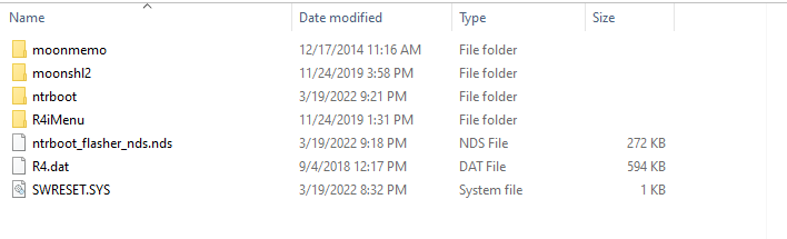

What are the contents of the microSD card in the R4?

Also here are the files
EDIT: So, I finally got it to work. I had to set the CTR no time offset back to 0. My flashcart was "timebombed" from what I researched.
