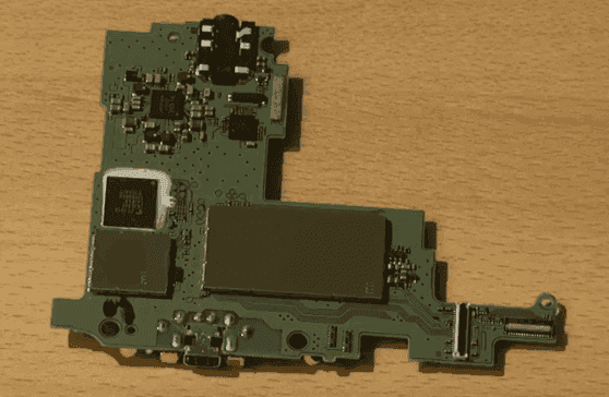

I have botched a repair on my broken new3ds. (not XL/LL) It happened while i was trying to wind a ribbon cable through the hinge. I was thinking, if I move the board in pic related AND my SDcard into another new3ds, would everything work properly? It seems a lot easier to do than trying to fix the screen again. if anyone needs more details to answer my question i can try to provide.

As long as it is the same model, in this case a new 3DS original, it is fine.
I figured the same model for sure, but i was also wondering: there aren't any region differences with the components in the new3ds are there? like the screen is the same and all, right?

I sheered the one from tbe screen while trying to get all 3 through at once. i got it a lot closer to the screen's end of the cable where it takes that 45 degree bend.
