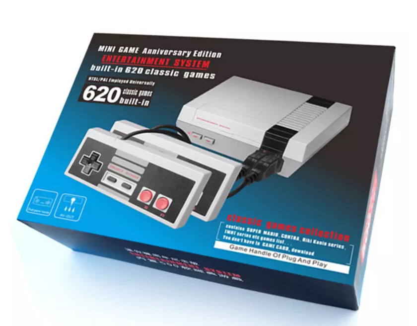

is there a way to add some new games/delete the existing ones from this NES mini Chinese clone?
  • Classic-Mini-Game-Console-Classic-Game-Player-Built-in-620-Retro-Games.jpg
Definitely not possible without a hardware modding, as mentioned before.
It's just an NES-on-a-chip with some flash memory and no external jtag port.
