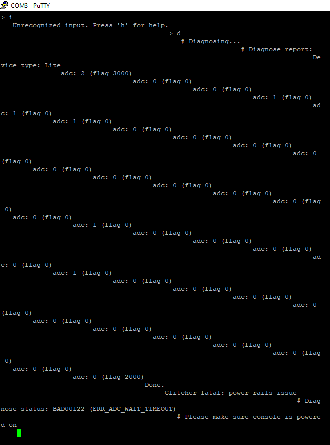

But now I think I might have another problem, when I tried to back up the eMMC, It said that it was running at a slower speed and when I check the eMMC through the console info page, It displays the following
It is possible that your points CMD and DAT0 require an additional resistor of 47 Ohm.

Okay another update on the situation:
So after unplugging and plugging everything back in the console it gave me a black screen with nothing and the same led pattern, so I just gave up and left it there. After about 30 minutes later I went back to check up on it and this time it did boot up into hekate but then I started getting the eMMC error with Init fails. I was about to give up but I decided to reset the mod chip (Instinct NX V6) as a last resort using putty and it worked! It took quite a bit to glitch into hekate with many yellow and green leds but I booted into hekate with 0 eMMC errors. I quickly backed up the eMMC and booted into CFW with 0 issues. Then I turned off the console to take out the sd card to get the backups, but when I put the sd card back I started getting the same light patterns with the black screen. I left it again to sit for like 15 minutes and then I could boot into hekate. Throughout yesterday I have been performing some testing and I just end up 3 outcomes:
1) The console doesn't even boot into hekate, regardless of the sd card (If its in or not), I get a black screen and the following light pattern: 2 x Red, 3 x Purple quickly followed by 2 x Purple with like a breathing/pulsating effect and then many (like 15-20 times) White's
2) The console does boot up into hekate but I get the eMMC running in slower mode error and it fails to init.
3) The console boots up 0 problems
I only seem to receive the 2nd and the 3rd outcomes if I let it sit for a bit (15-30mins) and it working flawlessly is a bit hit or miss.
What might be the problem here? It just gets weirder since I can get it power on sometimes but other time I can not. Oh btw resetting the chip does give me the 3rd outcome all the time.

I also went to putty again, when I diagnosed first it gave me emm clk related error (Im scared to recreate it) and now Im getting these readings when I diagnose:
> d

# Diagnose status: 900D000 6 (OK_GLITCH_SUCCESS)
# Success!
> d
# Diagnosing...
# Diagnose report:
Device type: Lite
adc: 2 (flag 3000)
adc: 0 (flag 0)
adc: 0 (flag 0)
adc: 0 (flag 0)
adc: 0 (flag 0)
adc: 0 (flag 0)
adc: 0 (flag 0)
adc: 0 (flag 0)
adc: 0 (flag 0)
adc: 0 (flag 0)
adc : 0 (flag 0)
adc: 0 (flag 0)
adc: 0 (flag 0)
adc: 0 (flag 0)
adc: 0 (flag 0)
adc: 0 ( flag 0)
adc: 0 (flag 0)
adc: 0 (flag 0)
adc: 0 (flag 0)
adc: 2 (flag 0)
adc: 0 (flag 0)
adc: 0 (flag 0)
adc: 0 (flag 0)
adc: 0 (flag 0)
adc: 0 (flag 0)
adc: 0 (flag 0)
adc : 0 (flag 0)
adc: 0 (flag 0)
adc: 0 (flag 0)
adc: 1 (flag 0)
adc: 0 (flag 0)
adc: 0 ( flag 0)
adc: 0 (flag 2000)
Done.
Glitcher fatal: power rails issue
# Diagnose status : BAD00122 (ERR_ADC_WAIT_TIMEOUT)
# Please make sure console is powered on
> d
# Di agnosing...
# Diagnose report:
Device type: Lite
adc: 1324 (flag 3000)
adc: 1320 (fl ag 1000)
