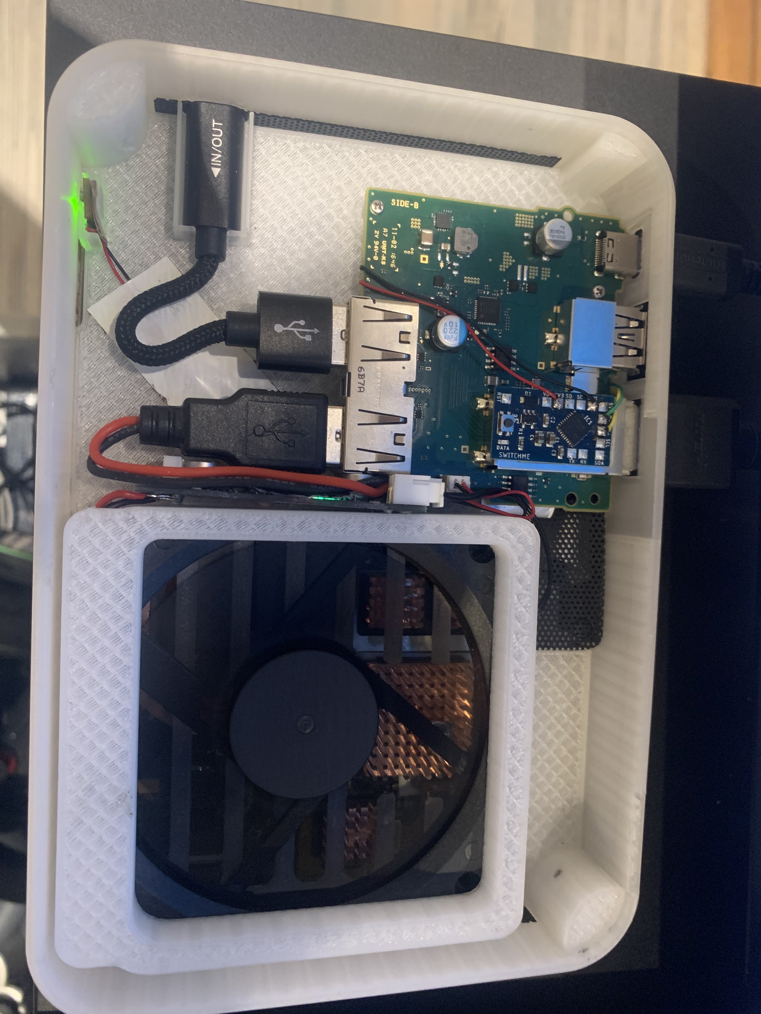

I got method 2 workin :)
Just wondering if that’s the best method because this switch is always in the dock and the rebug is turning is self on even if the switch is loaded and on…
