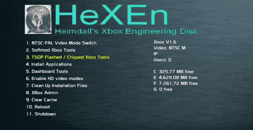

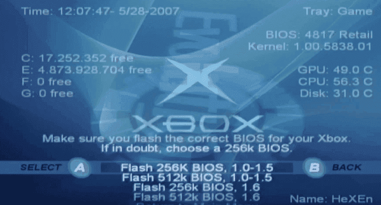

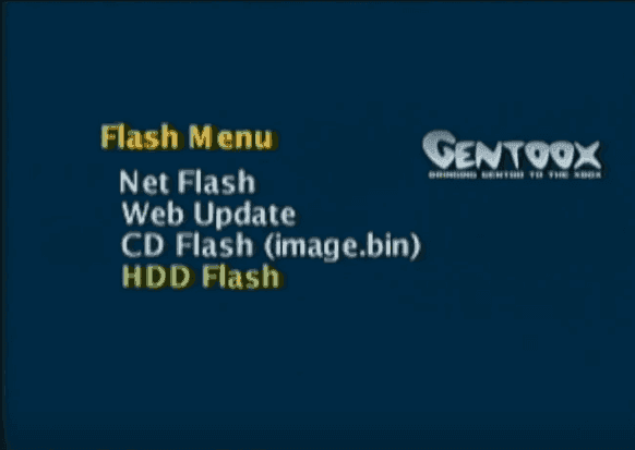

TSOP FLASH​
Firstly only XBOX's version 1.0 to 1.5 can have their TSOP flashed.
What is a TSOP? a TSOP is basically a chip that contains the bios to the XBOX, a bios is basically the chip that tells your machine what to do upon startup.
So with the small explanation behind me now, let me continue about the XBOX bios, there are different chips used for the XBOX in it's manufacturing time, SHARP/ST/Winbond/Hynix/Fujitsu, there may be more but these are the ones that are most common.
Things you will need
  • Softmod
  • A Soldering iron
  • Solder
  • Relatively good solder skills

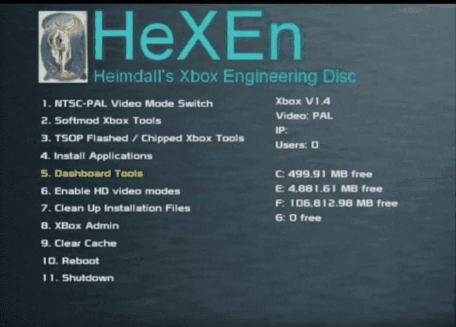

  • HeXEn Disc

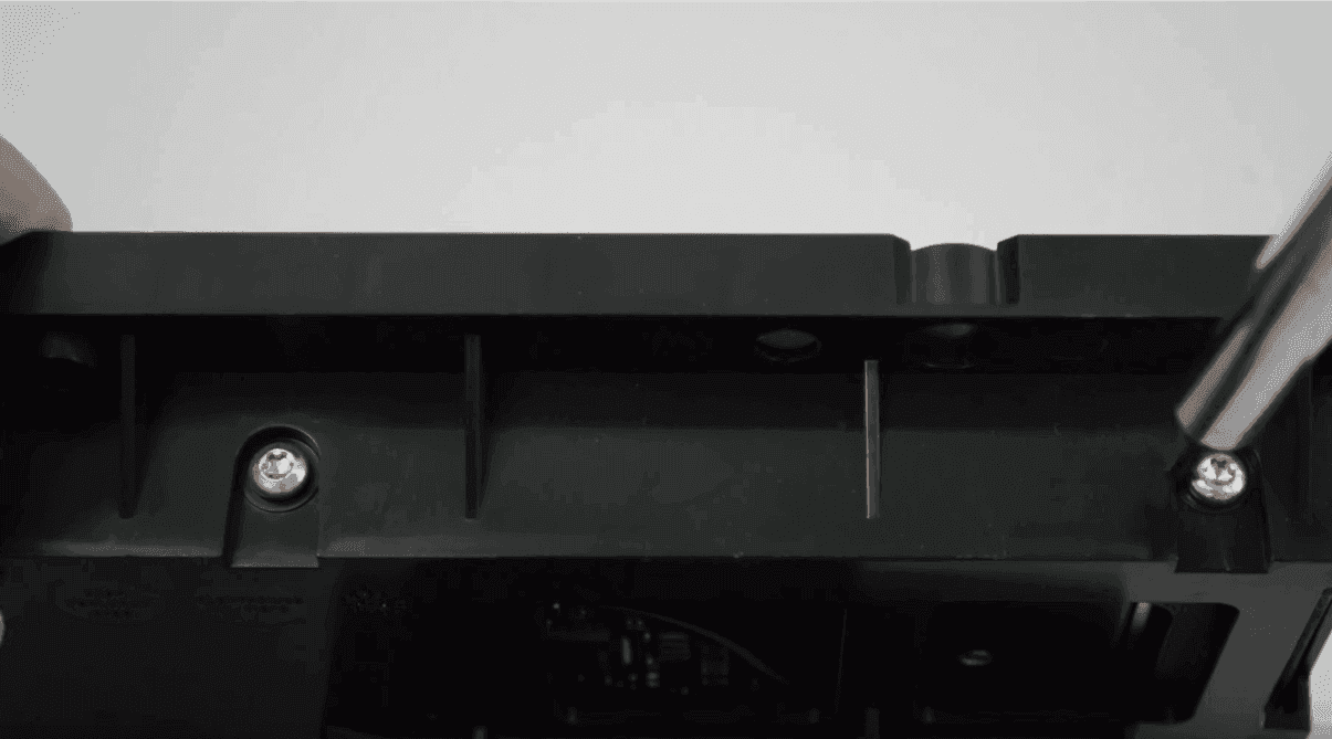

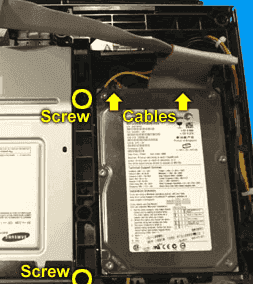

Now open your XBOX (picture down below) and take out the HDD caddy and the dvd drive (picture also down below).Now you see the the points you are going to bridge and if you have a V1.0/1.1 Revision you have to take out the Motherboard of the XBOX.Then take your soldering iron and bridge these points with some solder.(picture down below).

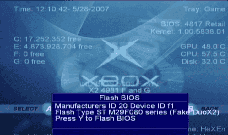

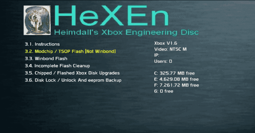

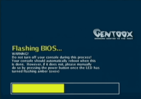

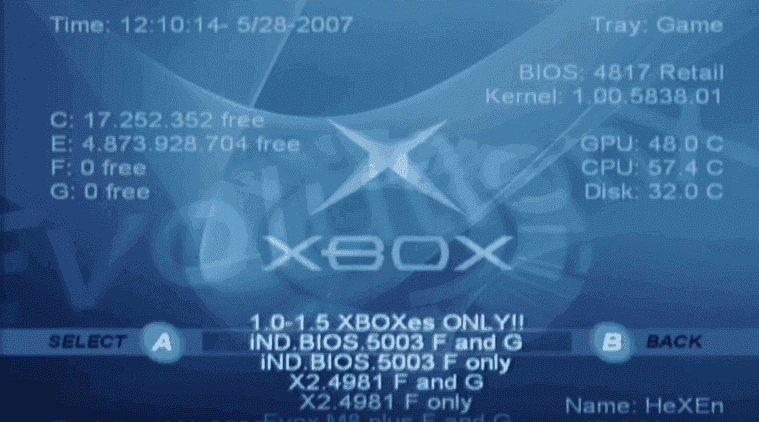

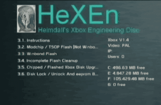

Now put your XBOX back together and put the burned HeXEn boot cd into your dvd drive of the XBOX and then scroll down to the third option (TSOP Flashed / Chipped XBOX tools) and if your console is fitted with everything BUT a winbond choose option 3.2 now just choose "Flash 256K BIOS, 1.0-1.5" and now choose the BIOS you want i recommend iND.BIOS 5004 or Evox F and G then press A on your selected bios and then Y and now your XBOX should be flashing the BIOS once it's complete the XBOX will shutdown.
If you have a winbond flash just do the same steps except go to option 3.3 "winbond flash" then choose the Bios you want i recommend iND.BIOS or Evox F and G now press a and go all the way to the left to "advanced" and then open "flash menu" and now "HDD Flash" and now just press A on "bios.bin" and the software will flash your bios.
And now your XBOX should be booting right into your dashboard you have chosen.

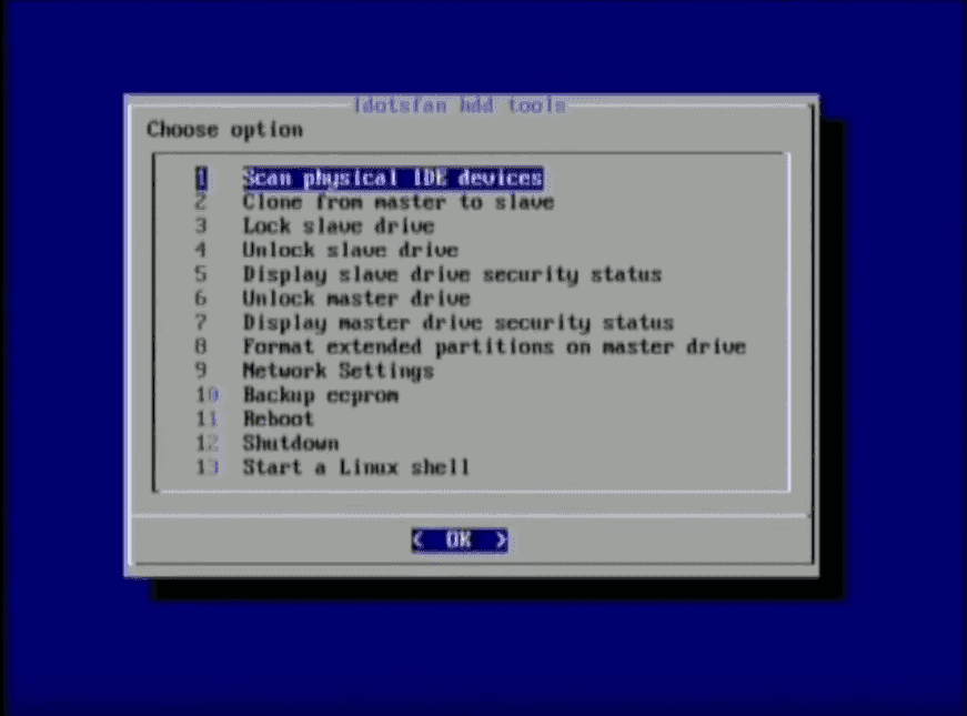

HDD upgrade ​
Things you are going to need
  • Compatible IDE/ATA HDD
  • Chimp 2618
  • Molex Y-Splitter
First burn the Chimp 2618 and then open your XBOX and connect the Molex Y-Splitter like in the picture and set the new hdd to Slave
Now make a folder on the E:/ drive called "apps" and copy the folder "Chimp 2618" from the burned disc to that folder then copy "linuxboot.cfg" to the root of the E:/ drive.Now unplug the IDE cable from the DVD drive and plug it into the new HDD and then start Chimp 2618.
Now that you are in Chimp 2618 select the option 2 and then select option 1 "full-disk(byte by byte)" now just use the preselected settings and then i should look like in the picture down below.Now goto option "3.Lock slave drive" and select "from motherboard" and if it says " HDD lock capable: No" you are out of luck but if it says yes just click yes.Now you can power off the XBOX and unplug the old hdd and remove the HDD caddy.Now remove the old Hdd from the caddy it's hold in place by 4 screws and then put the new HDD in the caddy and be sure you have set it to Master or Cable select.Finally put the Hdd caddy back in and connect all the cables (Molex & IDE). (Xbpartitioner part coming soon.)
Things you are going to need:

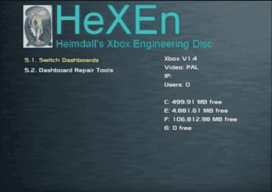

First open the XBOX then remove the old Hdd from the caddy it's hold in place by 4 screws and then put the new HDD in the caddy and be sure you have set it to Master or Cable select.Finally put the Hdd caddy back in and connect all the cables (Molex & IDE).

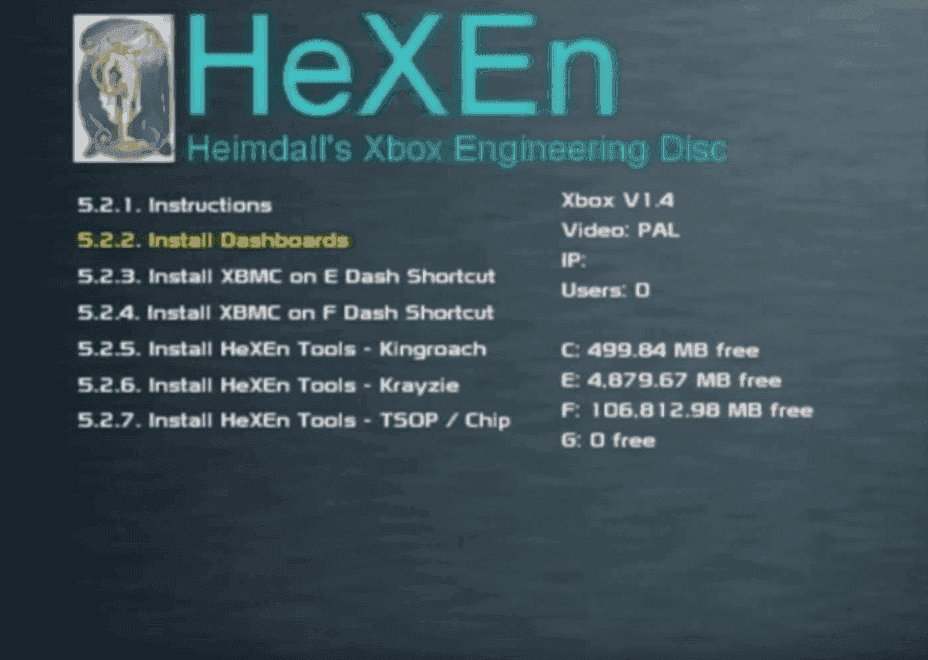

Now insert your HeXEn disc and goto "5. Dashboard Tools" and click on "Switch Dashboards" and then "Install Dashboards".Now goto the Main menu and click "7.Clean up installation files" now reboot your XBOX and you are done.

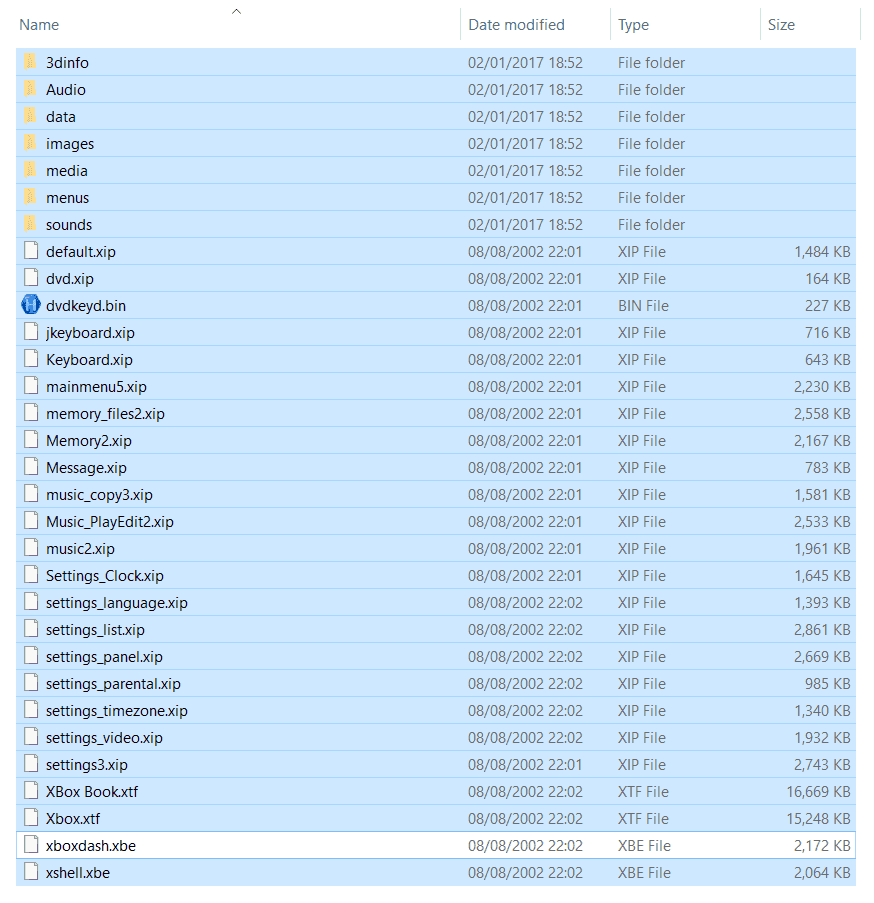

When you've sourced all of your files, go ahead and extract the contents of the XDK Debug Dash using WinRAR/7-Zip/Whatever. Afterwards, connect an ethernet cable from your PC to your Xbox; we're now going to transfer those dashboard files, plus the files for the E: drive.
In Windows Explorer, highlight all of the files and folders in the extracted "C/" folder, but be sure to deselect the xboxdash.xbe file, as you do not want to replace the softmod-dependent xboxdash already on your Xbox.
So, using your preferred FTP client, transfer the highlighted files to the root of your Xbox's C: drive, overwriting any existing files (making sure, of course, xboxdash.xbe isn't overwritten!). After you have done that, do the same thing again, but this time select and transfer all files in the extracted "E/" folder to the E: drive.
Now you need to go back to the extracted "C\" folder again; we will rename the xboxdash.xbe file we did not copy to the Xbox. Rename it to xb1xdash.xbe if you are using UnleashX, however the MS Dash executable may be under a different name if you use a different dashboard, so be sure to rename it to whatever your preferred dashboard renames the MS Dash XBE to.
Now you can copy and replace that XBE file in the location of the MS Dash XBE (It's usually in the root of the C: drive).

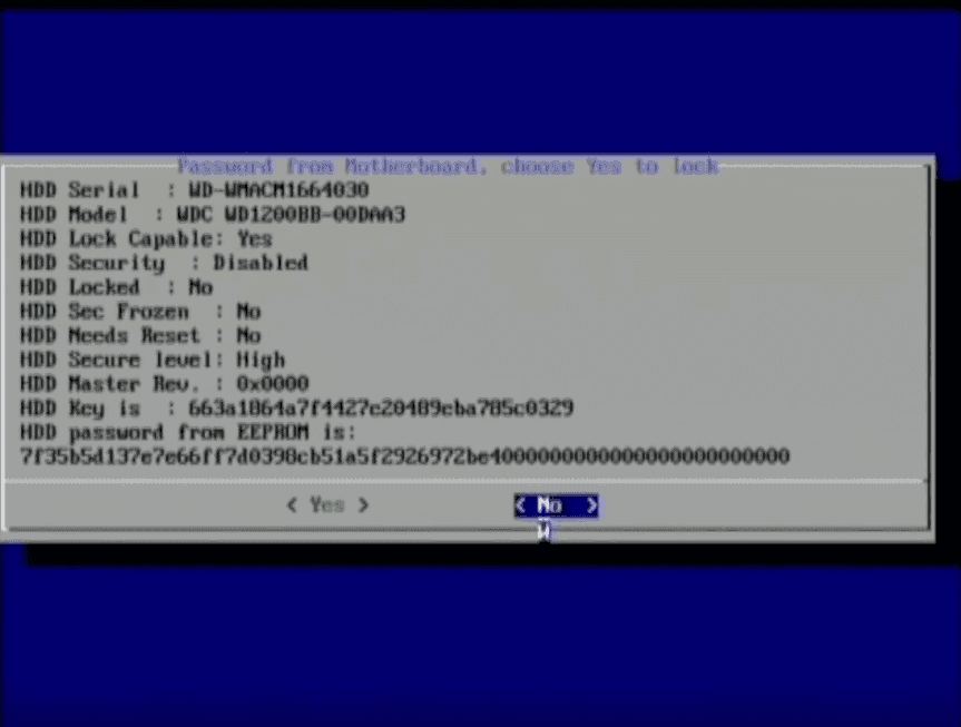

Hi @All - i'm at it again with another hack
I softmodded my old xbox with the "softmod tool kit" by Rocky5. Also Backuped my EEPROM to PC. Now i'm going to be replace the stock HDD with a 240gb SSD. (i know SSD's are not really recomended for xbox - but i got it for free so..)
The next step will be to TSOP it.
Question 1:
I have a SSD & IDE/SATA Addapter & TSOP - how do i set it to this "Master or Cable" - or do i need it at all ?
Question 2:
After the SSD is builed in and everything is connected - according to this guide here, all i have to do now is to launch the xbox, insert "HeXEn" and follow the steps and everything is done? Is it really that easy...?!?
Question 3:
I have like 170 GB of og xbox games - can i put all those inside "F:" ?

Question 1:
Your IDE/SATA Adapter may have a jumper setting for it. Chances are by default it either came with Cable Select or Master, so you probably don't need to worry about it.
Question 2:
If you've done a TSOP flash, yes, it should be that easy. After the TSOP flash you shouldn't need to worry about drive locking anymore, and the Xbox should launch HeXen without a problem. Hexen includes everything needed to set up a new drive, so you should be set. Theoretically, there won't be a point to having an eeprom backup either.
Question 3:
C: (never touch this directory)
E: apps, emulators, homebrews, saves, screenshots, backup (EEPROM)
F: "Name of the Game" etc...
Yes, they can all go in F:, no problem.
