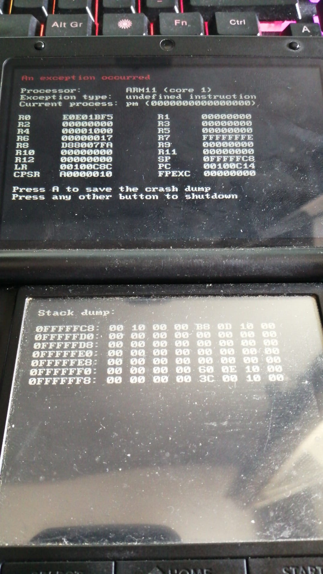

btw, I did all the things you said, copied the files in a new SD card, but now I got this when I turn on the 3DS
That is an extremely common error. It means that your 3DS is not reading the new SD card for some reason and is instead trying to use an older copy of Luma that was copied to your CTRNAND. You will need to update that copy as per https://3ds.guide/restoring-updating-cfw . (Did you use https://3ds.guide when you hacked this unit?)
But first, you will need to get your 3DS to read your new SD card. Did you format it correctly and test it with h2testw?

When I opened it, I tested it with h2testw, but maybe I did something wrong(?) I tried again and I got an error on h44.
You still haven't answered the question: did you format the card correctly? How big is the card, and what did you use to format it? You also didn't answer the other question.
I'm not sure what you mean by "an error on h44", but if h2testw says your card isn't working, then it's probably not a good idea to use it.
Ok so, the SD card is 64gb, and I used SD Card formatter, guiformat and mini tool partition wizard. I tried again with h2testw, and I think everything is ok. I hacked the 3DS many years ago, so I don't remember, but I certainly used a youtube video guide. Also, when I finished with h2testw, I found many .h2 files numbered.
You tested the new sd card, right? If the h2testw said it's good then it is, i hope you used the write & read option though.
Anyway, those .h2 were created by h2testw to accurately check the capacity of your sdcard, it's fine you can reformat it again as Fat32 32KB cluster size and the Luma file on the root of the sdcard, and other data you had from the previous sd card. Then put it back, it'll show the Luma3DS menu, click on "show nand string.." and press "start".
