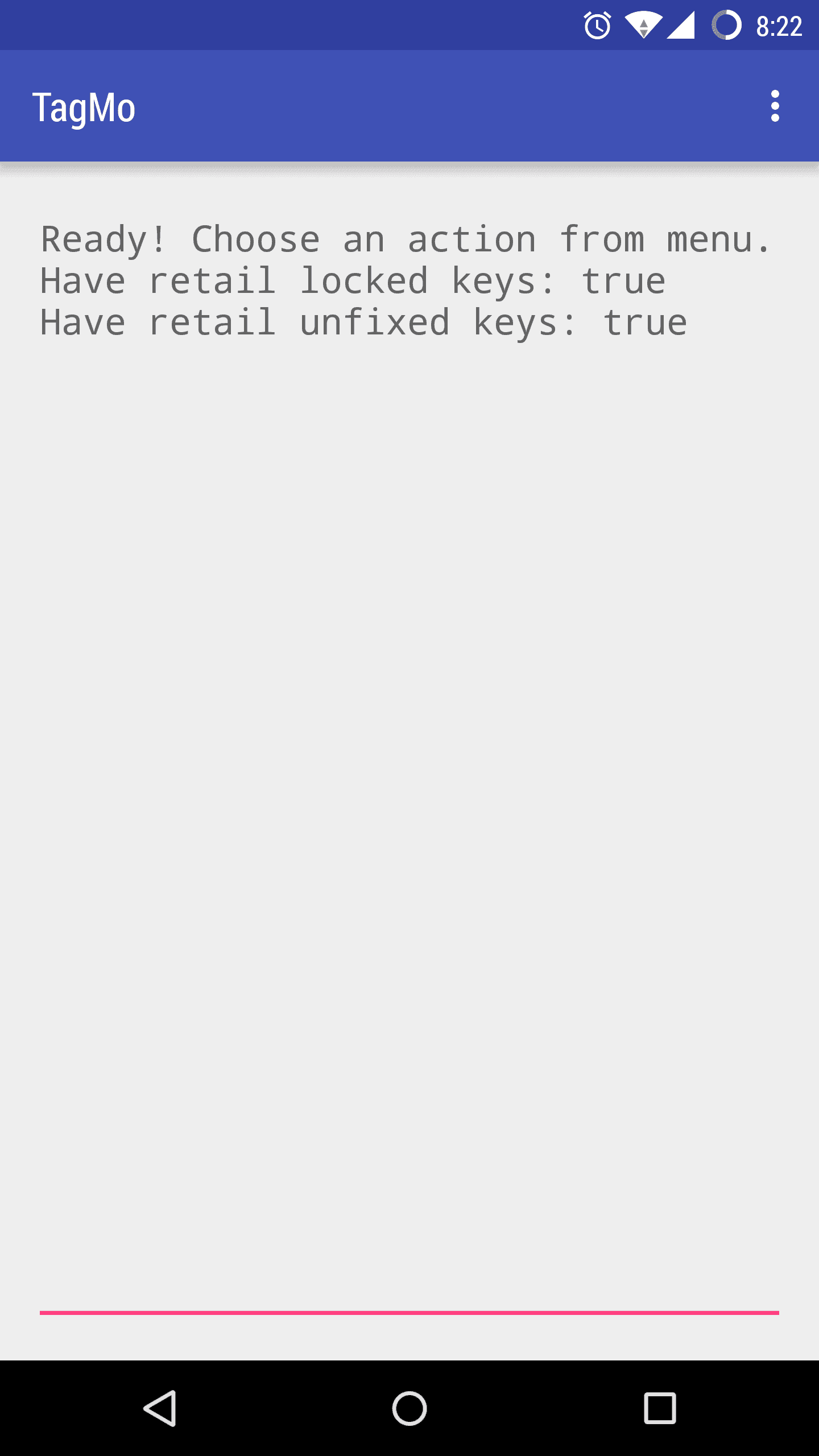

I've decided to make a nice tutorial for creating Amiibo NTAG215s.
Thanks to @HiddenRambler updating TagMo to use the keys and amiitool inside of it, this is really simple now. You simply need the amiibo key (Google for it, you'll find it on pastebin ;) ), split it in half, and TagMo 2, then load up the 2 keys, then the BIN files.

Save this, then use JaviMaD's amiitool to encrypt, with the command './amiitool -k KEYS.bin -e -i filename.bin -o filename-enc.bin', where KEYS.bin is the unfixed info then locked secrets joined together (SHA1: bbdbb49a917d14f7a997d327ba40d40c39e606ce) and filename.bin is the decrypted hex file we just made. Once encrypted, copy over to your phone, turn on NFC and start TagMo. Once this is done, use the action menu and select 'Load tag from file', select the file, then 'Write tag' and place the tag near the NFC adapter in your phone (don't move it until it says done!!!). Once done, you now have an amiibo!
