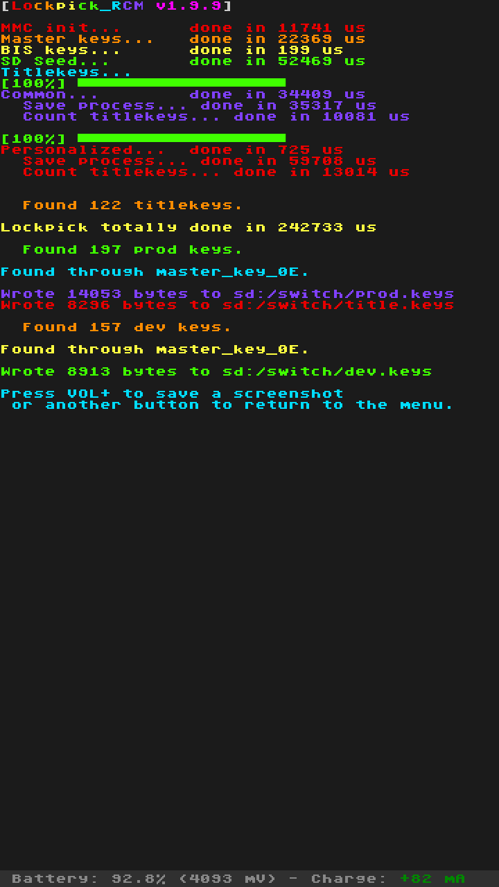

Hello! I have an Erista with 16.0.0 HOS and 1.5.1 Atmosphere, no emuNAND, only sysNAND usage. LockpickRCM 1.9.10 finds 0 title keys, and I have not enough knowledge is it okay, or is it a sign of some issue. I've dumped keys with previous HOS and LockpickRCM versions, and title.keys from them have a lot of records.
