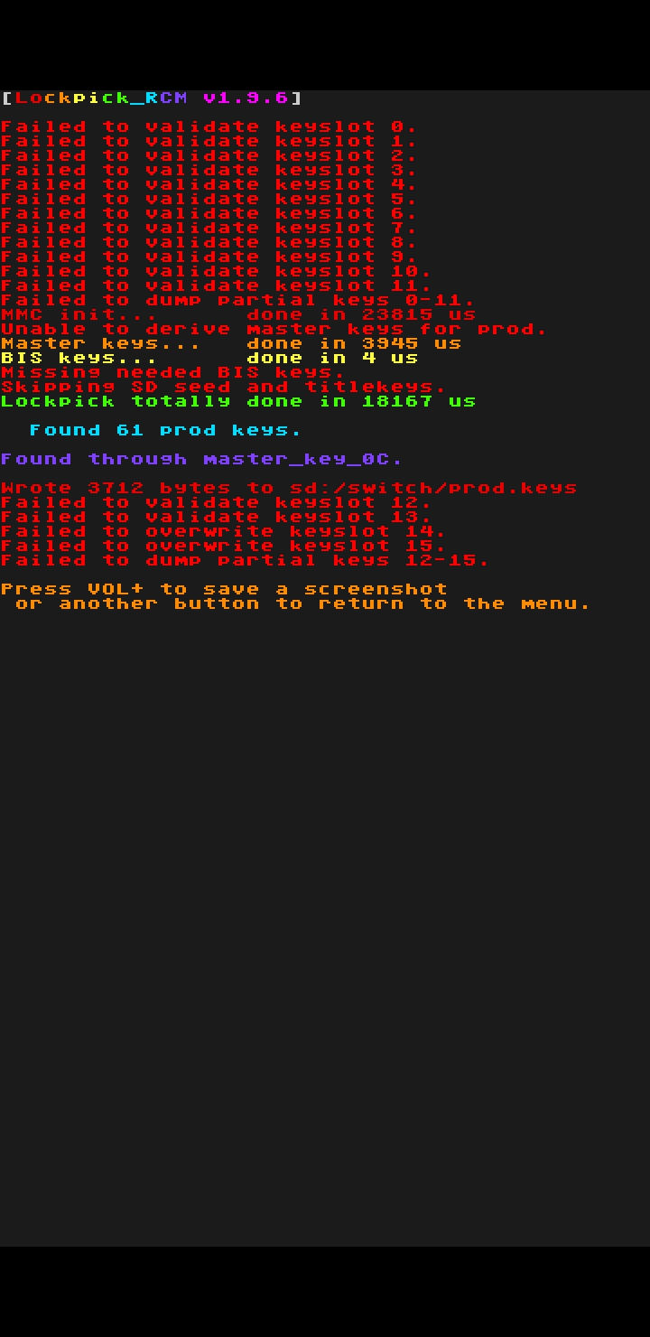

dumping key from sysnand resulting with this. any idea?
sx core mariko. boot with hekate through sx gear. then launch payload via launch menu.
As far i remember from the TX days, there was some talk about that rcm version of Lockpick wasen't compatible with the Mariko Switch, and ppl was adviced to use Lockpick.nro
you should get the following files as result
Partitalkeys.txt
prod
titlekeys.txt
The errors you see are markio specific are due to the nand being encrypted. But unless you're a dev you don't need this data, but you're still getting your masterkeys in prod.
