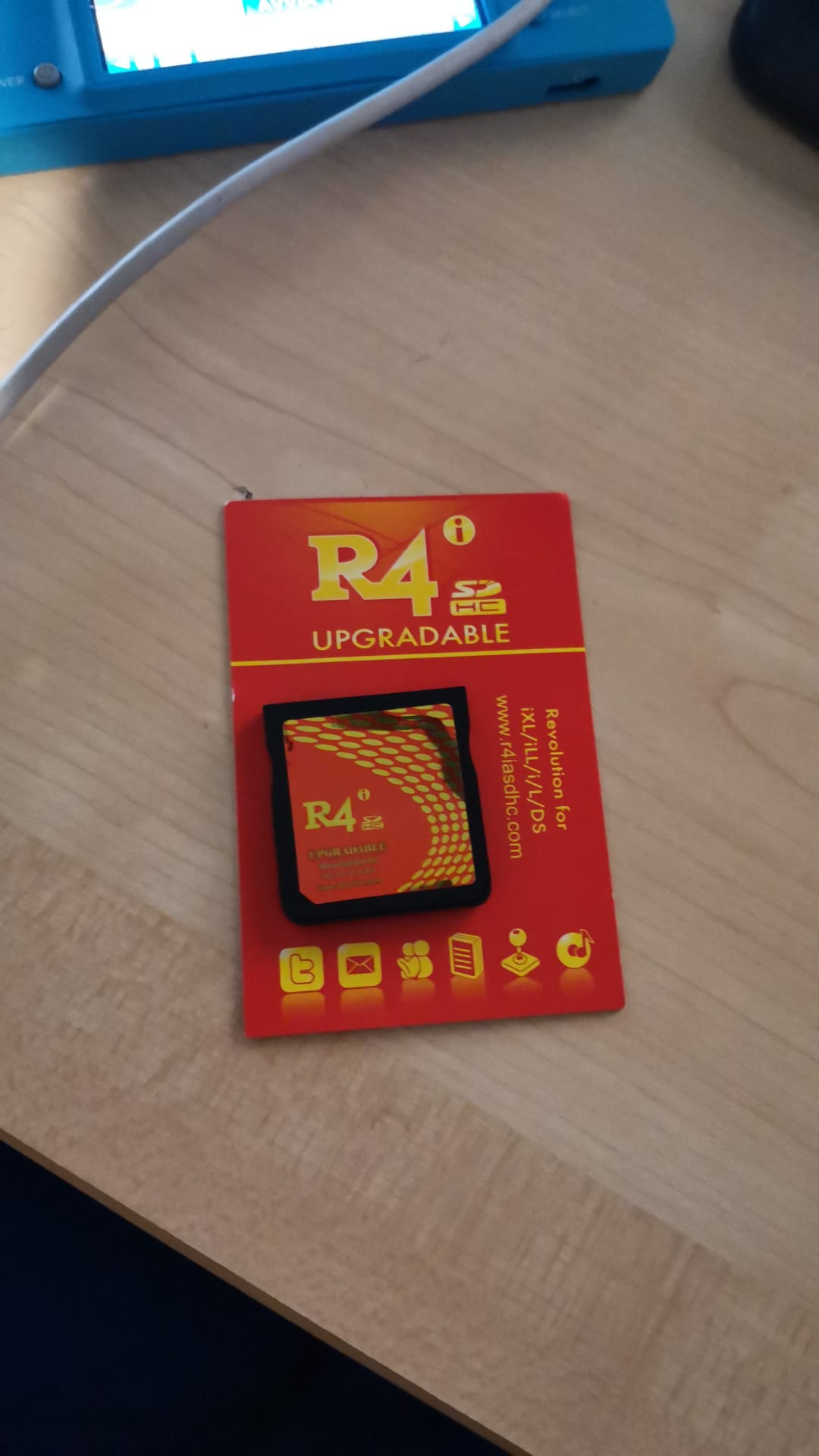

I am searching the kernel for my R4i SDHC upgradable (photo in attachments).

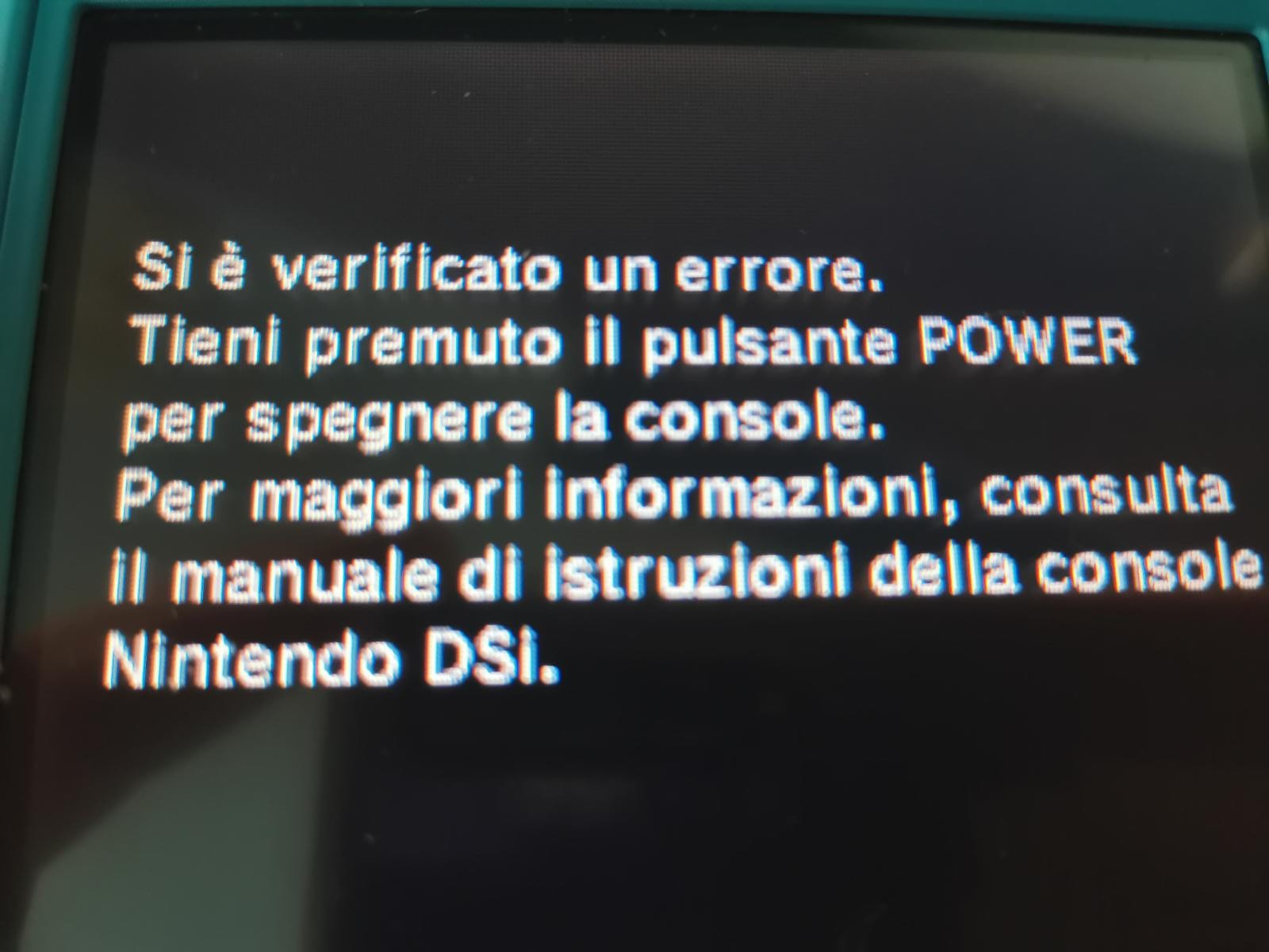

The man who sold me that gave me a link to download it and YSMenu but it does not work and the DSi (v.1.4.1 E) shows me the black screen "An error occurred...".

Which link gave you the man to which site?
If a error occure like this, the Card is blacklisted by Nintendo and needs normal a firmware upgrade to be compatible with higher console firmware. As alternative you will need to install a CFW/unlaunch on the DSi which will overrun this blacklist checks.
There is a Kernel for your Card in the YS-Menu folder of the Flashcard archive. Or here on TheTechGame (you need to register before). Else there could be a Kernel from a "R4i Gold 3DS" Card that might work. As Alternative i recommend to install TWLmenu++ for flashcards and using with nds_bootstrap instead, if you dont have a kernel.
