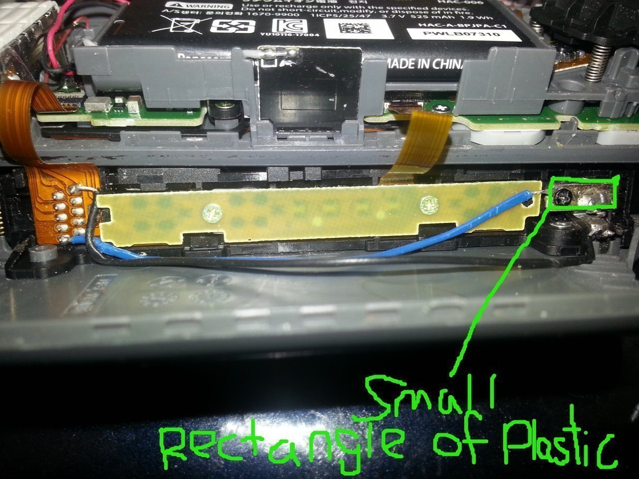

I've been waiting for the perfect joycon mod and this looks like it may be it. Regarding the metal buckle locks, it looks as though the metal is in constant contact w/ the metal plate that bridges the wires. Is it not what it seems?
I cut out a small, thin, rectangle of plastic, and lined it up with the bottom of the metal bracket that holds the buckle down, and punched a hole through the small piece of rectangular plastic for the screw to go through.
